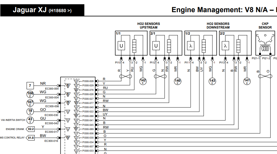

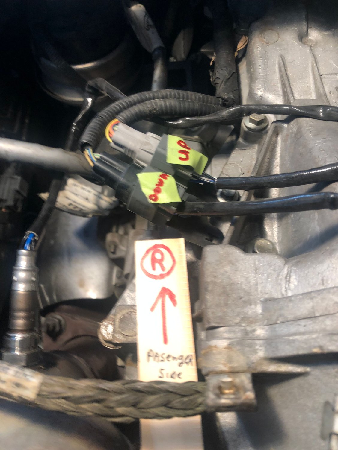

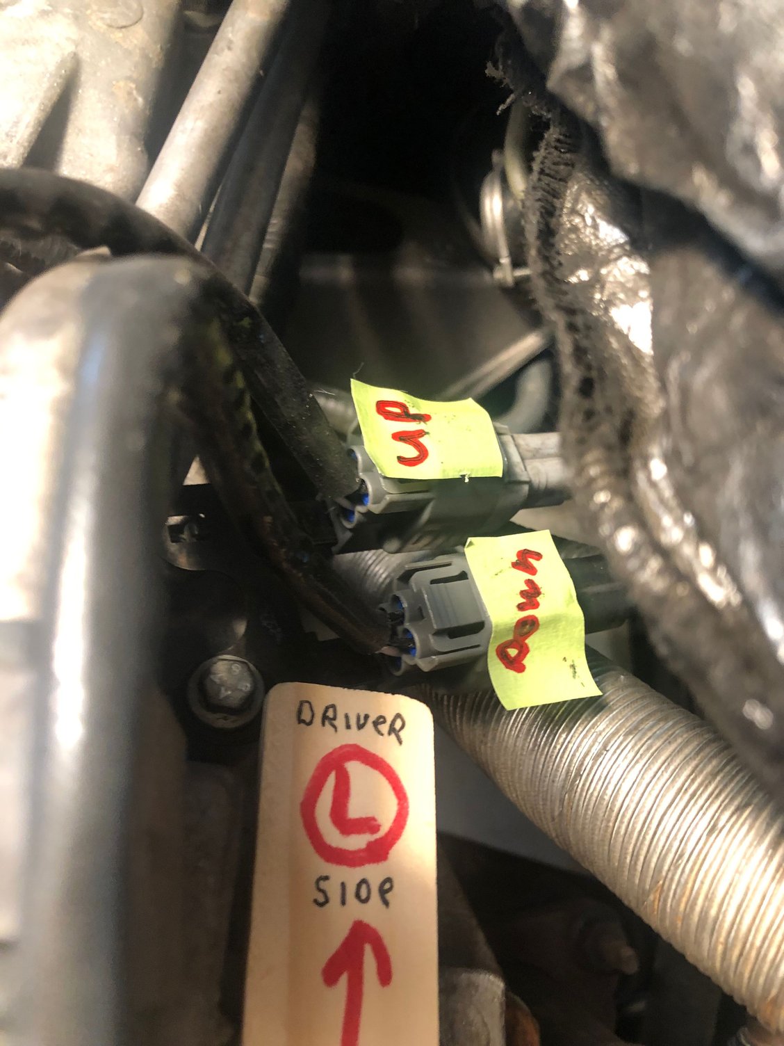

Can anyone confirm If I have the O2's plug into the correct plugs
the up-stream O2 is plug into the oem receptacle that is most forward
The down steam O2 is plug into the port that is closest to the rear of the car
This is the same for both R&L banks
I should have taken a picture of the original units before I removed them but didn't
Old Apr 23, 2026 | 04:05 PM
RoverJoe's Avatar
Community Influencer
Joined: Oct 2025
Posts: 511
Likes: 191
From: South Florida
Looks right on the one side, I can see the Bank 1/1 sensor has the white with green, yellow wires and it is on the correct one, assuming the grey connectors are both upstream your other side should be good too, but you could always double check the wire colors.

The down streams are on the black plugs
The up steams are on the Grey plugs
