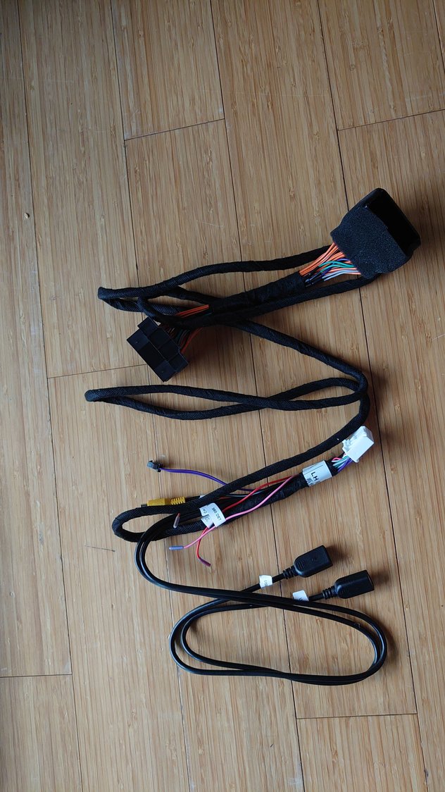

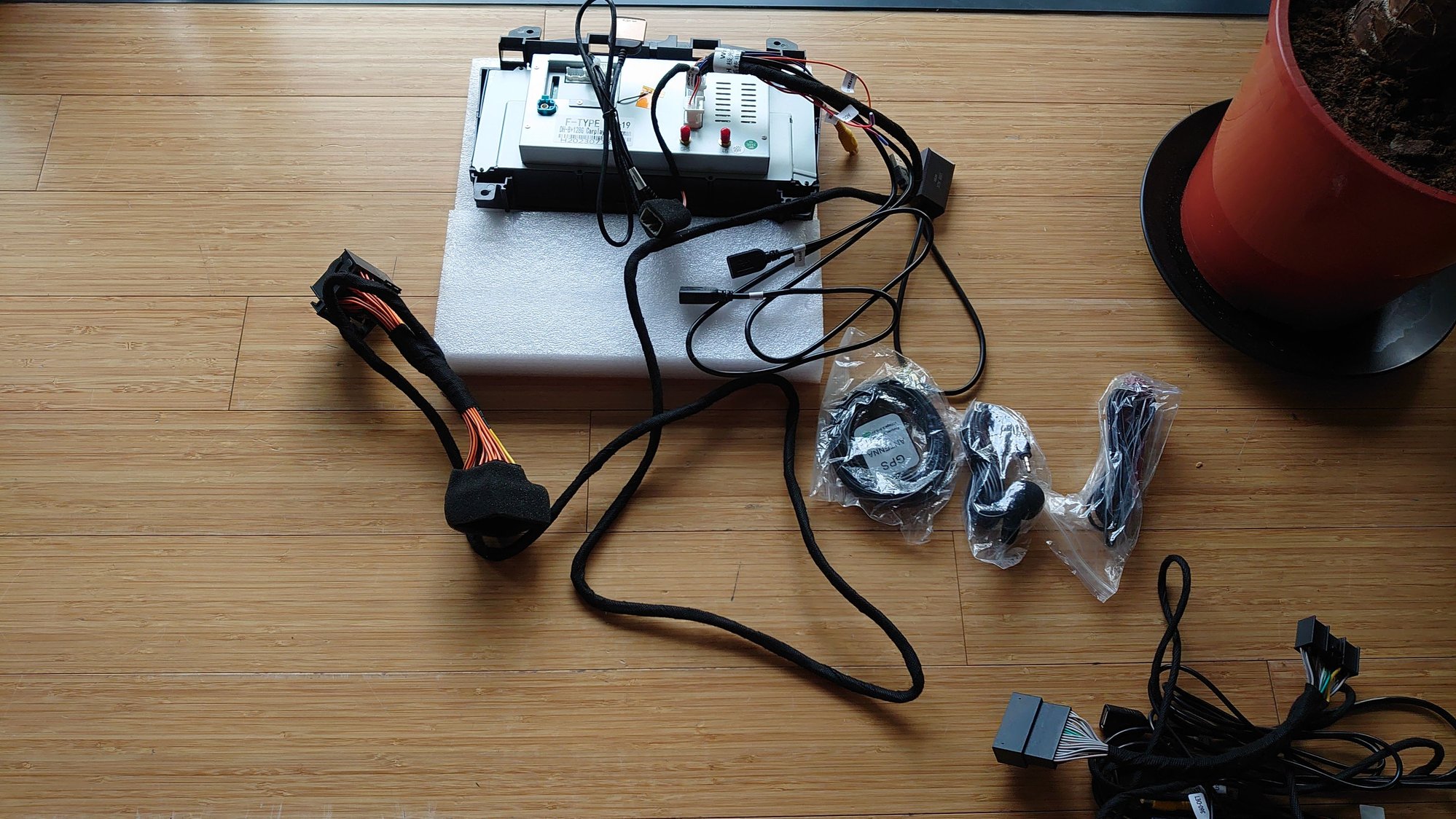

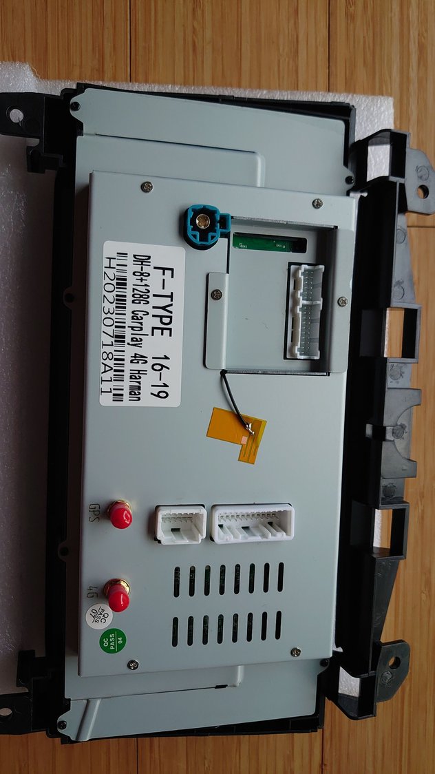

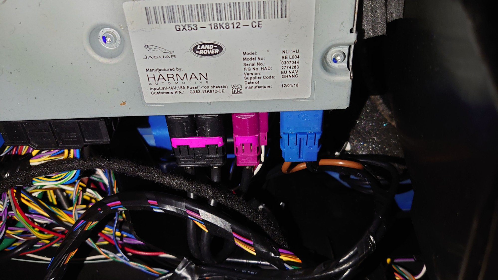

Hi guys,
Here are some pictures of the unit.

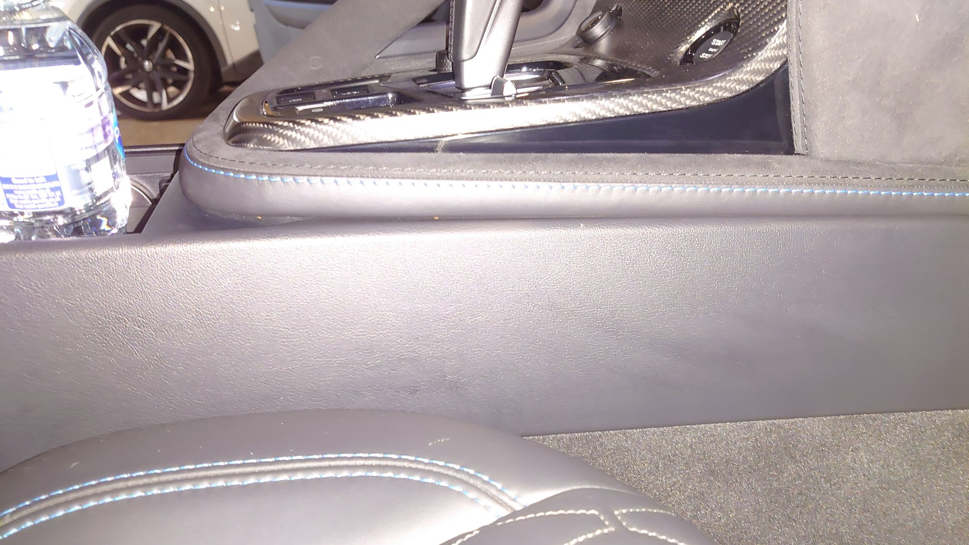

Hi guys,
What's the technique for removing the center console side panel trims?
I've tried with a panel removal trim.
It seems pretty stiff and I don't want to damage anything.
Is there a downloadable guide or anything?

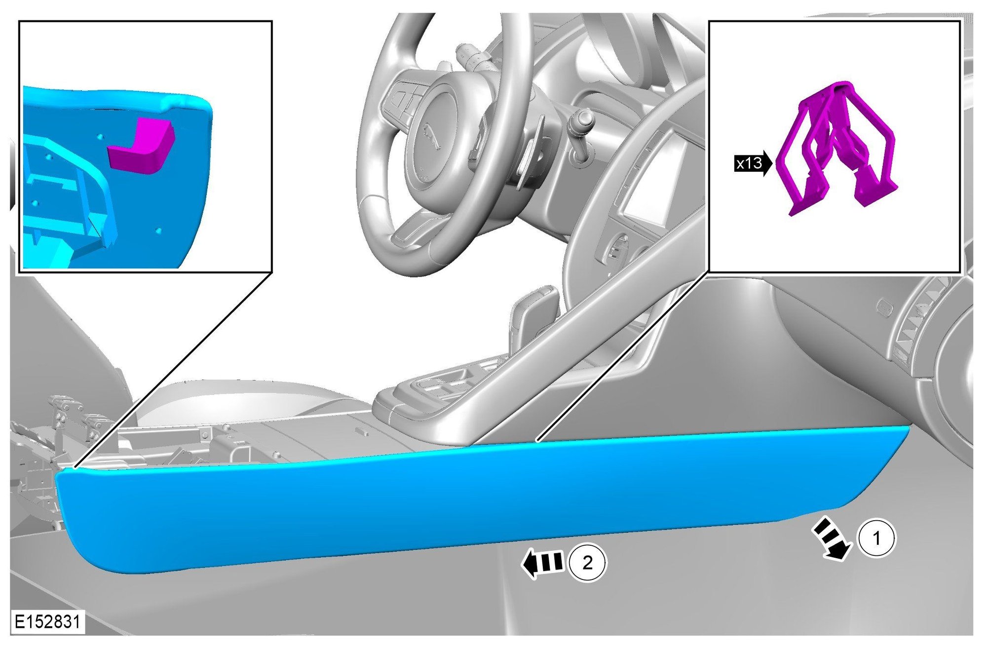

From: Edmonton
It's clips - I recall them being firm...
Old Aug 2, 2023 | 09:25 AM
  #377
kellysh2000's Avatar
Joined: Apr 2016
Posts: 18
From: Edmonton
Si, it spop out the front clip, slide the rest towards the back,,,,

Hi
Sorry I still don't really get it?
