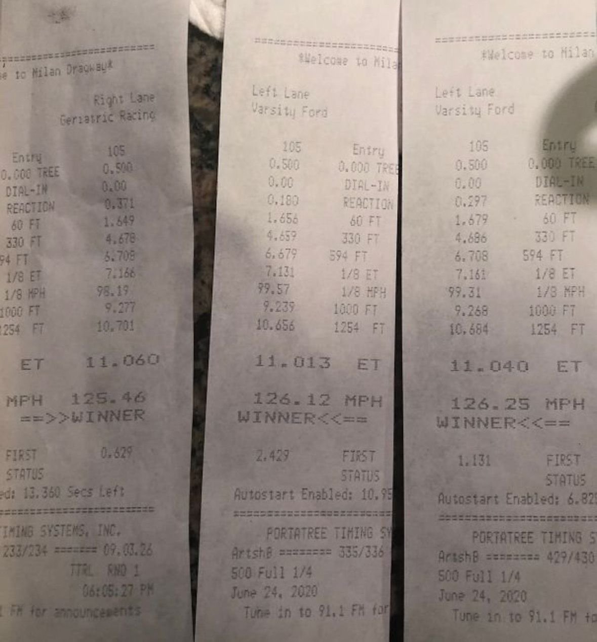

Ran back to back to back runs and then went home. I’m car 37. Here are the slips:
Seems to me this is what the car should run stock… am I wrong?

Fuel quality / octane has been brought up with an acquaintance of mine who has a modified R as well. Arizona has horrible fuel quality, so an octane booster, running a gallon of E85 in a tank, or methanol injection has been discussed. Poor fuel will pull timing, so maybe I’ll have to consider looking into it more seriously.
Cograts, you have very consistent times what times and trap speeds were you expecting?
I have read these cars are definitely knock limited when tuned. You also have the full metal Mina intake - if it gets heat soaked you can lose power and trigger knock.
Do some logging on your next runs and see if anything unusual is happening - knock, timing pull, ignition miss, fueling issues.
Thanks. I was expecting 11.1 and really hoping for a 10.999

Your 60-foot times look good. What was your launch technique? Did you launch from idle? I have seen my best results by launching at about 2000 rpm. That seems to load up the driveline and build a little boost before launch.
Your ET and Trap Speed seem off for your mods. What was the elevation or Density Altitude when you ran? The Temp and Humidity seem reasonable, but if you were at elevation (physically or due to barometric pressure), that will rob horsepower.
As previously mentioned, doing some logging would be wise to see if any timing is being pulled.

Certainly understandable to be underwhelmed. You’ve got the parts needed to run ~11.0 but your MPH came up short, so I assume you’re making less power than you should. How was the DA that day?
I would be interested to see how you did on race gas. These are my times on 93, with just a lower pulley, 1 step colder plugs and a VAP tune.

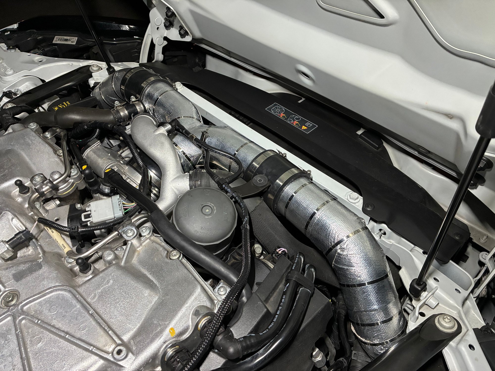

I bought some adhesive heat reflective material off of Amazon and wrapped the parts of the intake that were metal using metal zip ties. Took the car for a spirited drive last night (high 50’s, low 60’s temps). The intake tubes were actually cool to the touch. Supercharger lid was noticeably cooler as well. Those intake tubes have never been cool to the touch before. I’m hopeful… Every little thing helps, right? Haha
I’ll be looking for other ways to cool things off, but in the meantime, I’m considering fuel options. I have a gas station a few miles away that sells E85. The E85 in AZ is closer to E54 according to one tuner I had tune a car for me a few years ago and internet searching. I’ve mixed E85 with our 91 to raise octane ratings in the past with my VW - any known issues that would cause with this platform? Looking to go from 91 to at least 93.
You would benefit from using a fuel ethanol content test kit, such as the Fuel-It Glass Ethanol Content Tester. Fuel-It! Glass Ethanol Content Tester
It does not have to be that exact unit, Amazon carries several similar options. The important part is being able to accurately measure the true ethanol percentage in the fuel before mixing.
There are also mobile apps available in the Apple App Store and Google Play Store that help calculate proper ethanol blending ratios. One iPhone app I have used in the past is e85Cal, which makes determining mix percentages straightforward. ‎e85Cal App - App Store
Most likely, you will not have any issues blending ethanol to raise octane levels when done properly. Alternatively, you can use a product like Boostane to improve fuel quality for track nights. That said, I would avoid relying on octane boosters regularly and reserve them for occasional use.
