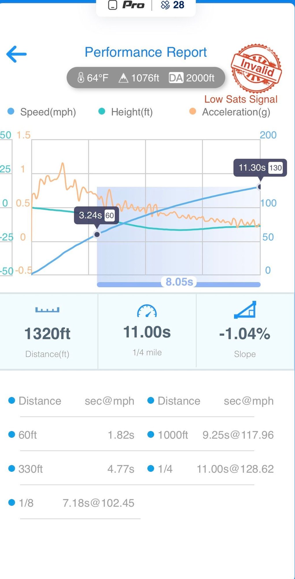

From this morning.

Originally Posted by ER9240
From this morning.
That's a lot of slope try finding a flatter road and better lock on satellite
Should look more like this!
