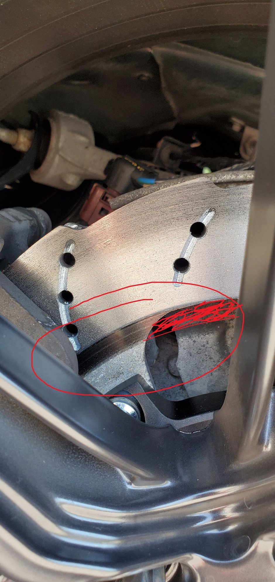

Originally Posted by Joseph Ng
I was thinking the same thing, that it could be the pads. But the mechanic said they were the same size.
I doubt the 376mm pads would even fit in the 326mm calipers anyways
​​​​​​Mecahanics aren't the 'sharpest tools in the box' ;-)
Remove the wheel, hold up one of your old pads (in a similar area to the caliper) to see what likely rotor coverage it has. That is the easy way to tell if it's the pad or rotor that is incorrect.

If the top hats are the same size for the 326mm and 376mm rotors I wonder if Wortec simply turned/cut the outer diameter of the larger 376 mm rotor to turn it into a 326mm one. That might explain the contact area on your rotors close to the hub.

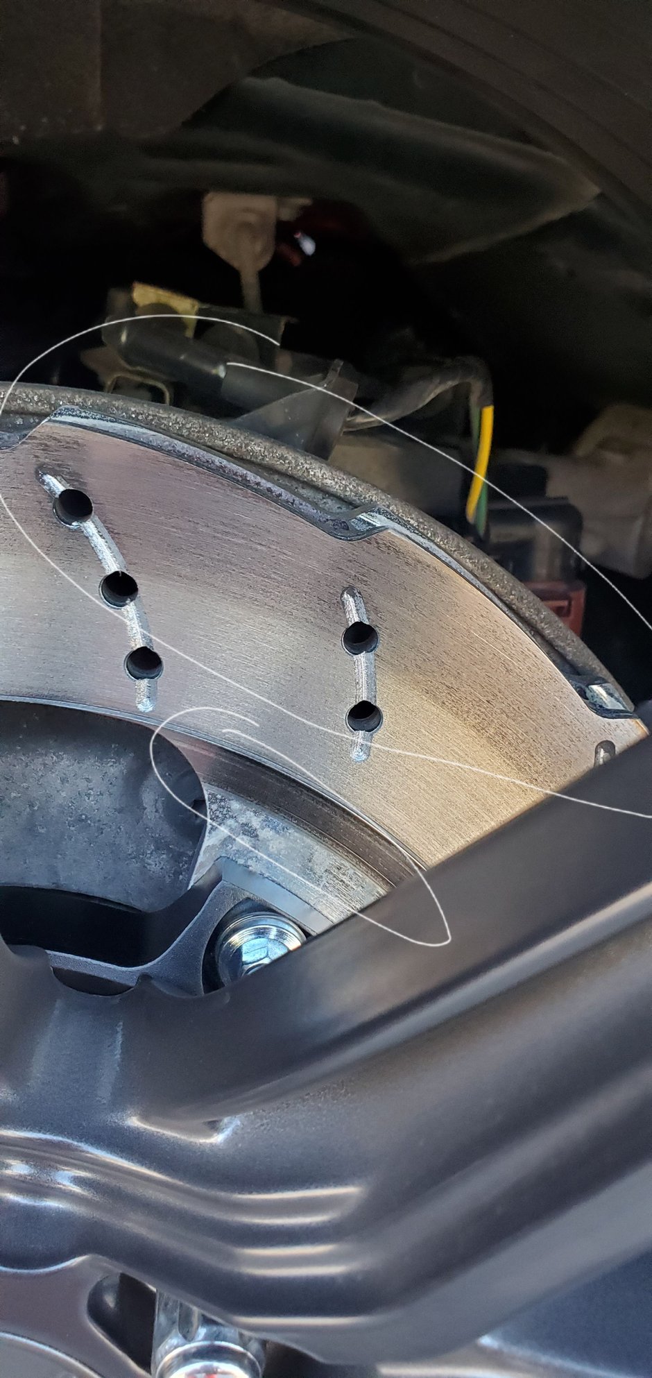

Originally Posted by RGPV6S
It is approximately 51 mm or 2" on my car with 326 mm rear rotors. Looks like that is what you have too but in the wrong spot near the hub. However from looking at your photo above it looks like the pads are only contacting the inner part of the rotor.
Very happy to hear they are offering the 326mm rotors if they get them right.

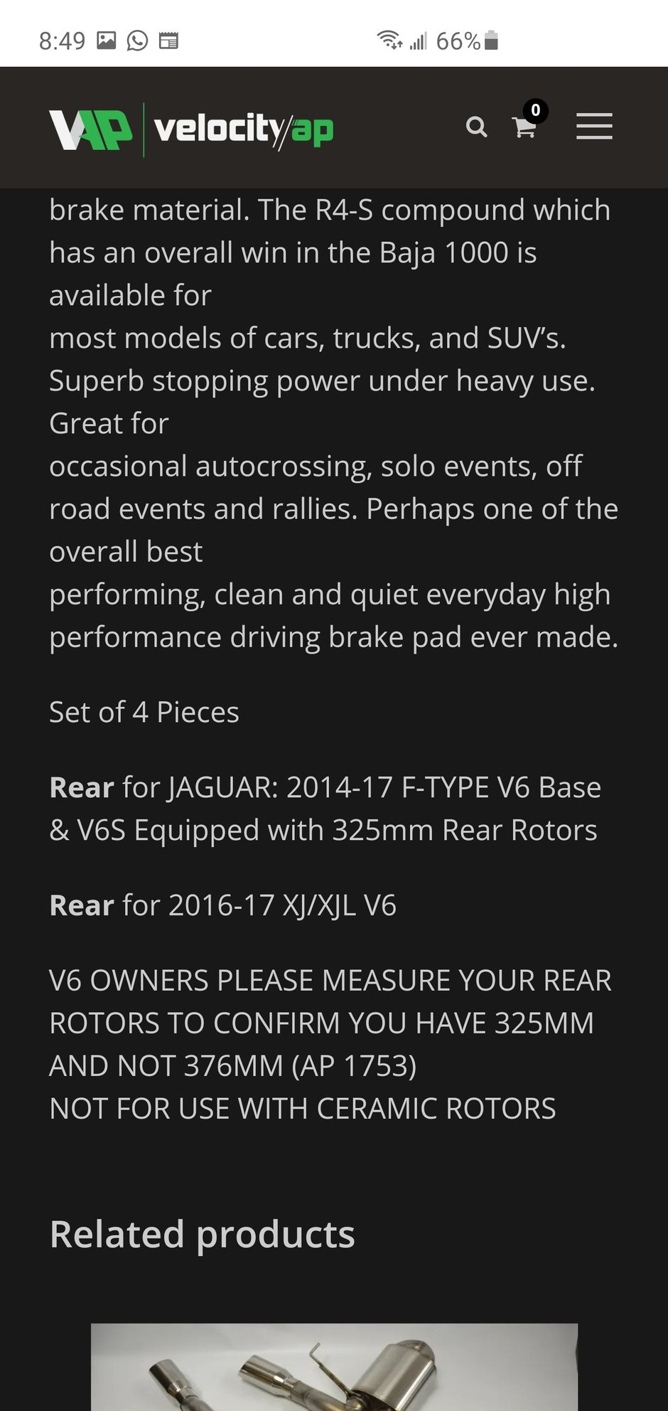

Ok thats very strange that your contact area is also 51mm? Now im wondering if velocity ap send me the larger rear pads in the smaller rear pad box? I know the mechanic said they were the same size. But this doesnt make sense now.
Would the larger pads even fit in the smaller caliper?
Originally Posted by Unhingd
Do you have the same issue on both sides of the car?
Present on both sides. Its actually more noticeable on the passenger side. you can see that the pad is only contacting on the lip and outer edge.

Called porter field the larger rear pads are 4mm difference in height and 10mm difference in width. So they would not fit in the same caliper.

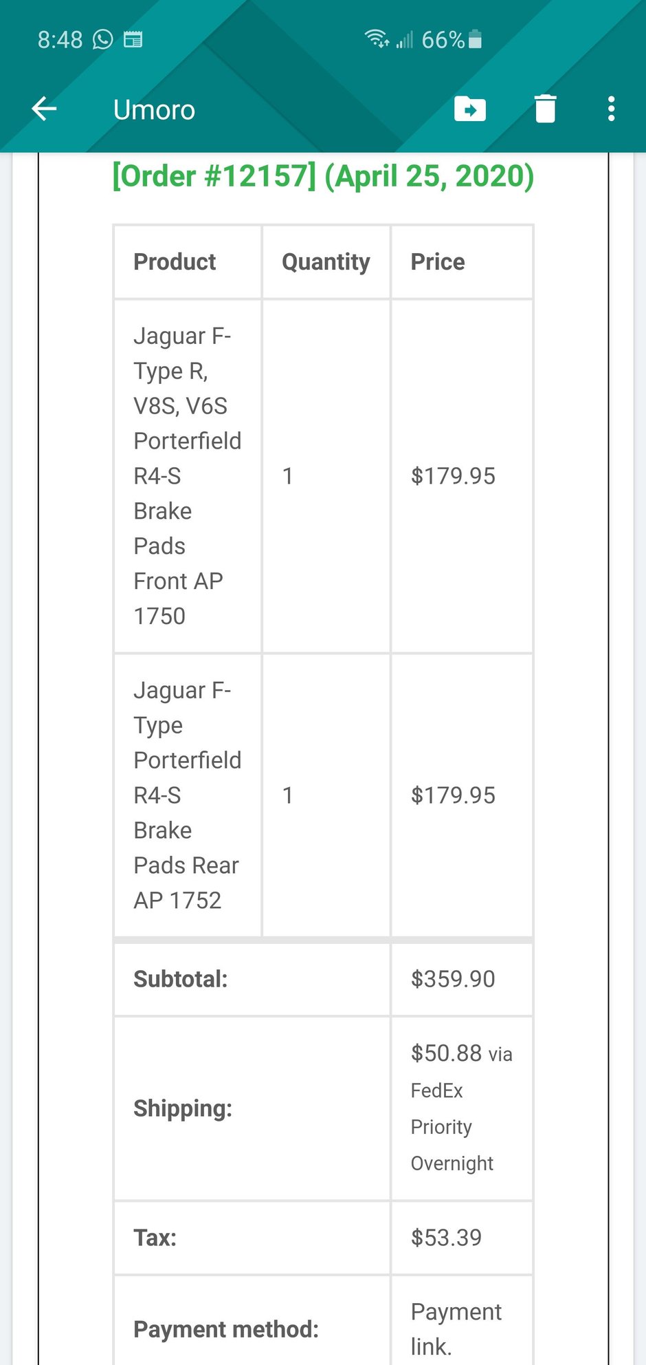

Yup, the porterfield 1752. Does anyone have the dimensions of the 326mm pads?

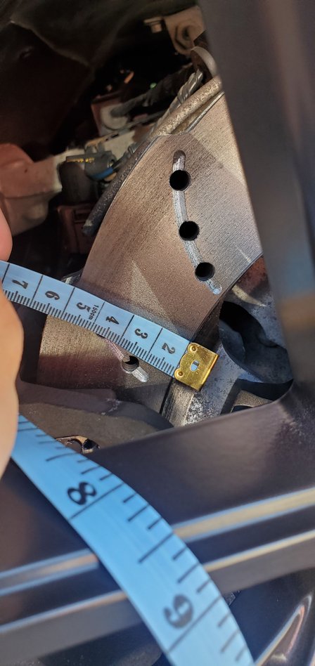

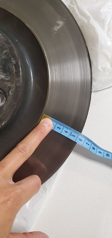

Ok the mechanic was able to get his scrap guy to bring the rotor back. The 100% confirmed the swept area is smaller on the Wortec
Stock Rotor: 51MM
Wortec: from inside edge to bottom of sun cut 40MM
Top of Suncut: 45mm
So basically as you can see in the last photo they need to increase the swept are toward the inside more.
Waiting for Wortec's response to this

I think I see what they did. It looks like they just took the 376 mm rotors and cut the diameter down by 50 mm without realizing that the 326 mm rotors have a smaller inner radius on the swept area. They should’ve machined down another 5 mm on the radius. You could have that issue resolved at a local brake shop with a rotor turning machine.
