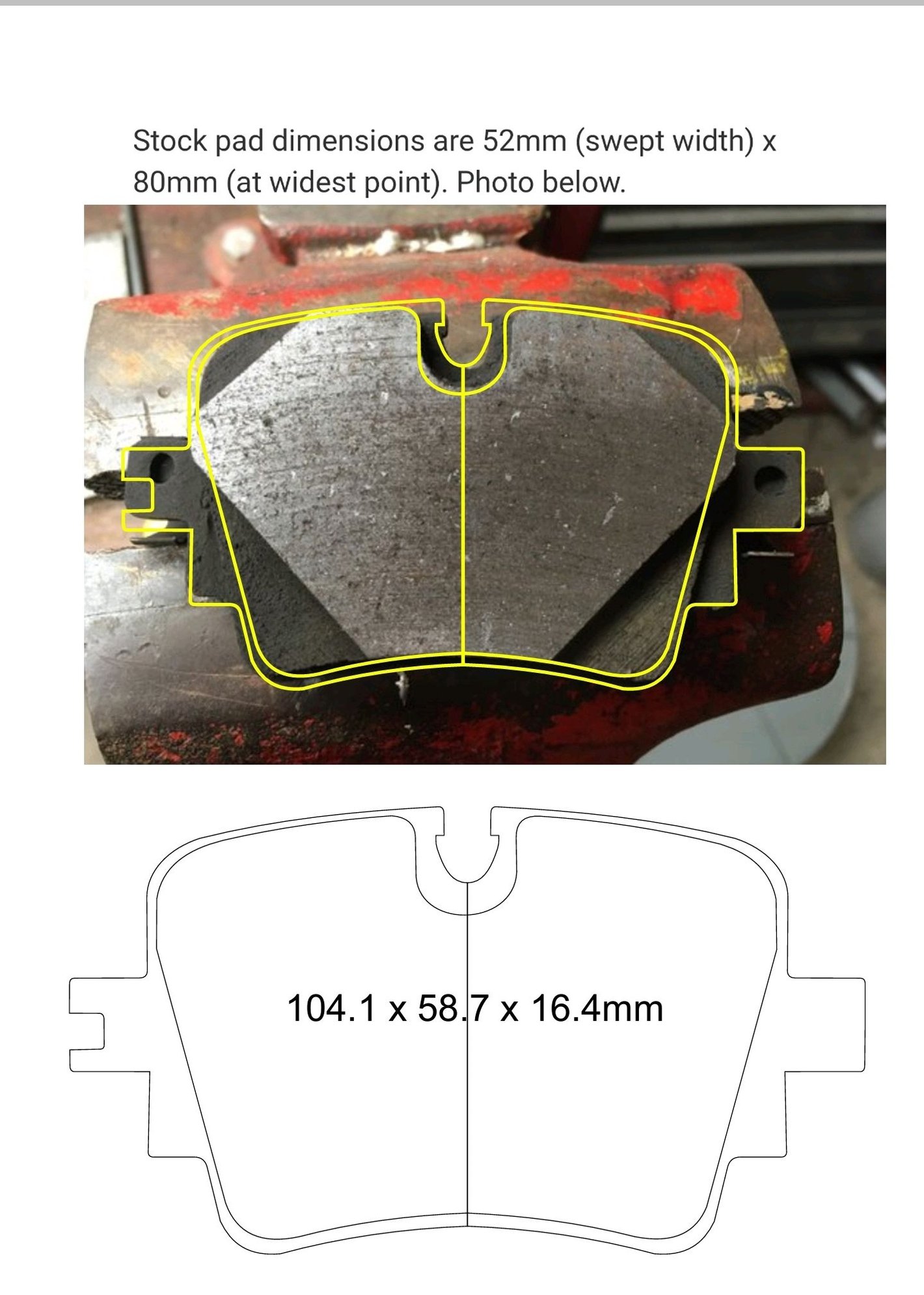

Originally Posted by RGPV6S
Stock pad dimensions are 52mm (swept width) x 80mm (at widest point). Photo below.
Huge help with this photo! I sent this to wortec and they over layed it with the jaguar brake pad and are not ordering this pad to make the new rotor.

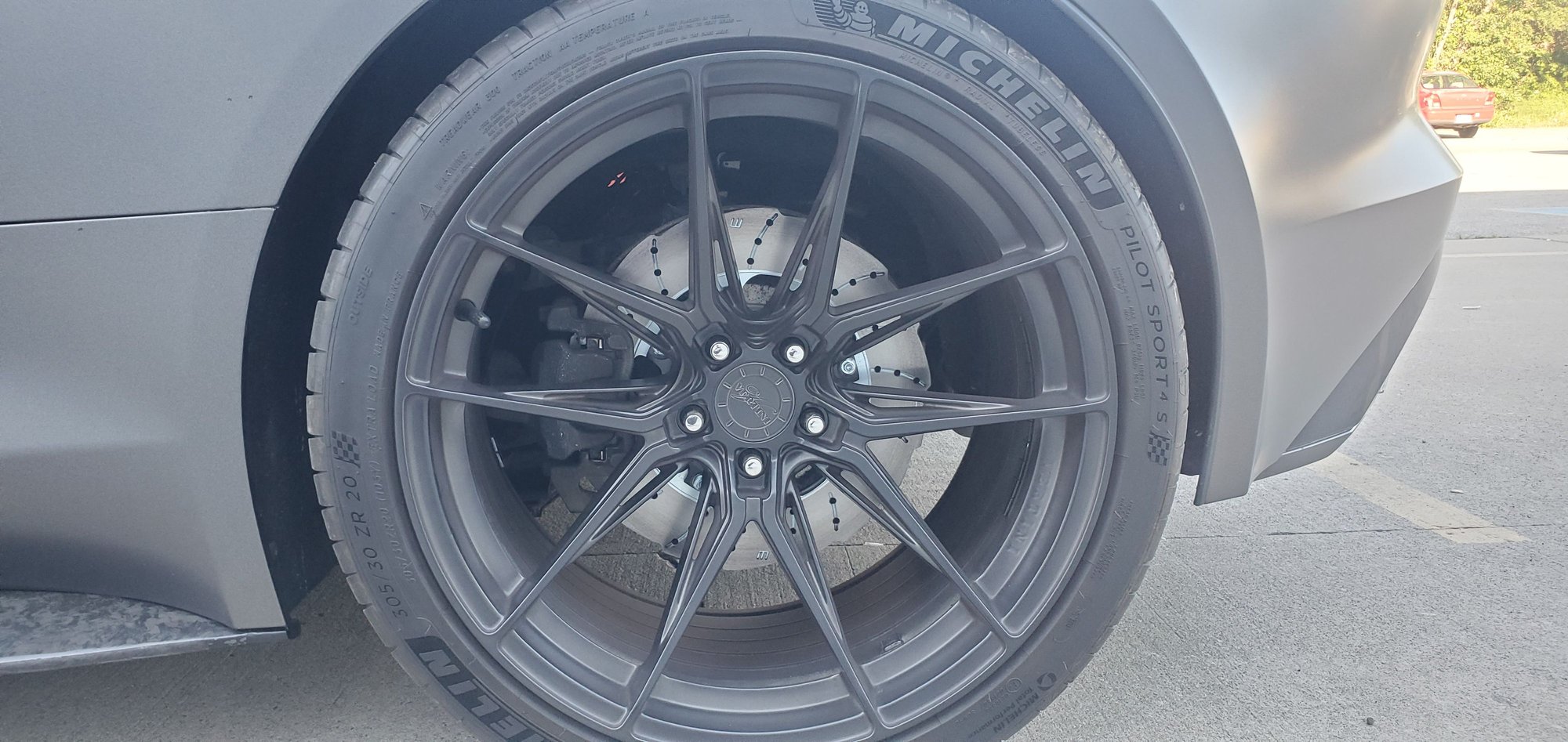

Oh that's weird! I thought I posted about it. It's great! They sent new rotors and some ebc yellow stuff.
I actually had someone complement my car and said the first thing they noticed was the rotors 😊
