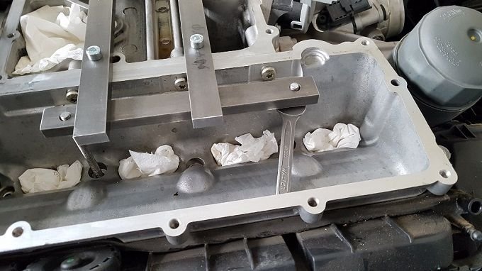

Originally Posted by 2000JagLvr
What is the best way to get the supercharger unstuck.
built myself a simple tool out of flat steel and a threaded rod.
Most gentle way to lift the supercharger off.
Regards
Ulrich
