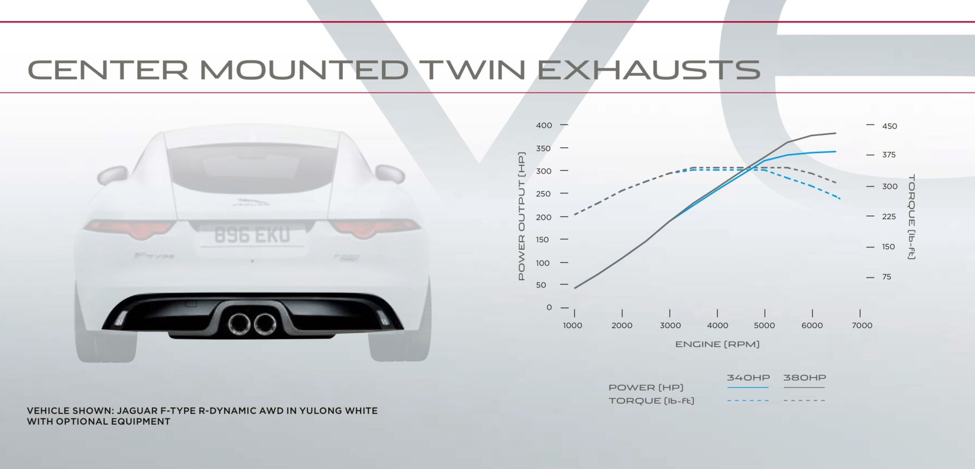

Per JLR, the 380bhp V6 makes full horsepower at about 5800 rpm; at 3500 rpm it's about 225 bhp. Max torque of 339 lb-ft is available from about 3400 rpm and begins to fall off after about 5500 rpm
Where are those HP per RPM figures published? Is it a dyno graph?
Asking for a friend.
Yeah, line graphs on page 27 of the 122-page factory brochure for the 2020 F-Types. I found it online and downloaded it after I bought my F.
Good call, here it is…
From the 2020 brochure…
https://www.auto-brochures.com/makes...-Type_2020.pdf

Just for reference, VAP dual pulley.......just to gauge drivetrain loss....blue lines are 340 so the base v6.
The red is the VAP stuff.....
from the VAP website, at the wheels data
