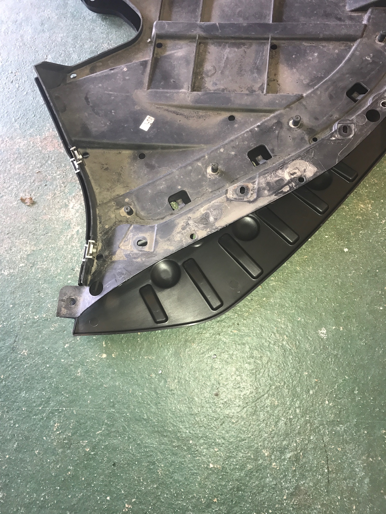

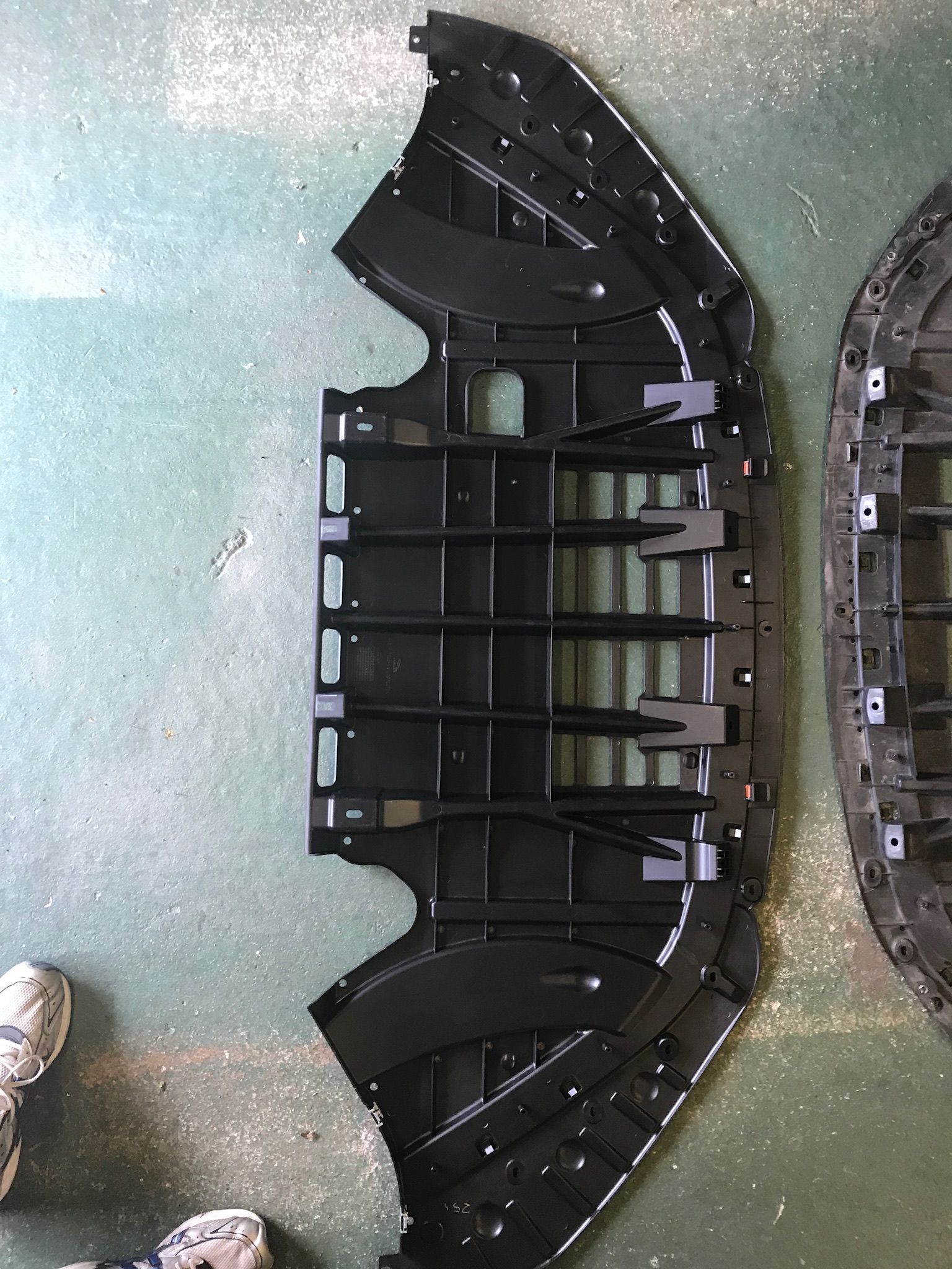

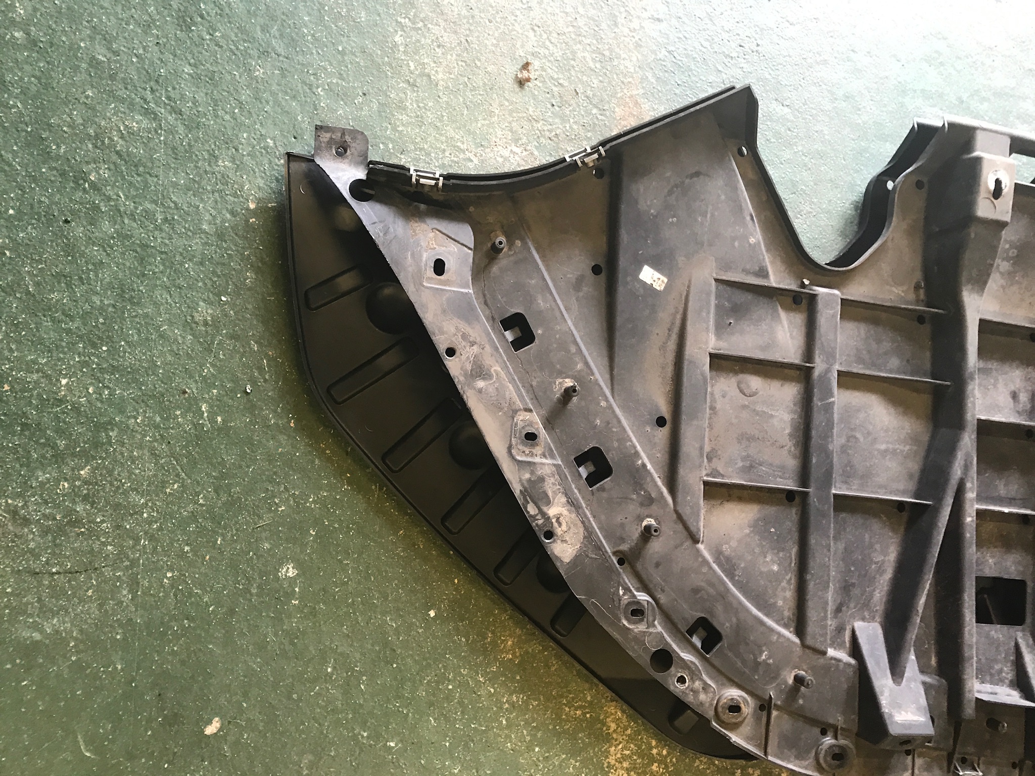

For future reference here's my V6S undertray next to the SVR that is now fitted. Aside the leading edge profile which is completely different the rest is identical in profile. Every crease, curve and fixing mates perfectly.
Seems to me that man early 2WD is the same as a current SVR
One difference is the extra cooling on the SVR which aligns to the aux rad
