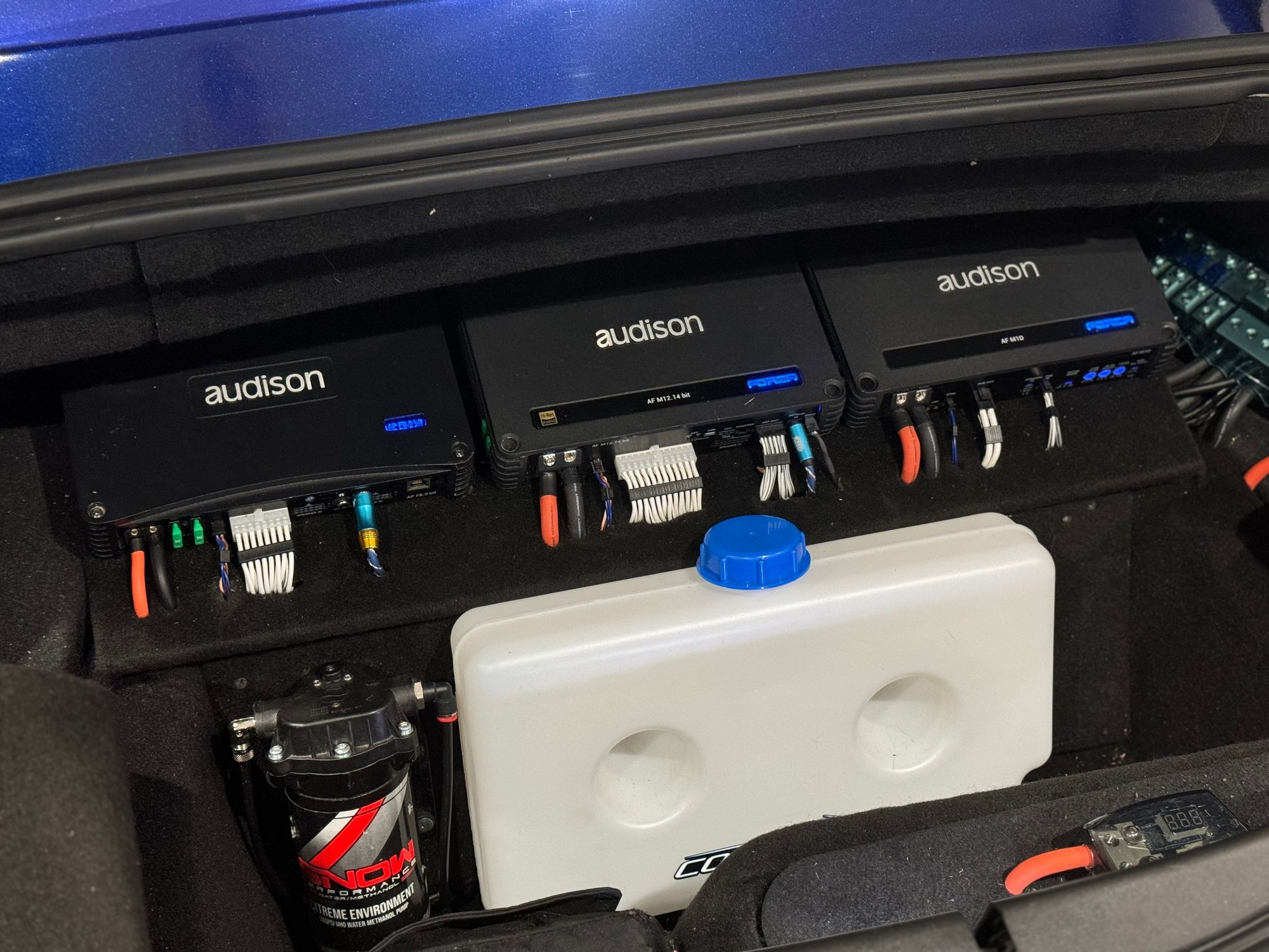

You can get real bass it’s just more expensive than other cars
i I have hertz legend everywhere
audison m12 bridged to run fronts and pre out to audison m4d to 2 jbl 6.5 inch subs I had specifically fabricated
and a m8 bridged for rear woofers and and remaining 4 channels run the rear mids and tweeters

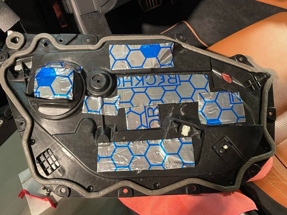

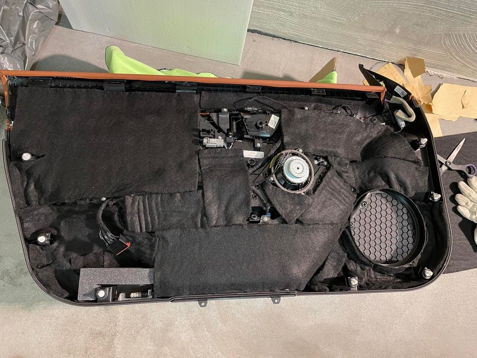

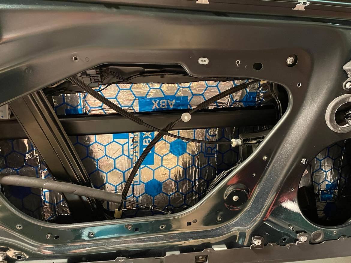

The sound deadening is real easy too if you just buy the right stuff - something like Dynamat for the inside of the door skins and then some thick sound deadening stuff for the inside of the door cards. Don't know if their products are available in the US but the German company Reckhorn has some brilliant products that some say are even better than Dynamat and I bought everything from them. This is how I insulated mine.
