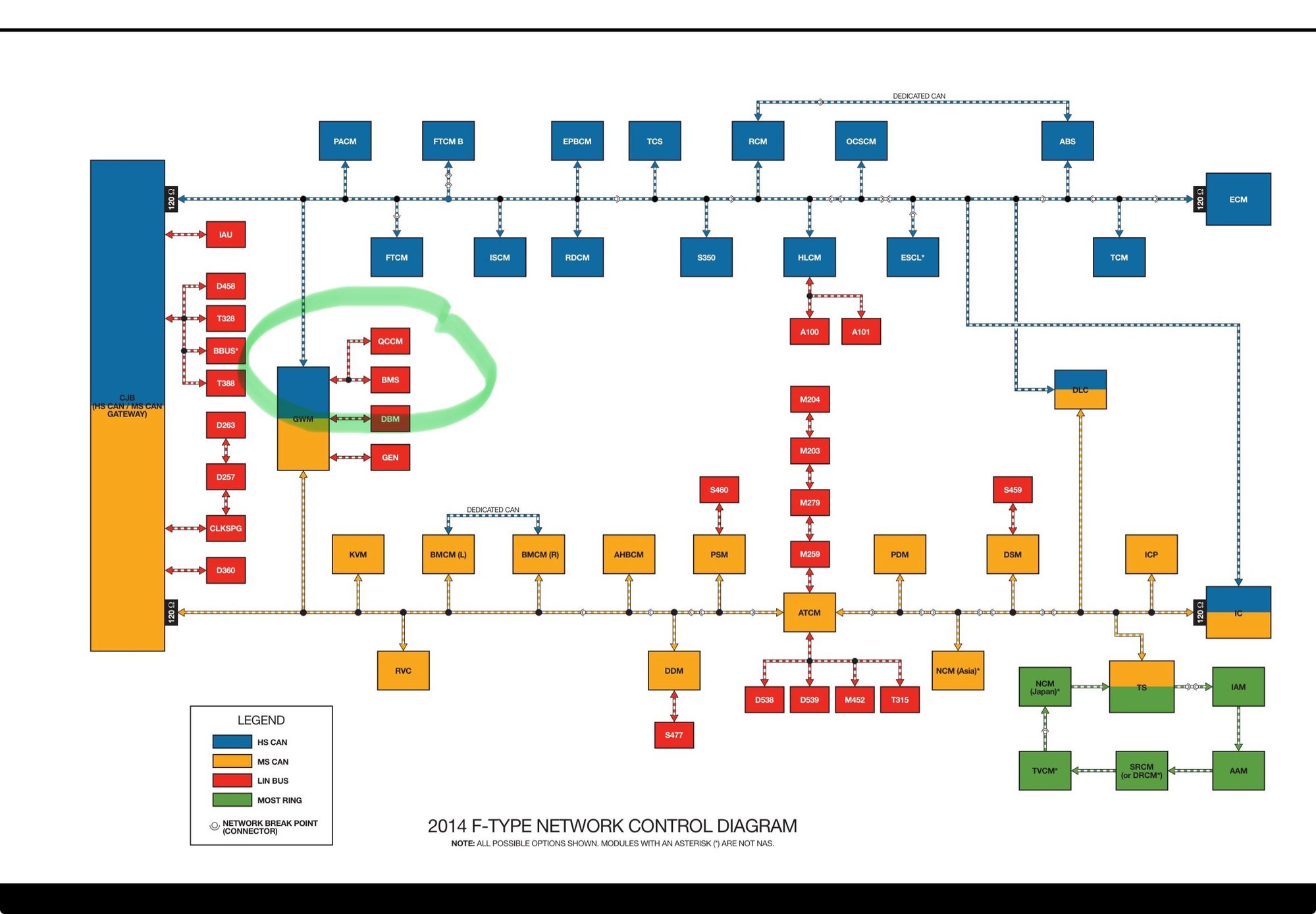

What I was trying to convey earlier is that EVERY component on the LIN 1 bus is connected to the SAME white wire for transmitting data . You can see it on the video you posted of the battery connector. You'll also find that white wire going to the Quiescent Relay Box, the body control module, and every other devices on the LIN 1 bus. That's the wire you need to scrutinize first if the Ebay part isn't the problem.
It appears that the QCCM and the BMS have a private LIN network all to themselves. The Gateway Module (GWM) is the master.
https://www.dropbox.com/scl/fi/r5j5t...=qal4j06z&dl=0
Thanks, I didn't research what other devices are actually on LIN 1 but that would definitely simplify things if he needed to track down the offending wire or component. I'm 99% sure it's simply a defective aftermarket part and all of his problems will go away once it's replaced with a new or used genuine part. It was simply too coincidental that the problem started after he replaced that broken component. I've learned the hard way to NEVER buy cheap aftermarket electronics and sensors. It's a crap shoot if they'll work from the start and even if they do, they often fail in weeks or months. Unfortunately you can't even trust what appears to be OEM parts from questionable sources any longer since Chinese companies have gotten really good a counterfeiting not only parts, but packaging. Companies, such as NGK, even have put up websites warning customers and showing them how to identify counterfeit parts from genuine one and the differences both the parts and packaging are extremely subtle.
