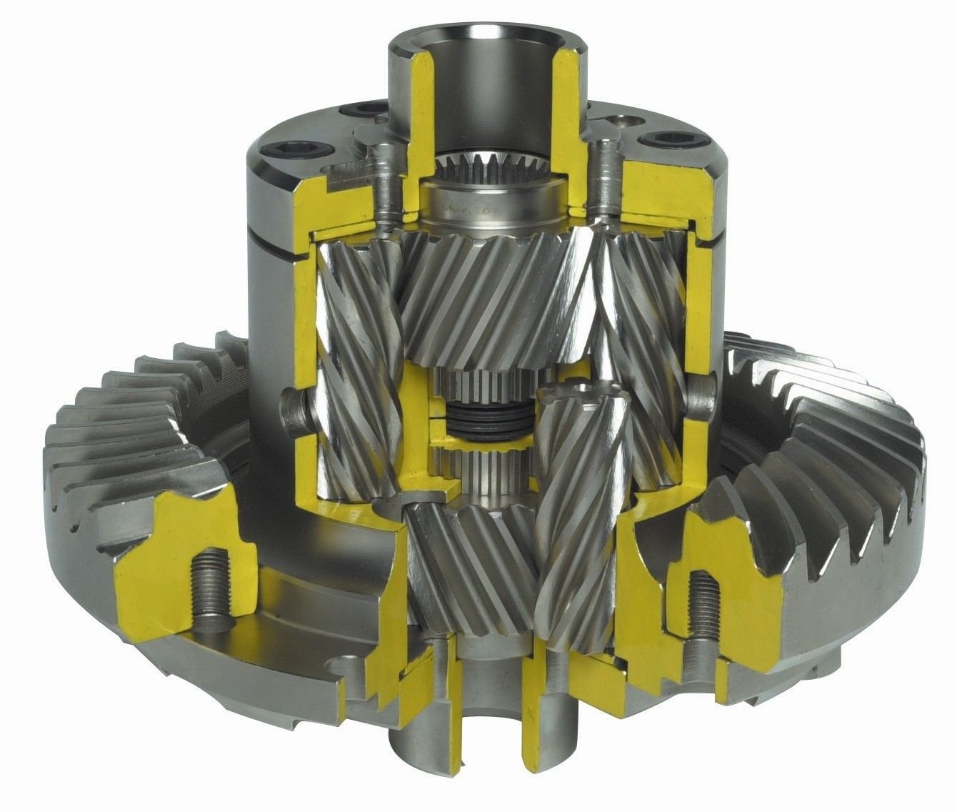

OK...Well, here's another one. I am in contact with Quaife for them to build me a Torsen style helical gear, torque-sensing limited slip differential. These units do not rely on slip discs to limit the slip, but rather direct coupled gearing. for superior durability and metered locking. As we had to do with the Wortec rotors and the 4H-Tech short shifters, they will design and build them for the F-Type if a minimum of 10 units are ordered. As I currently only need one, I'm wondering if anyone else might be interested. The fact that we are starting with 3 different differentials with potentially even more final drive ratios will make this project a bit more interesting, but we should be able to sort this out. At the end of the day, knowing that the OEM differentials have not proven to be bullet proof, there may well be a long term demand for the Quaifes as a bullet-proof replacement for failing units. (They will also be less expensive than the OEM diffs.) I may well choose to stock a few of them myself for resale. (Or maybe VAP will step up to the plate). Let me know if you have any interest.

All good questions, yet to be answered. We are dealing with at least 3 different diffs. Open diff, mechanical LSD & ELSD.
1. I suspect installing a Quaife in the ELSD will throw a code that will require some type of programming if you don’t want to see the “ELSD not available” warning.
2. The 3 varieties of diffs probably have different cases, creating an additional challenge as well.
3. Final drive ratios vary, which will require some thought and even additional programming to keep the speedo accurate.
Will keep you posted. Development on the short shifter took 18 months. This project will take a similar amount of time.

OK i'll give you my 2 cents...
I've fitted Quaifes to both my XKR and my XJR. Having an LSD is a million times better than a crappy open diff. But to be honest the ATB design of differential is not perfect for every occasion. Quaife makes a big deal about their diffs "never locking" but honestly sometimes a locked diff is preferable... don't get me wrong i'm a big fan of the Quaife diffs, but part of that is because there is no other option for the 4.2L cars...
Anyhow, back to the F-Type...
The F-Types without E-Diff are;
3.15:1 V6 non-S, 8-speed auto (open)
3.31:1 V6 non-S, 6-speed manual (open)
3.31:1 V6S, 6-speed manual & 8-speed auto RWD (LSD)
The E-Diff cars;
2.56:1 (V8S, R, RWD & AWD)
3.31:1 (V6S AWD)
Frankly I would forget about the E-Diff cars, because unless you have a means of editing the CCF, you have to keep the E-Diff functioning, or have a dashboard full of fault messages (can't recall if power is reduced with an E-Diff fault or not).
The manual transmission cars simply do not care what the diff ratio is.
Automatics have the diff ratio programmed in, and if the ratio is determined to be outside of an allowable tolerance, you get fault codes and the transmission will go into limp home mode.
I don't know what the allowable tolerance is, but we suspect it's an arbitrary 10%, why 10%?
If you have a 3.31, then you can put in a 3.58 and there is no problem.
If you have a 3.15, and put in a 3.31, there is no problem.
If you have a 3.07, and put in a 3.31, there is no problem.
If you have a 2.87, and put in a 3.07, there is no problem
All these have been done & tested (in F-Type, XF, XJ and XK) and the change in ratio is not more than 7.8%
If you have a 2.87, and put in a 3.31, fault codes & limp mode...
If you have a 2.56, and put in a 3.31, fault codes & limp mode...
So something like 15% variation, is just too much.
For the F-Type V6 non-S owners, going from 3.15 to 3.31 is not a problem. i.e. bolting in a V6S diff, as others have done in the past.
For the F-Type V8 owners it's pretty much irrelevant, because of needing to keep the E-Diff, or finding someone to take care of the programming.
The factory diffs are made by GKN Driveline in the UK, they also make the diffs in the Land Rovers. And it's ironic (to me) that GKN says that they have a helical/atb differential in their product range.
But GKN has absolutely ZERO interest in aftermarket sales/support/service. You can't even buy seals or bearings from them. There are some guys in the US who have rebuild kits for the GKN diffs in the Land Rovers, but nothing for the Jags (different diffs, of course).
GKN is not just an OEM to JLR, no doubt their diffs are in other makes too. But I haven't had the incentive to investigate it further, I don't have a GKN diff in my cars...
Now, if you get a Quaife unit made to suit the F-Type V6... keep in mind that unit will fit in other models too, that are really in need of LSD...
XK 5.0L naturally aspirated V8 (people have put the F-Type V6S diff in)
XF 3.0L V6 supercharged
XE 3.0L V6 supercharged
Those all have open diffs, and the "same" diffs as the F-Type V6s, although not the same ratios in the XE & XF.
If you need 10x units, then find some XE and XF supercharged owners to make up the numbers. As I recall there was one guy with an XF V6 supercharged who went nuts with pulleys & tunes and was going out of his mind because of no traction with the open diff...
