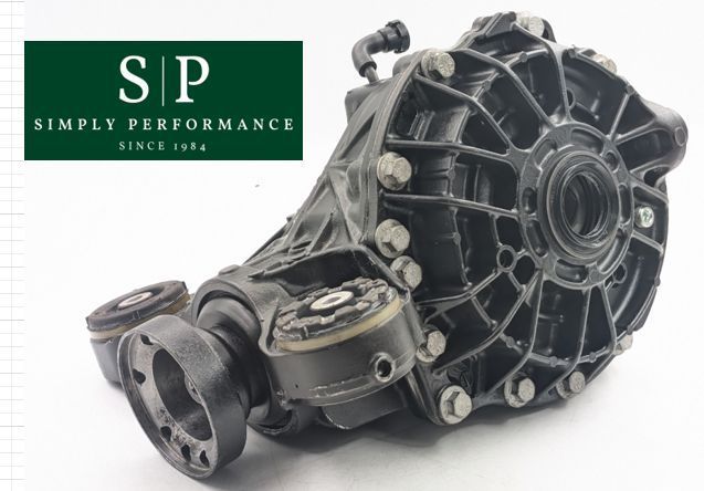

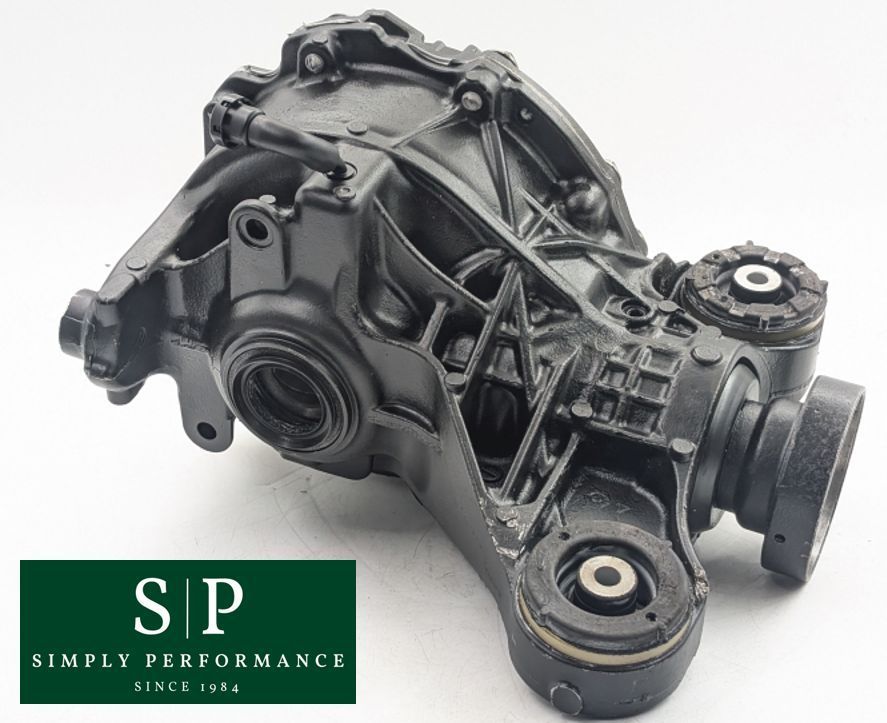

There is a second thread on the build up of the Quaife ATB equipped rear differentials for modern Jaguars.
The latest update as of March 2026 is a product announcement by Simply Performance linked here:
https://www.jaguarforums.com/forum/f...0/#post2903834
