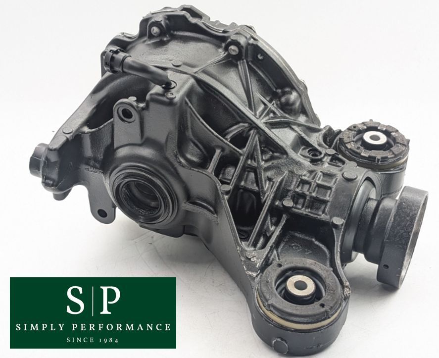

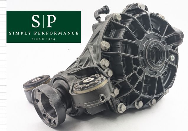

It is with some excitement that I am making this announcement to those on the Jaguar Forums who have shown interest in the helical geared rear differentials. Your patience is appreciated. I have worked with Simply Performance in the UK to provide fully rebuilt rear differentials. This offering is more refined than the original batch of units built by Onca Engineering. Please contact Simply Performance for additional information.
Drive well,
Herman
Simply Performance, with support from Onca Engineering, is expanding their range of rebuilt differentials to include the Dana 44™AdvanTEK units found in modern Jaguars from 2012 onwards. The initial focus of this new offering is predominantly on the V6 models, along with some V8 and I4 applications. This offering also includes an optional upgrade for a maintenance free, helical geared Quaife ATB differential for select gear ratios.
Over the past 18 months, there has been dwindling support from the OEM and supplier for these differential units. Simply Performance will fill the emerging need for quality rebuilt rear differential units. The process will start with a full strip, clean, blasting and paint of the core unit. Next, all bearings and seals are renewed with OEM quality components. Finally, the unit is re-assembled and adjusted with shims and external fasteners.
Contact Simply Performance for more details.
Ebay shop: Simply Performance
Web: www.simplyperformance.com
Email: ben@simplyperformance.com
About Simply Performance: A family business based near Dorking, Surrey UK focusing on Jaguar parts for classic Jaguars. Simply Performance has supplied differential repair services for the last 15 years and has historically focused on a select range of differentials; the Salisbury 4HU, 4HA, 15HU and 14HU. These were originally made by Salisbury Axles in Birmingham, UK, now owned by Dana. Simply Performance is now leveraging this experience to expand its rebuilt differential product range with its dedicated team.
