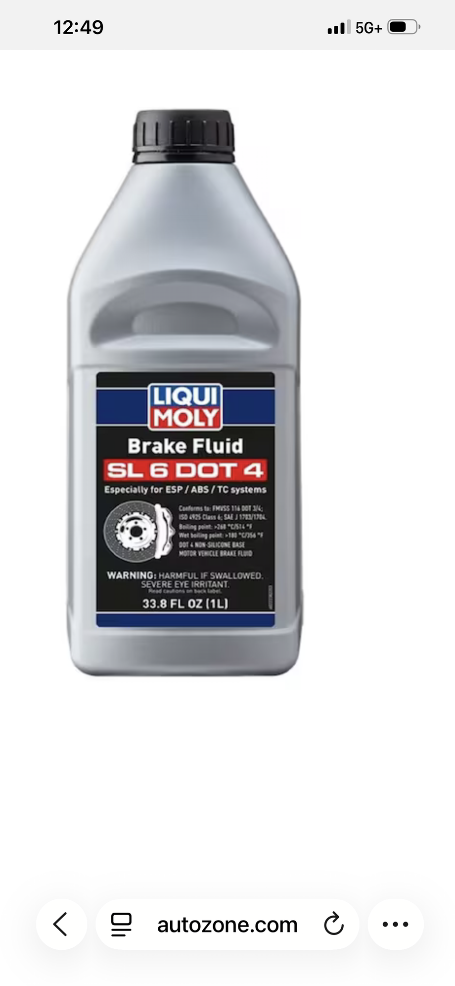

Liqui Moly SL6.

Originally Posted by BigJay13
Liqui Moly SL6.
Link doesn't work. Prefer Liqui Moly but that link isn't working.
Several places carry it... link to ECS Tuning
https://www.ecstuning.com/b-liqui_mo...hoCnUQQAvD_BwE
