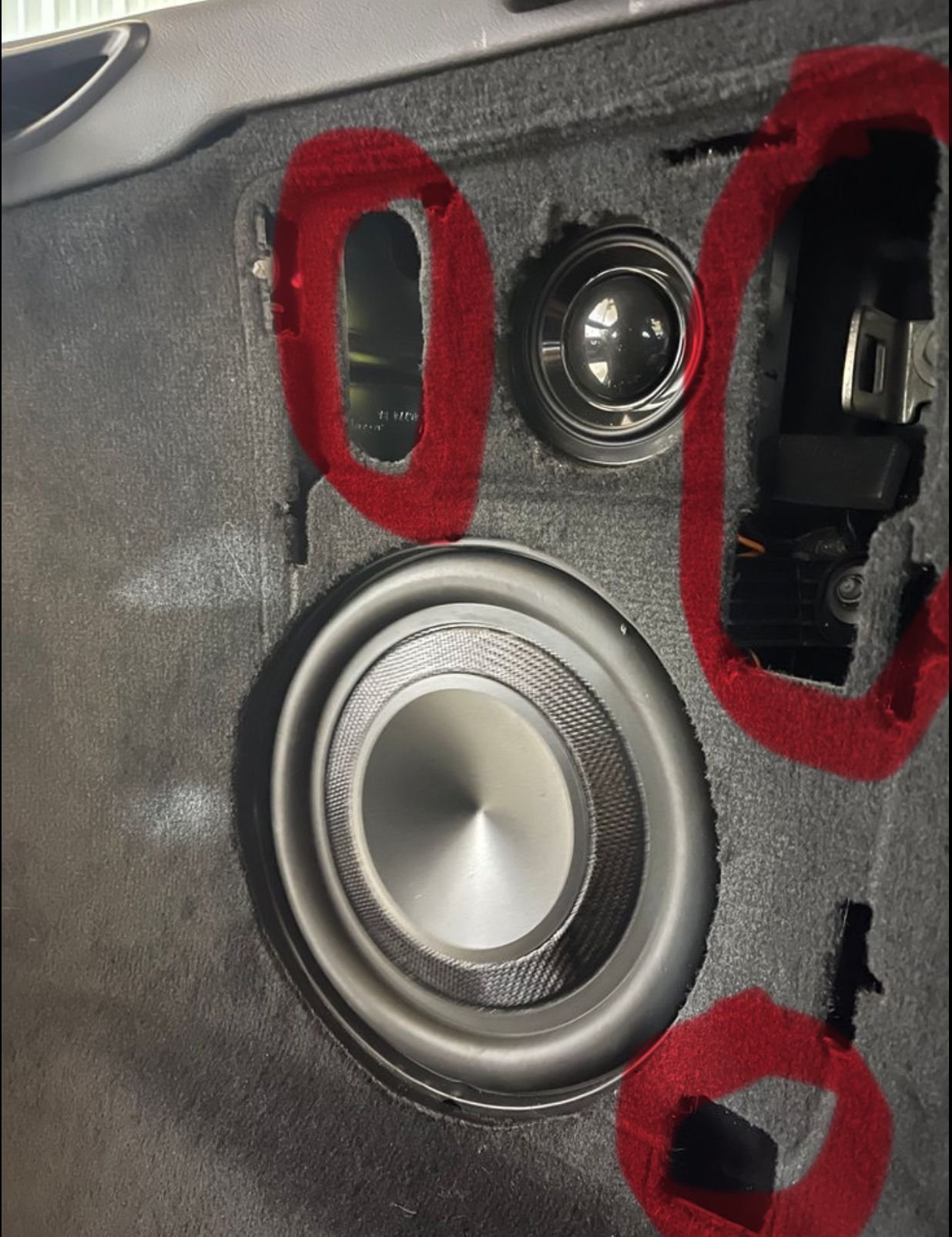

From: Phoenix
While I’m at it, does anyone know what these cutouts in the rear panel are for? Are these useful to access something behind the panel? It seems like these openings would degrade the response of the rear drivers.
