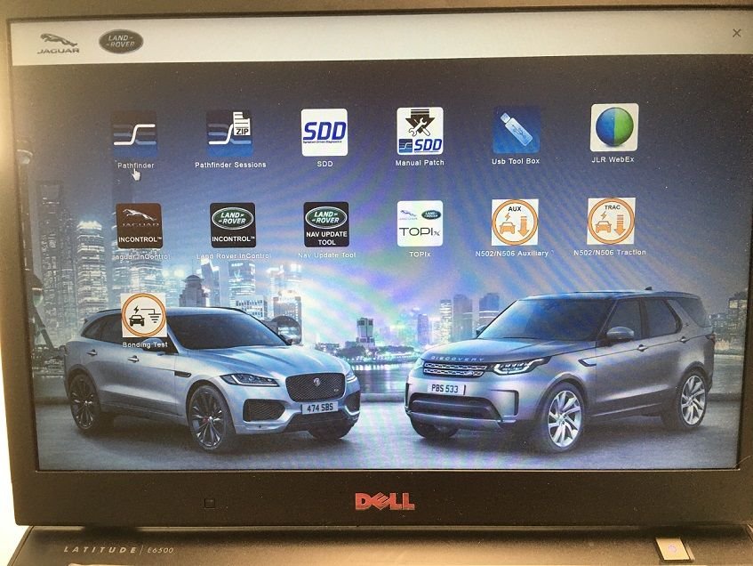

$1000 just to start. Wow that's a lot. Now they do give you a 1 year dealer subscription so that will make it work for 1 year. Also note that is ONLY for diagnostics and NOT for any programming. So a limited use Pathfinder system. Programming will require a live subscription and connection to JLR servers to work.
I have the complete Pathfinder already loaded (My desktop is exactly as pictured in the ad) and it does operate.
I do have several additional icons I am not sure how to use? Those 3 yellow circle icons.
I can't do anything with Pathfinder because of the subscription problem. I can and do access SDD thru that Pathfinder interface and it still works as does my hacked SDD.
I am still looking for a method to use it without being connected to JLR as that requires a subscription and it time based so you never get it paid off!
Maybe for a commercial shop they could make it pay but for a car owner it's just too expensive to pay everytime you hook the car up.
