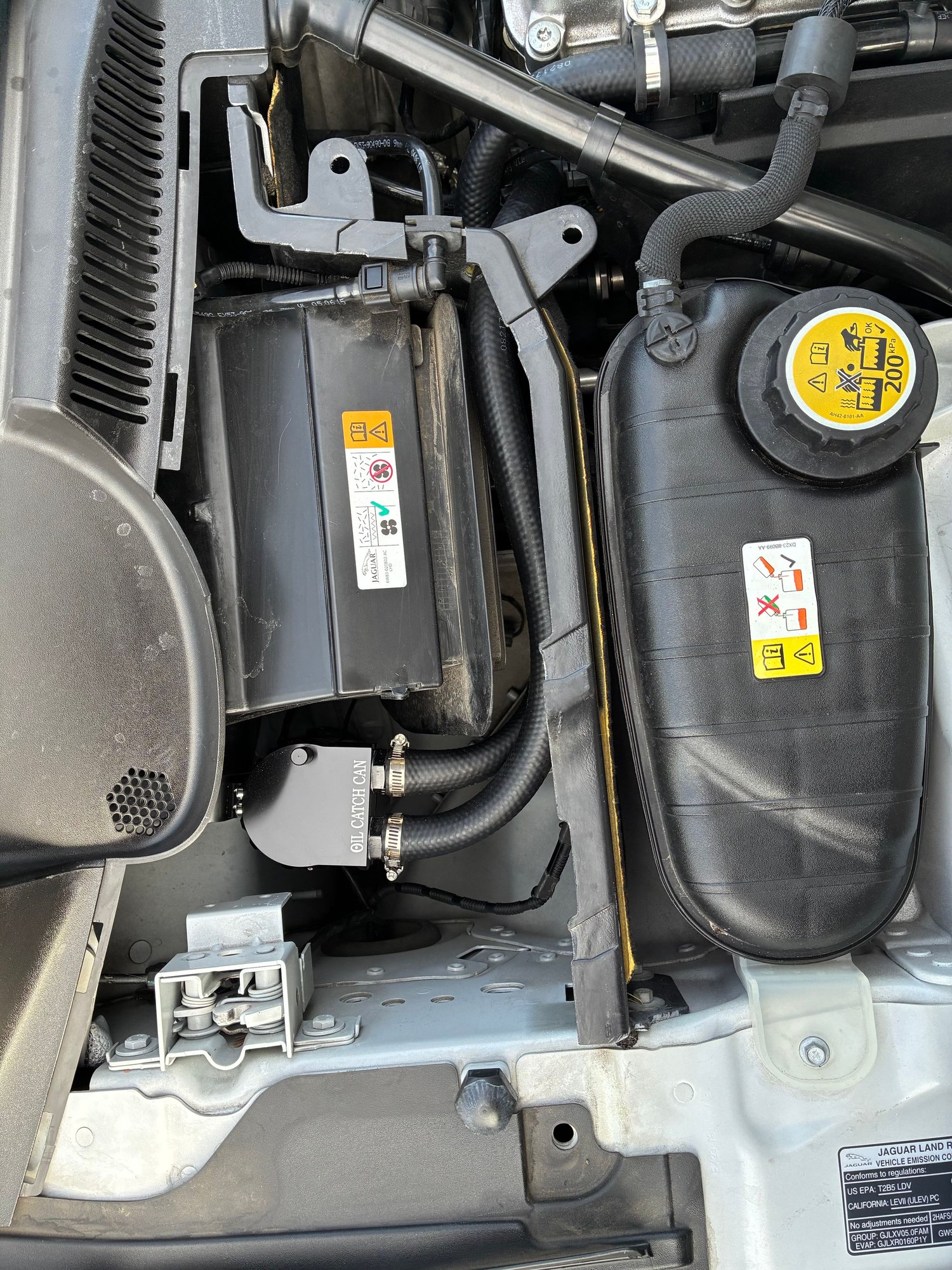

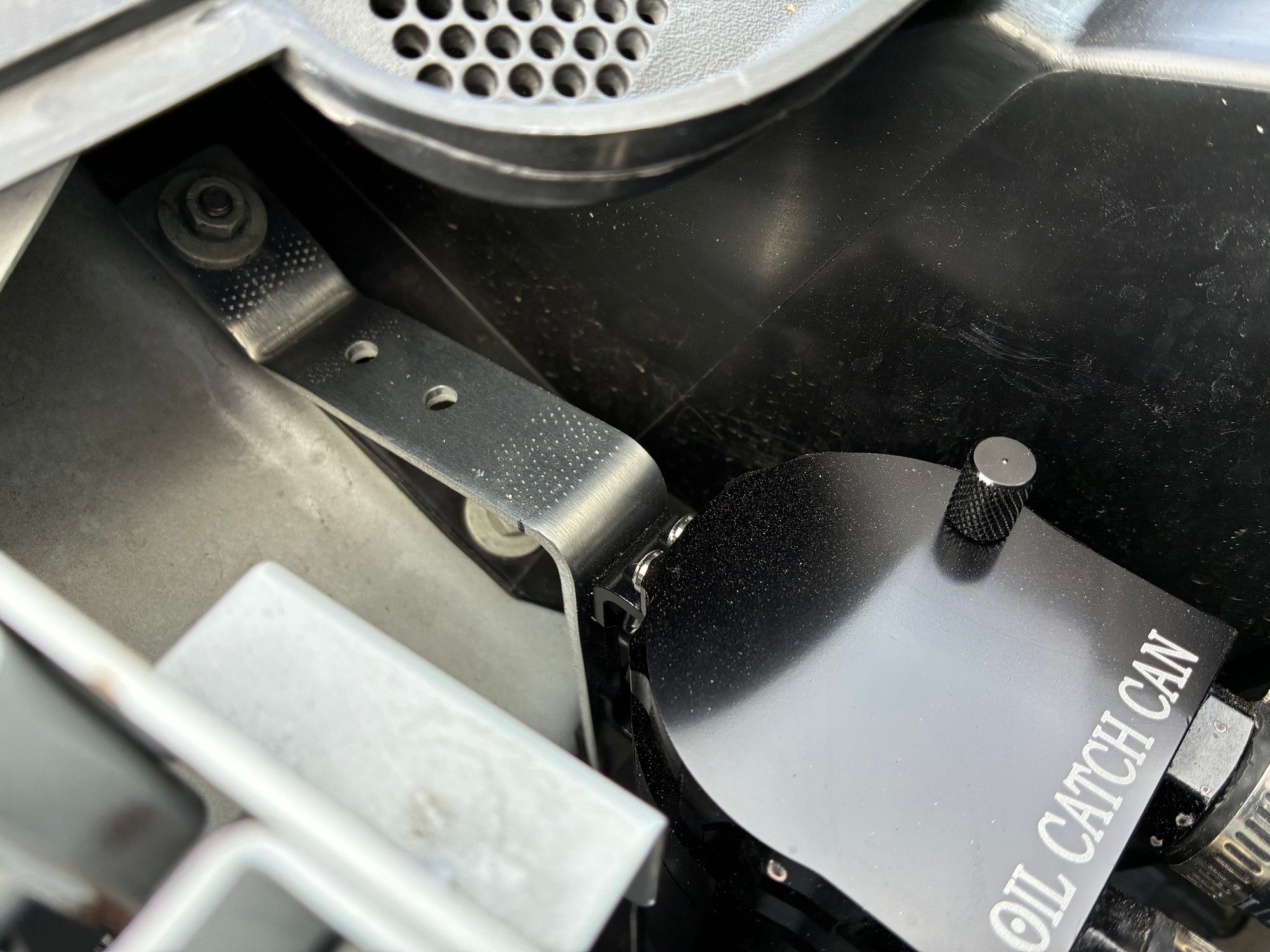

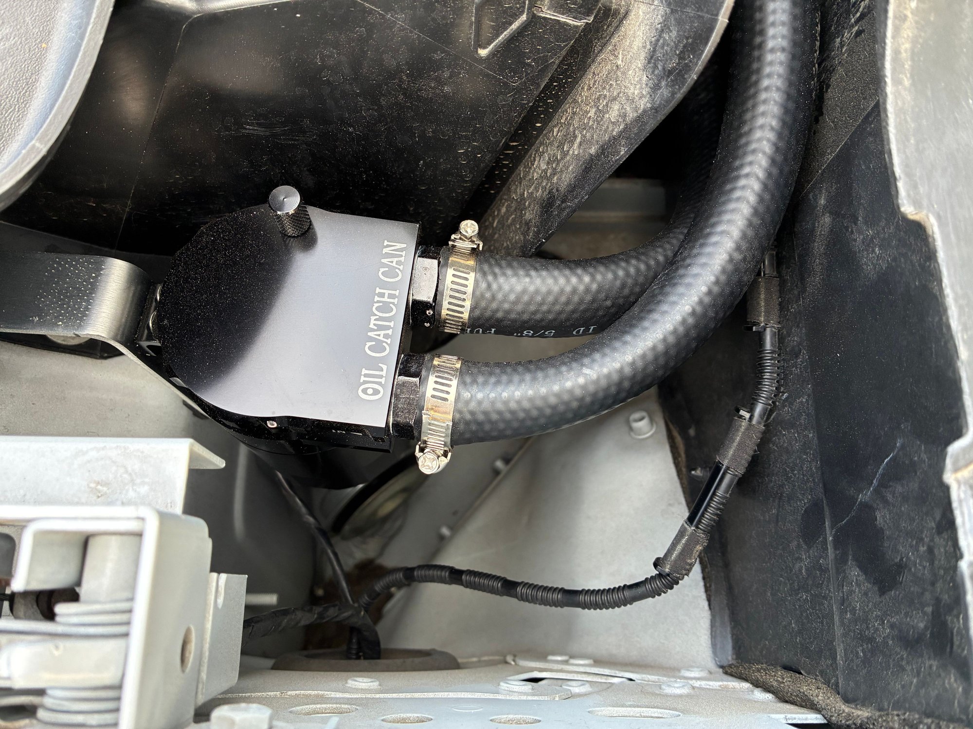

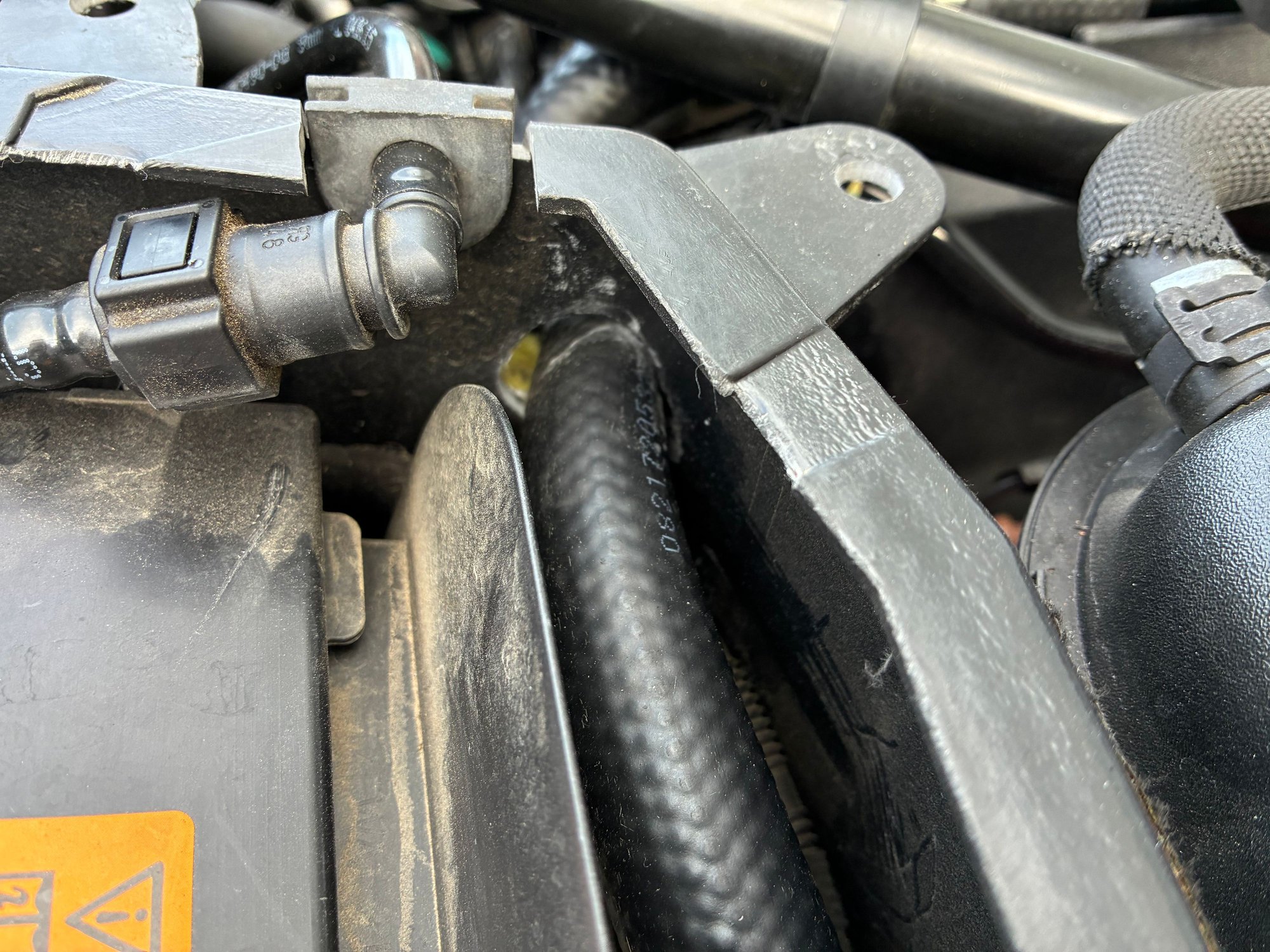

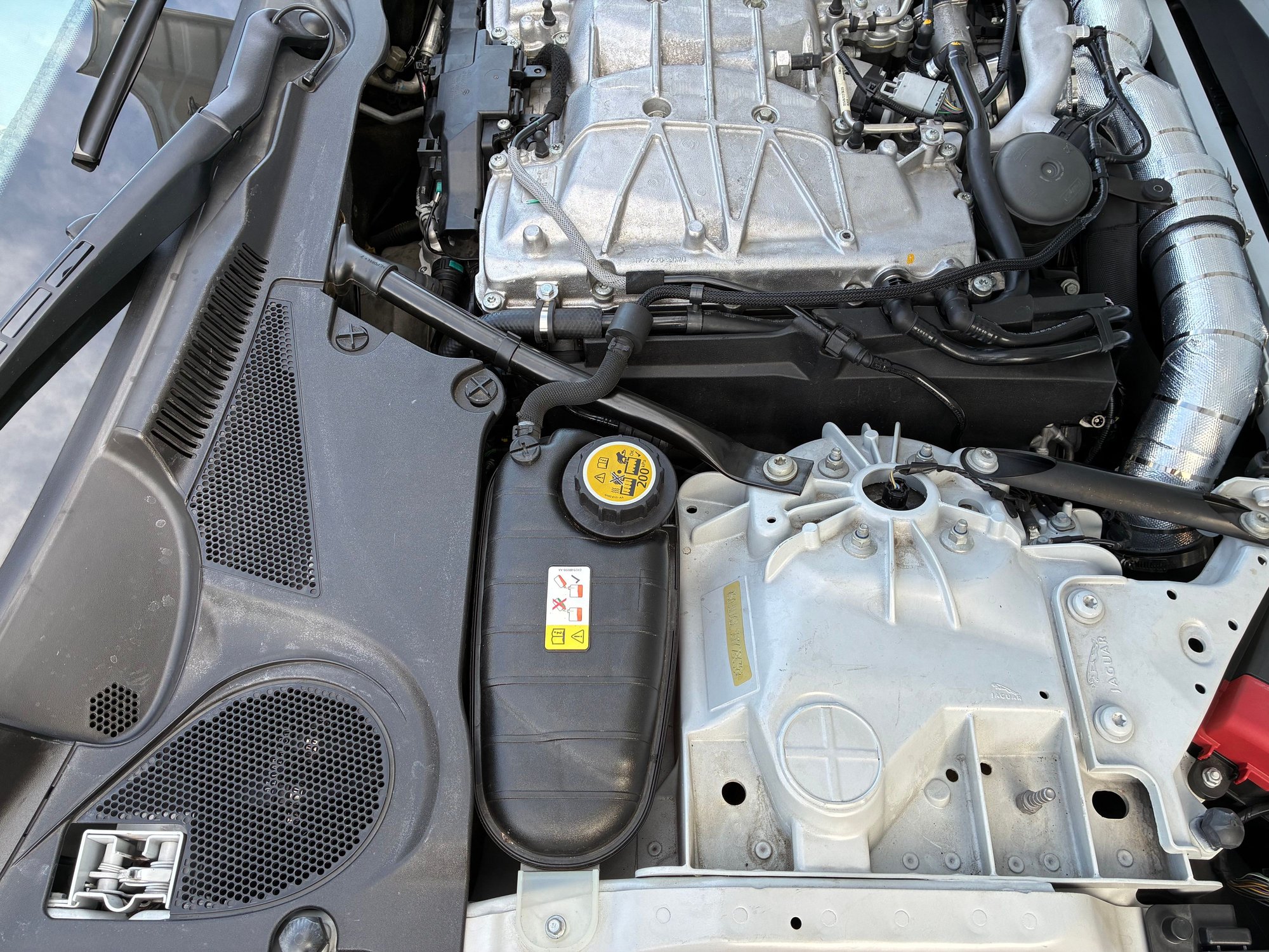

This thread really went down a rabbit hole… haha.

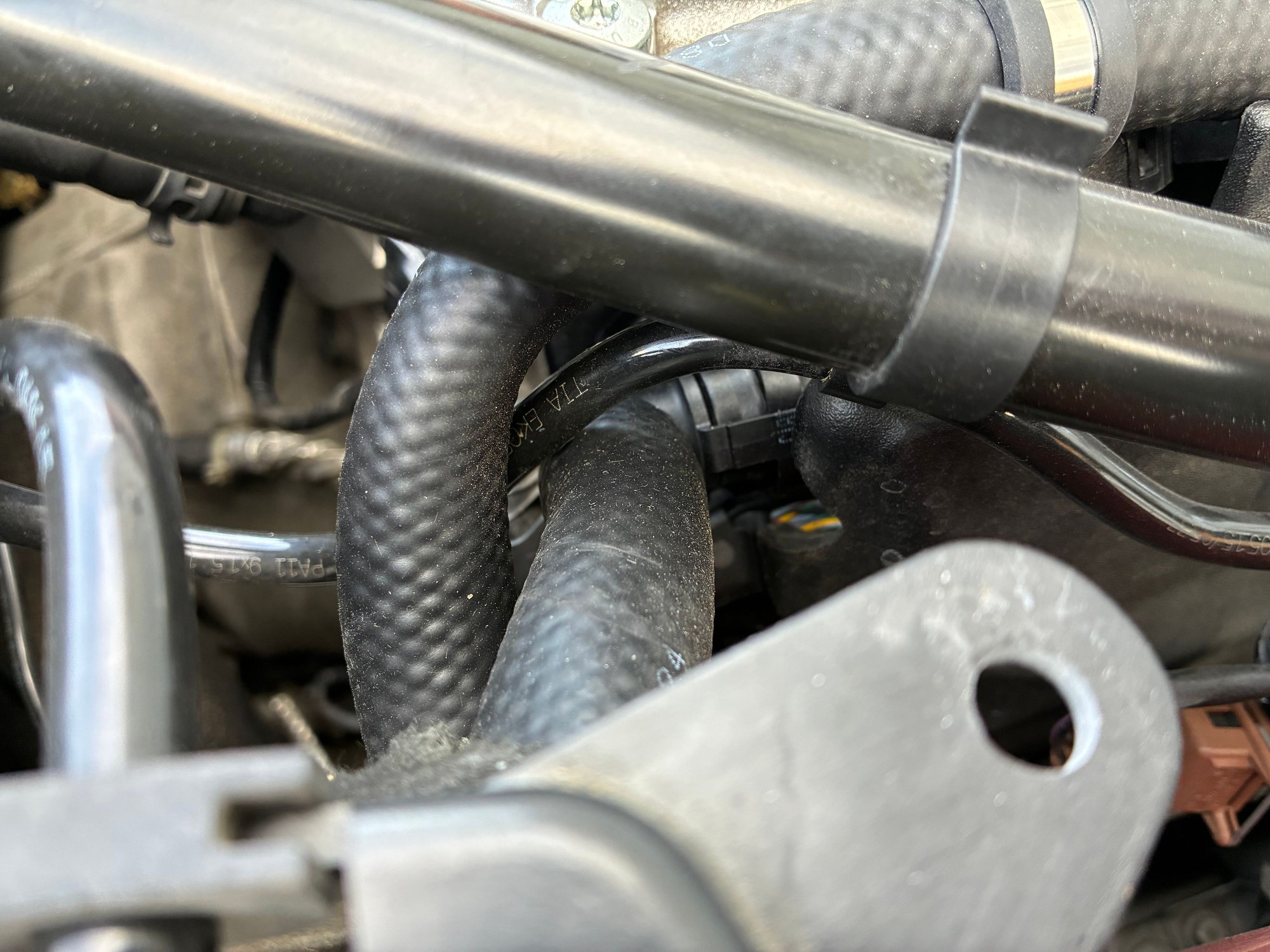

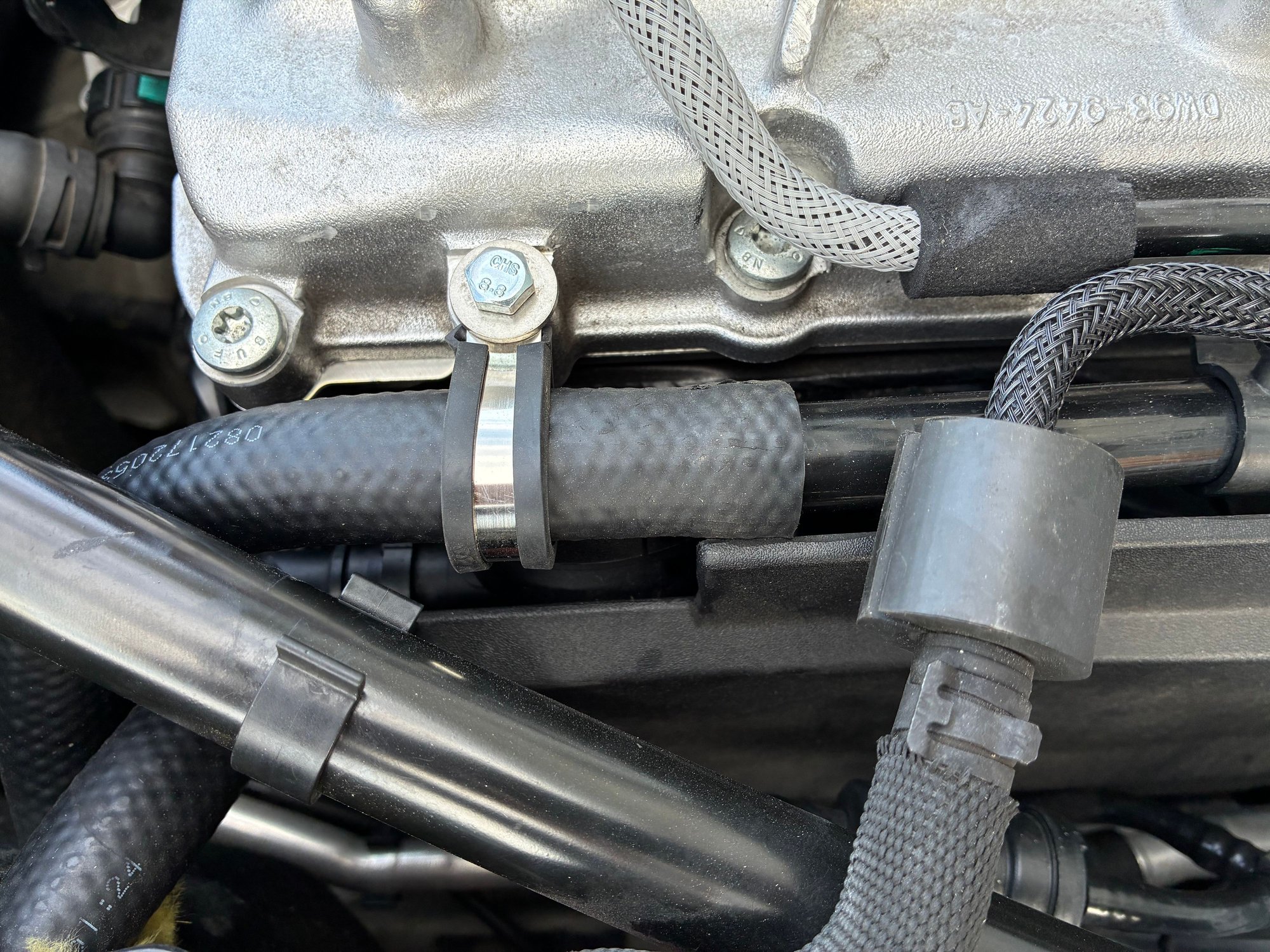

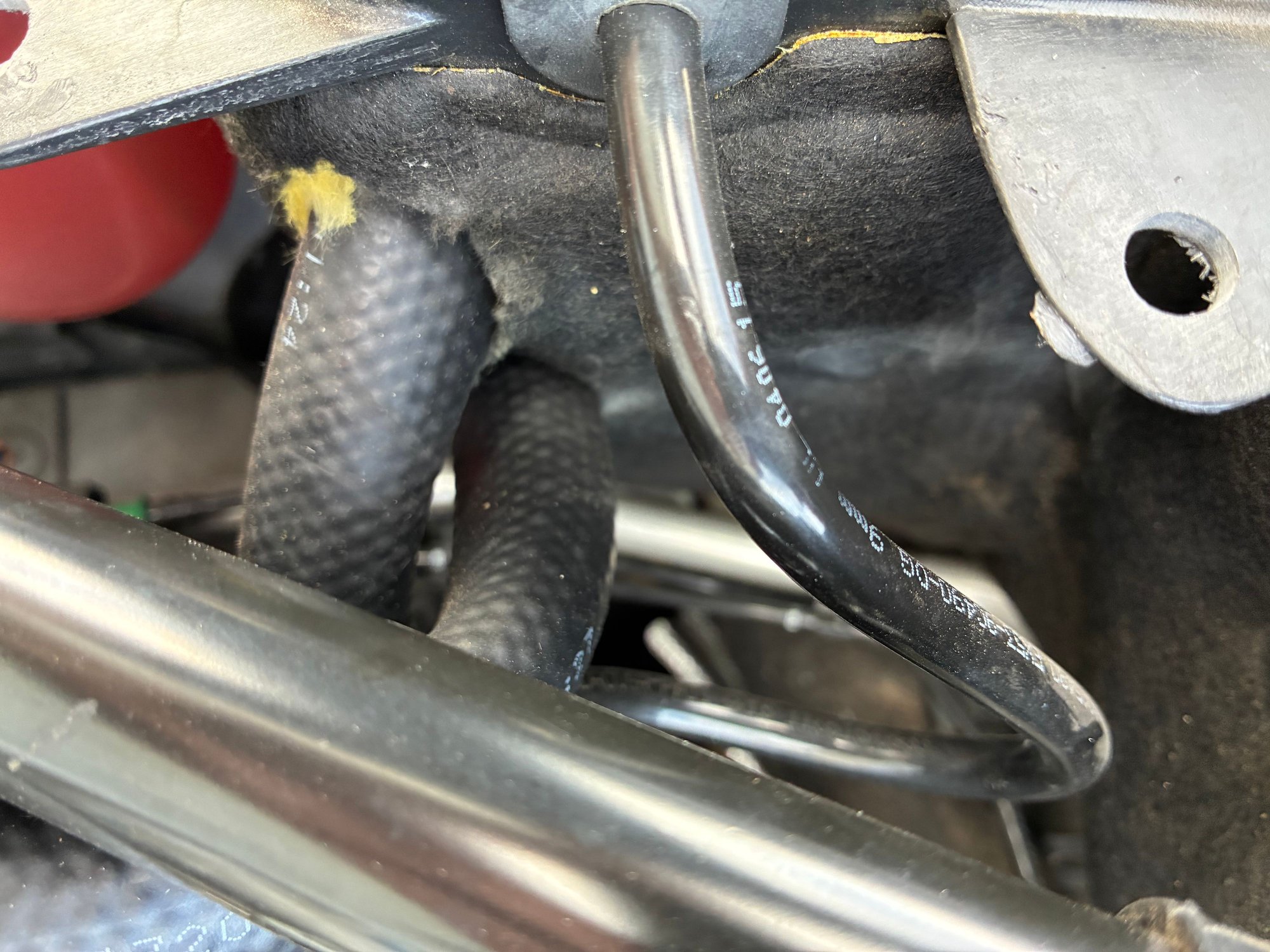

Here’s my catch can set up:
When you open the hood, you can’t tell it’s there.
Tale off the cover, and the catch can is there with enough room to easily run the lines and unscrew the canister when it needs to be emptied. This is the Amazon Evil Energy one. Inexpensive and I prefer this one because of the media “filter” that it has. I put in just enough media to “filter”, but not too much to restrict air flow.
I ran the lines through two holes I drilled in the side of the cowling around the cabin air filter box.
I used 5/8 ID fuel / oil resistant tubing to match the original diameter of the PCV tubing. I then cut the original tubing and used the original fitting to the valve cover and the original tubing to the top of the supercharger snout. I tapped the extra hole in the top of the supercharger lid and used a hose clamp to hold the tubing in place.
I don’t see a downside to this set up. Catch cans don’t completely eliminate oil from getting in the intake, but for these cars, they help cut it down quite a bit.

Thank you again ER9240! Those pictures are exactly what we needed in this thread too.
Yes I am going to follow what ER9240 has done. Probably using the exact same catch can.

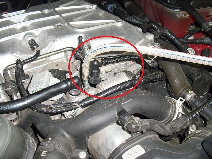

When I do the CRC spray I use this port with a 6'+ hose. So I can sit in the drivers seat and rev the engine as needed. The other end has a bit of smaller diameter hose so the small can spray nozzle is sealed. Preventing engine vacuum from sucking any air around the spray straw.
I have seen other ports used but this one is right into the TB so all 8 cylinders are exposed to the cleaner. Other injection points tend to push the cleaner spray to one or more cylinders unevenly. While this does put the cleaner running thru the blower as well. At idle the SC bypass is closed so the flow bypasses the blower. I followed the can instructions. I sprayed at idle and while revving the engine. Took a while to get the entire can in there.
