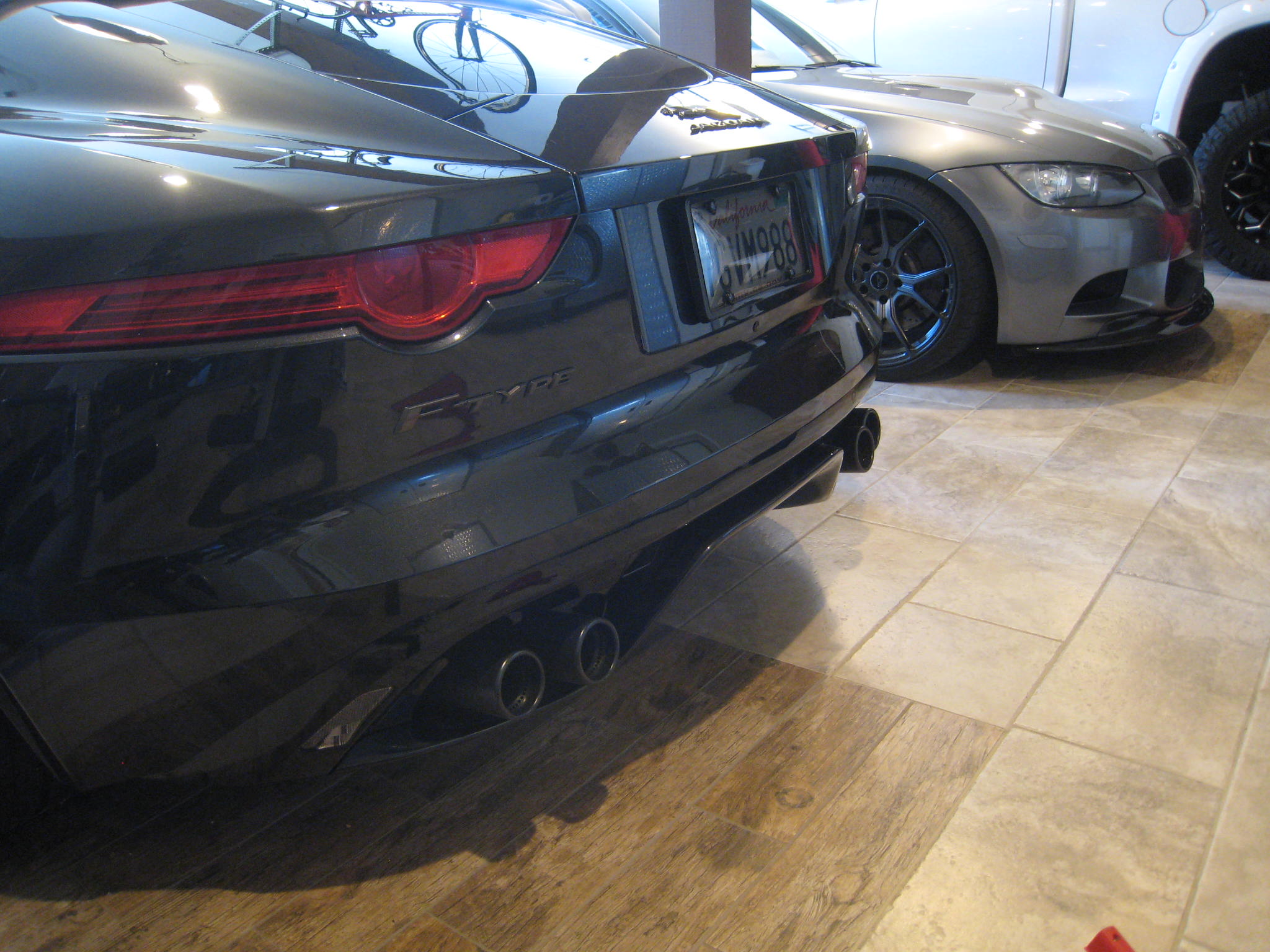

Default They do look just like the vorsteiners
Originally Posted by Lizard
OP: Those wheels are gorgeous.
They are very similar to a set of VFF on my m3.
Are you running on stock suspension?
I've got VFF's on my M3 as well, and that graphite color would look fantastic against the Jag Firesand and other colors. Lightweight and reasonably priced, I wonder if they could be fitted using FR500GT spacer/adapter idea?
Old Aug 26, 2017 | 11:26 AM
  #35
FR500GT's Avatar
Joined: Mar 2017
Posts: 737
Likes: 153
From: Orange County, CA
I don't see why not. You would just have to account for the extra 17mm of clearance but my adapters were custom spec'd to fit Jaguar (rotor side) and BMW (wheel side) so the overall fitment is spot on. I have an extra set of 2 if anyone wants to buy them from me as I ended up only using 2 of them for the rear wheels.

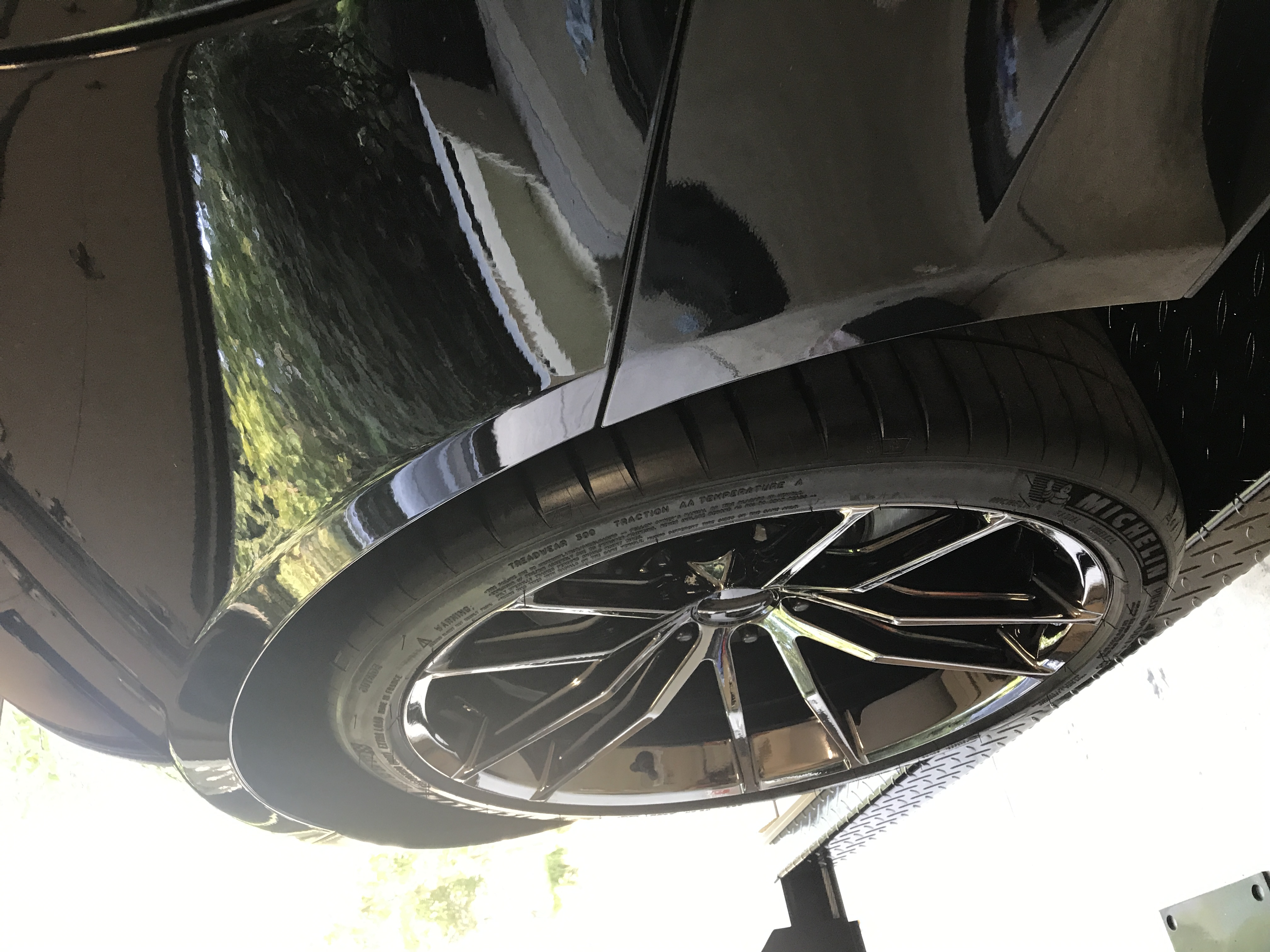

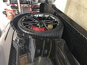

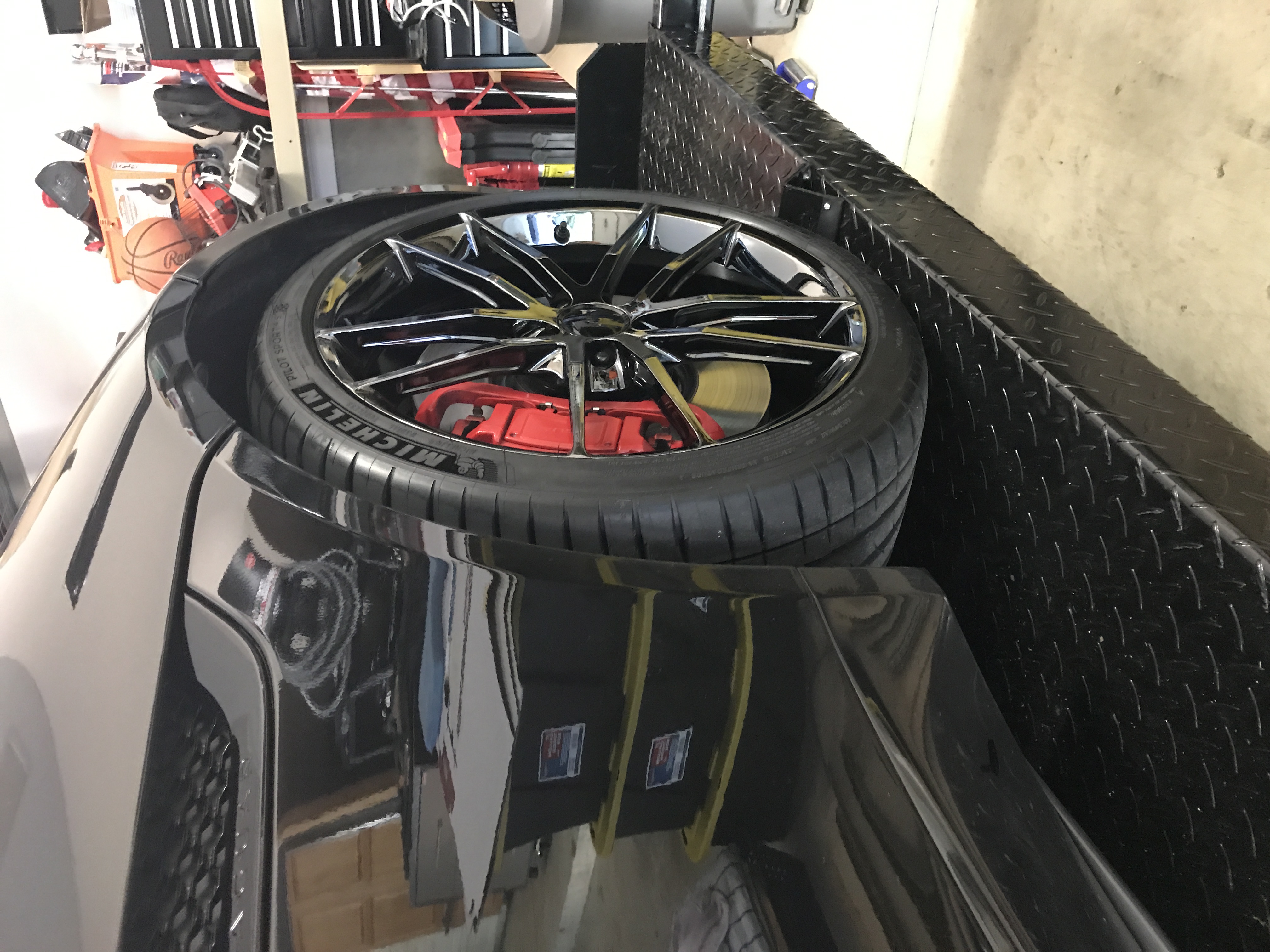

Default New forgeline wheels
I just put these monoblocks on with new mich 4s. They are black chrome or PVD. Sometimes they look chrome, sometimes they look gloss black but they always look good.
Attached Thumbnails Finally got some new wheels on the car-img_0425.jpg   Finally got some new wheels on the car-img_0426.jpg   Finally got some new wheels on the car-img_0420.jpg
Old Aug 26, 2017 | 05:35 PM
  #37
Dew1551's Avatar
Joined: Jul 2013
Posts: 12
From: USA
Default New wheels
These are forgeline VX-1
