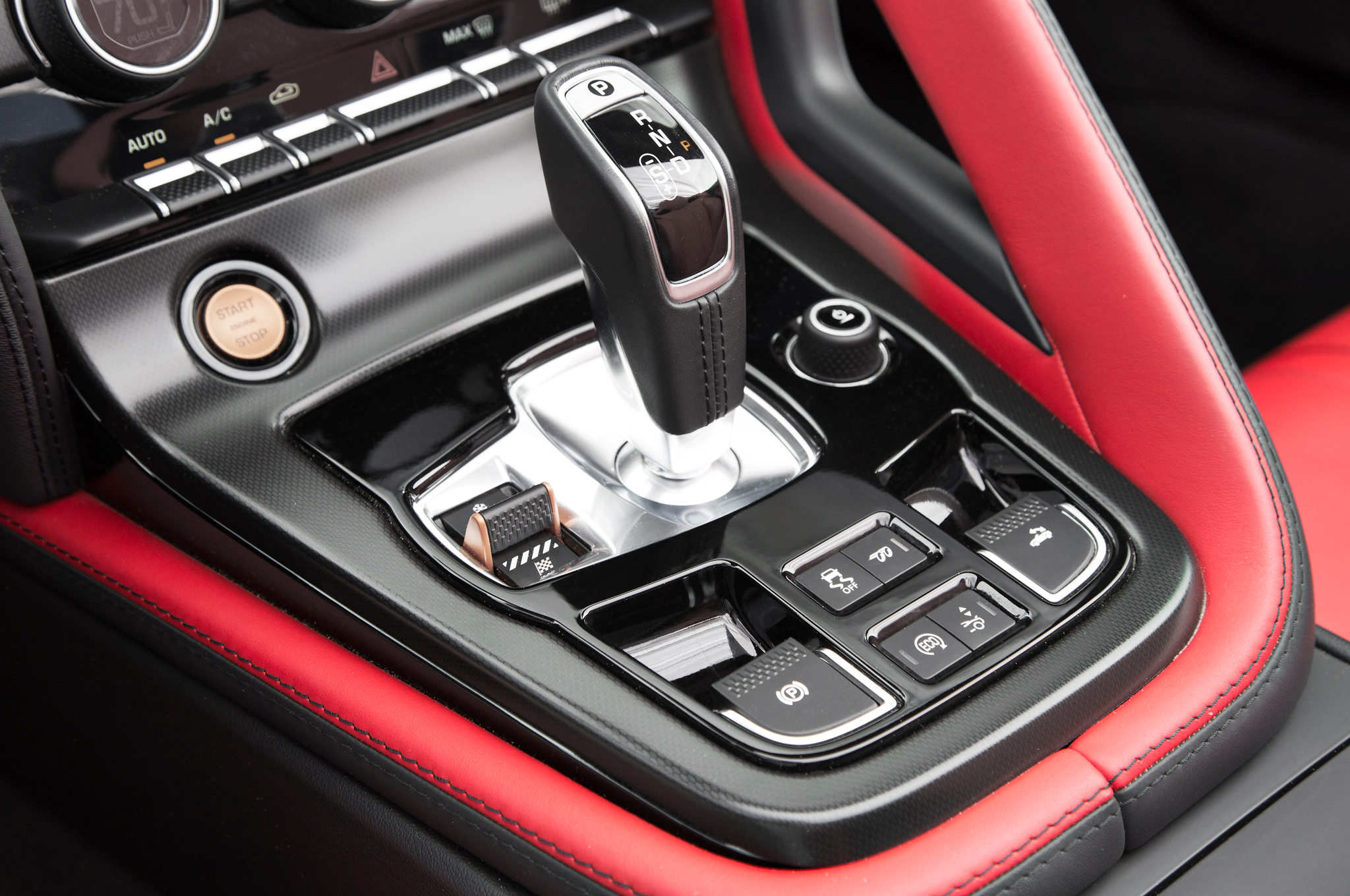

Hi Simon,
I know you mentioned not wanting a toggle switch, but as your profile picture shows a coupe you could fit the folding roof switch in place of the blank coin holder and use that to trigger a latching relay to toggle between front and rear cameras. The OEM roof switch has arrows on it do it doesn't look out of place for its new purpose. I fitted the switch when fitting birds eye cameras to my car so it toggles between the OEM rear and top-down camera views.
There is a small coax/FAKRA connector almost directly underneath those switches which you can switch your own video signal in and have it used in place of the OEM reverse camera. Activation would be the same as before (on reverse, or via the P button then Camera).
The centre console photo below is not mine (I just searched for one) but it shows the switch.
The other photos are mine and show where I mounted the cameras. The front camera was mounted to the bottom lip of the grill surround. I have a front plate so it is not visible at all from standing height, but you could mount a flush mounting camera in one of the grill holes. For just a front-facing view that would be fine, but if you were fitting a top-down system you would need to mount forward enough to clear the front spoiler.
