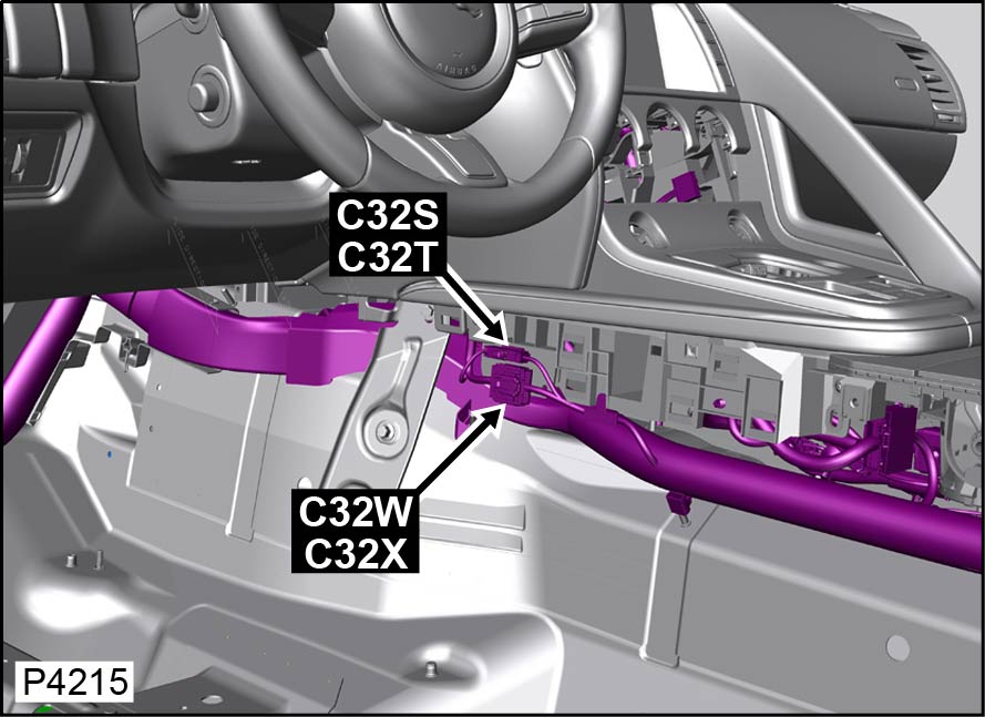

Sadly there is no P circuit switch - the entire button panel is self contained and generates control messages sent over the vehicle's MS CAN network.
There is no automatic override to change the video signal, you need to run the correct app on the touch screen OS which is only activated when:
1) the vehicle is put in reverse, and/or
2) the P button is pressed and then the Camera soft button is pressed.
The app is loaded based on certain control messages being received over the MS CAN network so it cannot be triggered with a hard wired solution.
I forget which sex is which on the downstream connector (C32S/T), but yes you can easily feed your own video signal in at that point. That is easier than directly behind the touch screen as you can route your new cable to the void between the seats which is a handy place to put any extra modules, etc. FAKRA Z keying (turquoise) will fit all other FAKRA keys. I also forget which video format is required as it was some time ago when I worked with mine. You need to be careful with the voltage used though, it is probably using 5V.
If you fit the OEM roof switch (£50) plus a suitable wide angle camera (£100 for a good one, cheaper will work but might not be a good resolution) and an automotive rated* latching relay (£10) you can do it for much less than the nav-tv module. Their module sits on the MS CAN network and reads/sends the control messages to function - with the OEM camera (or by enabling it via the CCF) you don't need that level of functionality just to get a camera image working.
* Should be rated for -10C to around 80C
(It is worth noting that I have only worked with the pre-2016 cars using the IAM-based infotainment systems. Those using the media gateway (newer Ethernet infotainment) may not function in the same way.)
