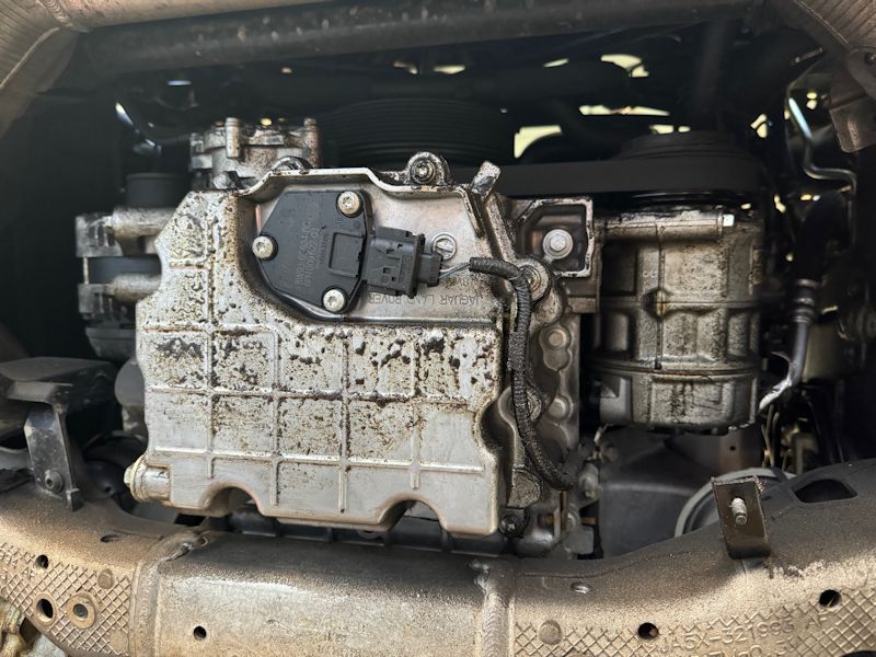

I realize this is an old thread, but I'm having the same issue with low coolant. I recently started getting the low coolant message. My F-Type is a 2017 V6 S. The odd thing is that there has been no smell and not a drop on the ground. The level in the reservoir is definitely low. I jacked up the car and discovered that the rock shield under the engine was wet. So, I removed it. This is what was revealed.
Would it make sense that a leaking water pump would result in such a mess? Or, is this mess possibly the result of another issue?

If the problem is not the water pump, and if you have not (yet) replaced the original plastic coolant pipes (3 of them, two at the front of the engine, one at the rear) you should do this now. The original pipes tended to leak at the seams. The revised design eliminates the seams on the front pipes, but there are now aluminum pipes for all three items. The pipe failure is a “when” not an “if”, so proactive replacement is advisable. You do not want the engine to overheat!

From the looks of things, I'd guess the water pump, but it could also be the cooling pipes. Regardless, get a set of the aluminum pipes (many sources, including Amazon), and replace them while you're in there. The parts are cheap, but the labor to get to them (or the water pump) is a pain - you have to remove the supercharger. Don't set yourself up to go through it twice. In the meantime, while you're taking delivery on the new pipes, keep an eye on the fluid level and - especially - your engine temp. If the temperature starts rising above normal, shut down promptly. If it really is a slow leak, you won't have a problem, but you don't want to be careless and fry your engine.
I have a set of the aluminum pipes on the shelf for eventual use. The MY14 is still going strong with the originals. The MY17 pipes started to leak under warranty, but before the aluminum ones became available, so it now has the newer plastic design. There doesn't seem to be a problem with the new version (which is all your dealer will have), but I like the metal ones.
