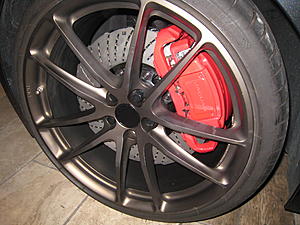

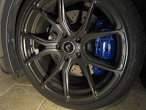

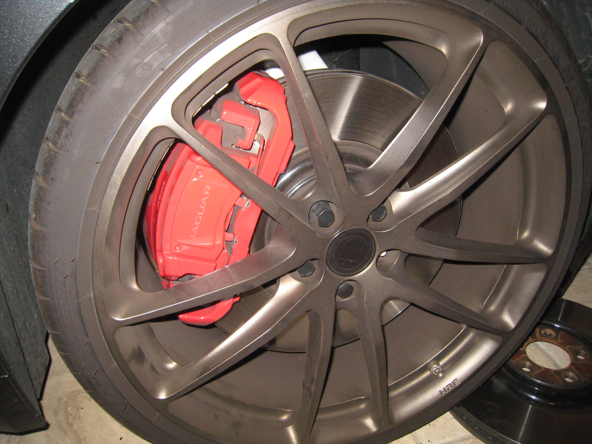

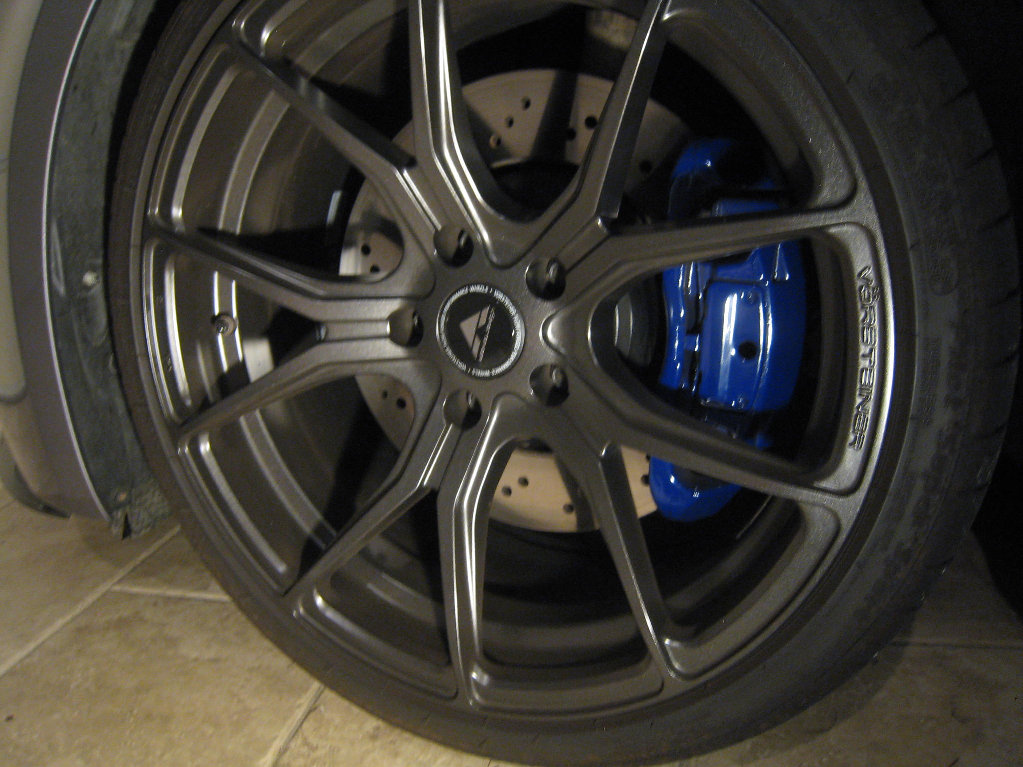

Default Got the fronts on, quick before and after pic
I'm very happy with the look, these new rotors make the factory ones look silly. See before and after pics.
FWIW, LPI racing which sold me the Porterfield RS-4 pads for my E90 M3 suggested a minimal bedding procedure (perhaps a few 80MPH to 40MPH runs followed by a cool down) or none at all - just drive it like an economy car for first 100 miles. They said the few problems they have seen are from over-zealous bedding procedures that ruined the pads.
On my M3, I went no bedding and they have been fantastic. The initial bite is a little less than OEM, but total braking power was unaffected. What I did notice was 75% less brake dust. Photos of calipers/rotors after 3000+ miles on them - I've rinsed wheels and calipers a couple times, but no attempt to clean beyond that. Still look great.
RS-4's are a street pad, there are others for the track. However, I'm looking forward to the greatly reduced brake dust for the F type, the OEM pads were ridiculous.
Attached Thumbnails Group buy: 2pc wortec rotors for steel super brakes on f-type-img_5659.jpg   Group buy: 2pc wortec rotors for steel super brakes on f-type-img_5660.jpg   Group buy: 2pc wortec rotors for steel super brakes on f-type-img_5674.jpg
