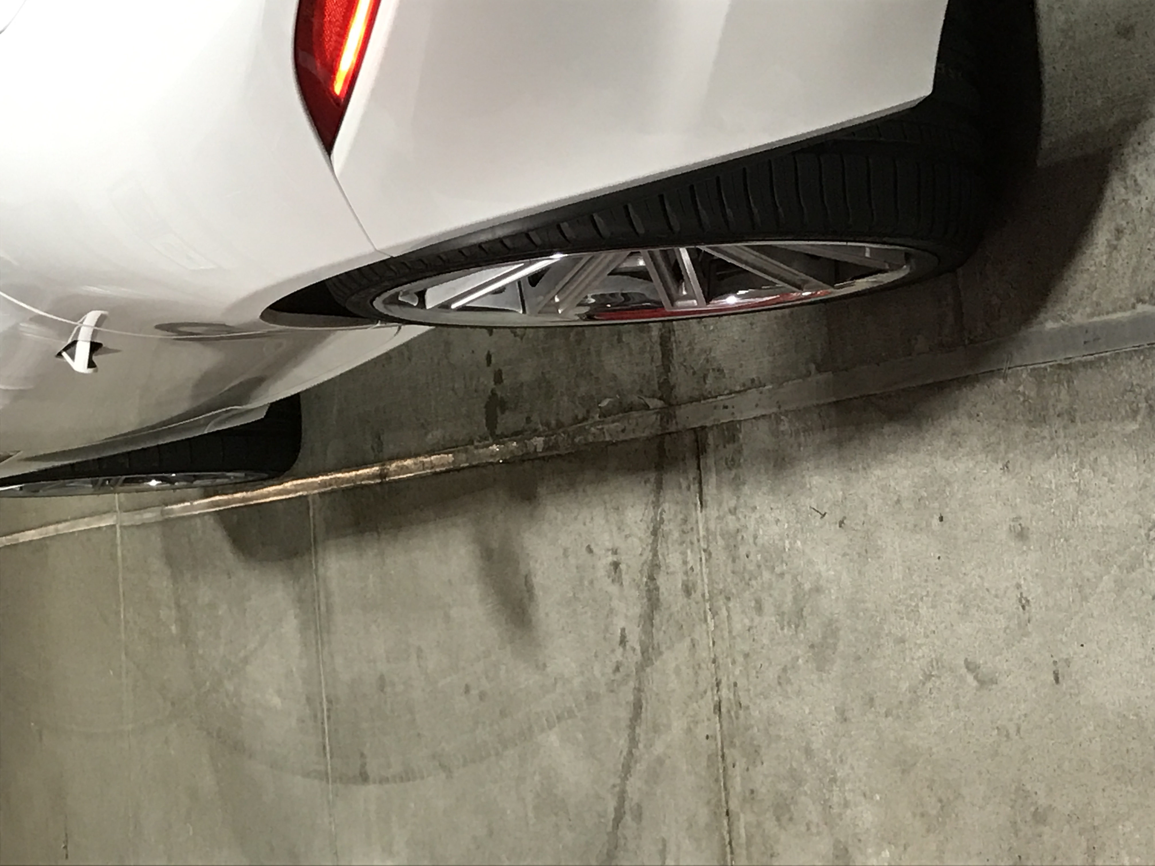

Finally installed these. Makes a big difference in the look. I did not like walking up to my car and the wheel sitting so far in. The first is before and the last two are afterwards

Absolutely! So much nicer. Nice install there.

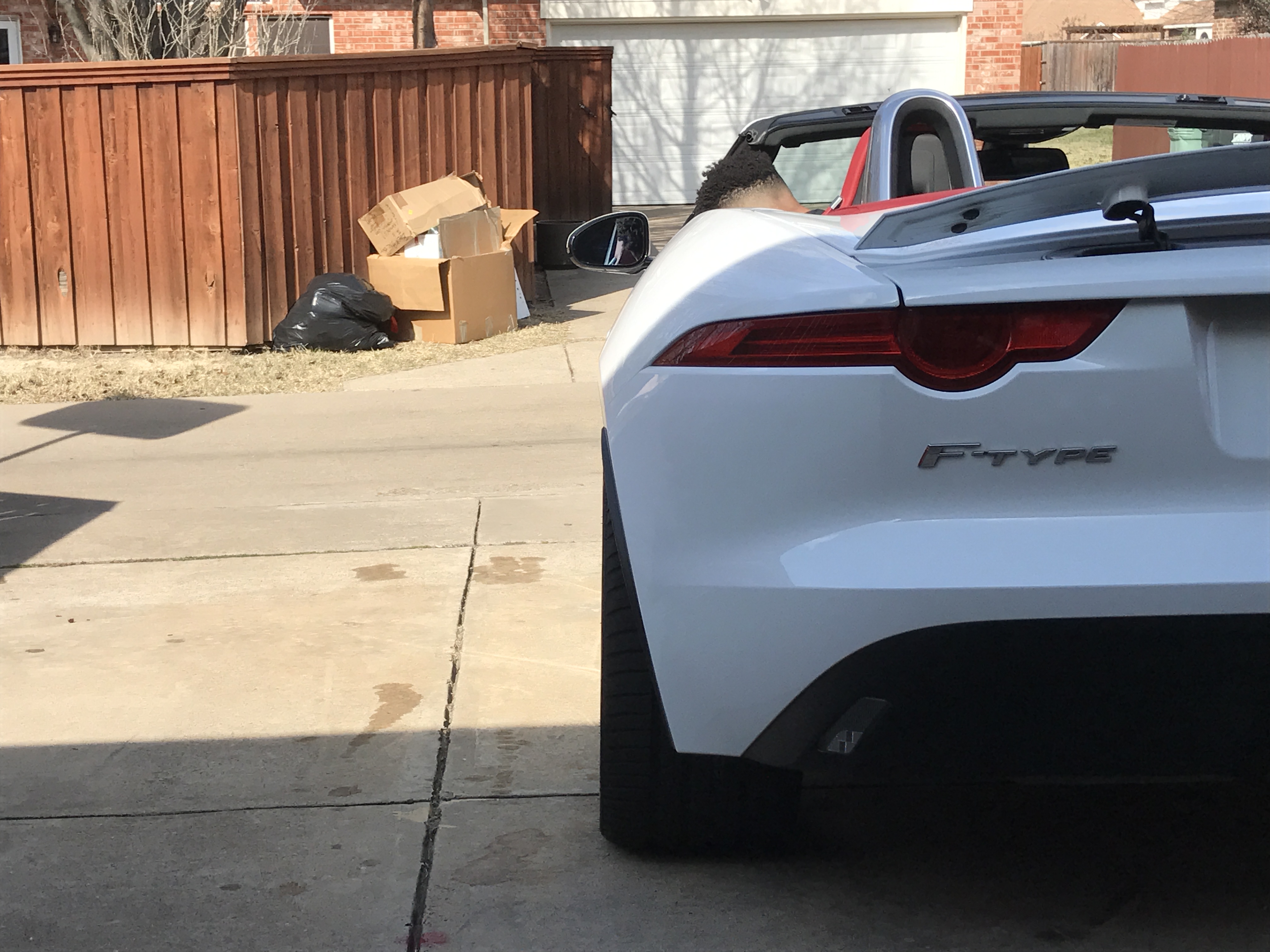

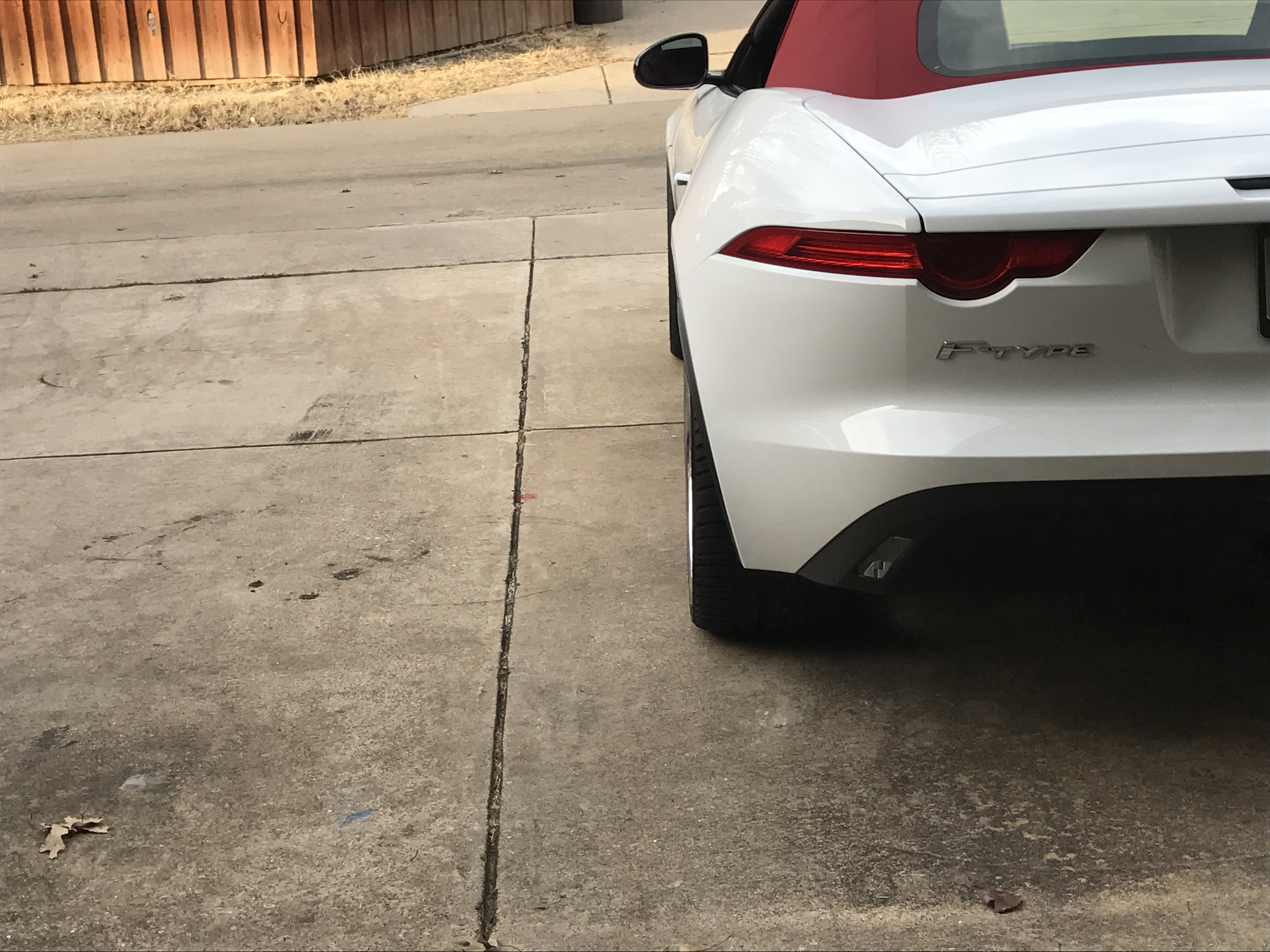

Can you take a side shot. Id like to see the wheel gap with the fender. Unless you lowered it. Thanks
No lowering done. The rims are 21x10.5, 45mm offset, with 295/25/21 tires in the rear.
Attached Thumbnails Group Buy: (4) 17mm hubcentric adapters/spacers-img_0555.jpg   Group Buy: (4) 17mm hubcentric adapters/spacers-img_0557.jpg

Well as you and I have identical colour schemes this is helpful thanks. I've had my 17mm spacers from is buy for a few months and have just not gotten around to putting them on because I need to spend the time grinding down the studs. In the interim I've been debating how I would like the new look. Now I know...it's pretty good!
