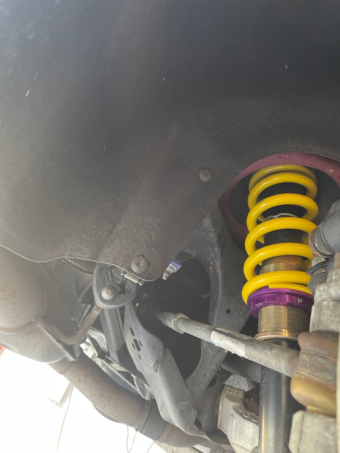

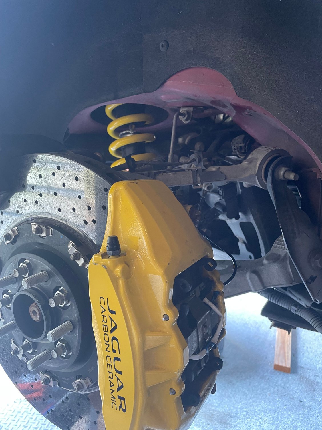

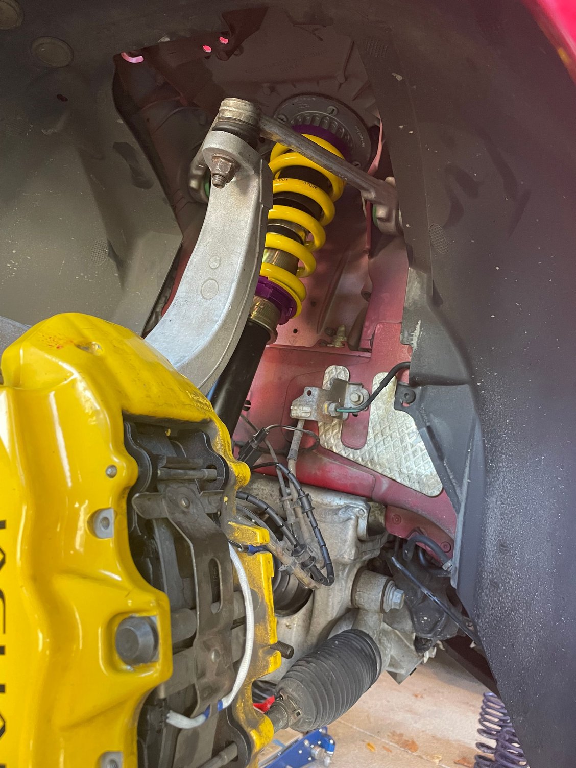

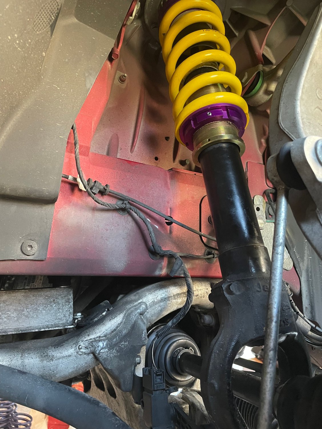

KW springs look very nice and I have used KW on previous cars. Fully height adjustable. I don't know why the car was so low on the H&R springs, but it also has spacers, and I was rubbing very badly on any decent sized bump. Hopefully raising it a bit with the KW's will be sufficient, if not I will need to remove the spacers or use thinner ones. https://www.kwsuspensions.com/produc...-25331005.html

Since the H&R were in already when I bought the car, installing the KW kit was very easy (no need for a spring compressor). You do end up removing ALL the OEM parts for the KW kit. If you do go with it, it is highly recommended to coat the threads with anti-seize so that you can make adjustments over time. Probably a good idea to put some on the interface between the bottom piece and the disc on top of it (bottom of the springs) as well.
I think the ride is better than the H&R (I never had the stock springs) - softer on small bumps, but it stiffens up quickly when needed. I don't have any photos at this time, but since they are adjustable, you can pick the ride height you want.

Here are some shots of the KWs installed. Still dialing in the ride height, and as you can see, I have tons of adjustment to go up or down. Right now I think I am very close, with the rear adjusted so it doesn't bottom out, and the front a bit lower to give the car some rake (and it doesn't bottom out up front either).

To really set up the car correctly it should be corner weighed. As it is, it's unknown how much weight is on each tire due to the differing spring seat positions.
