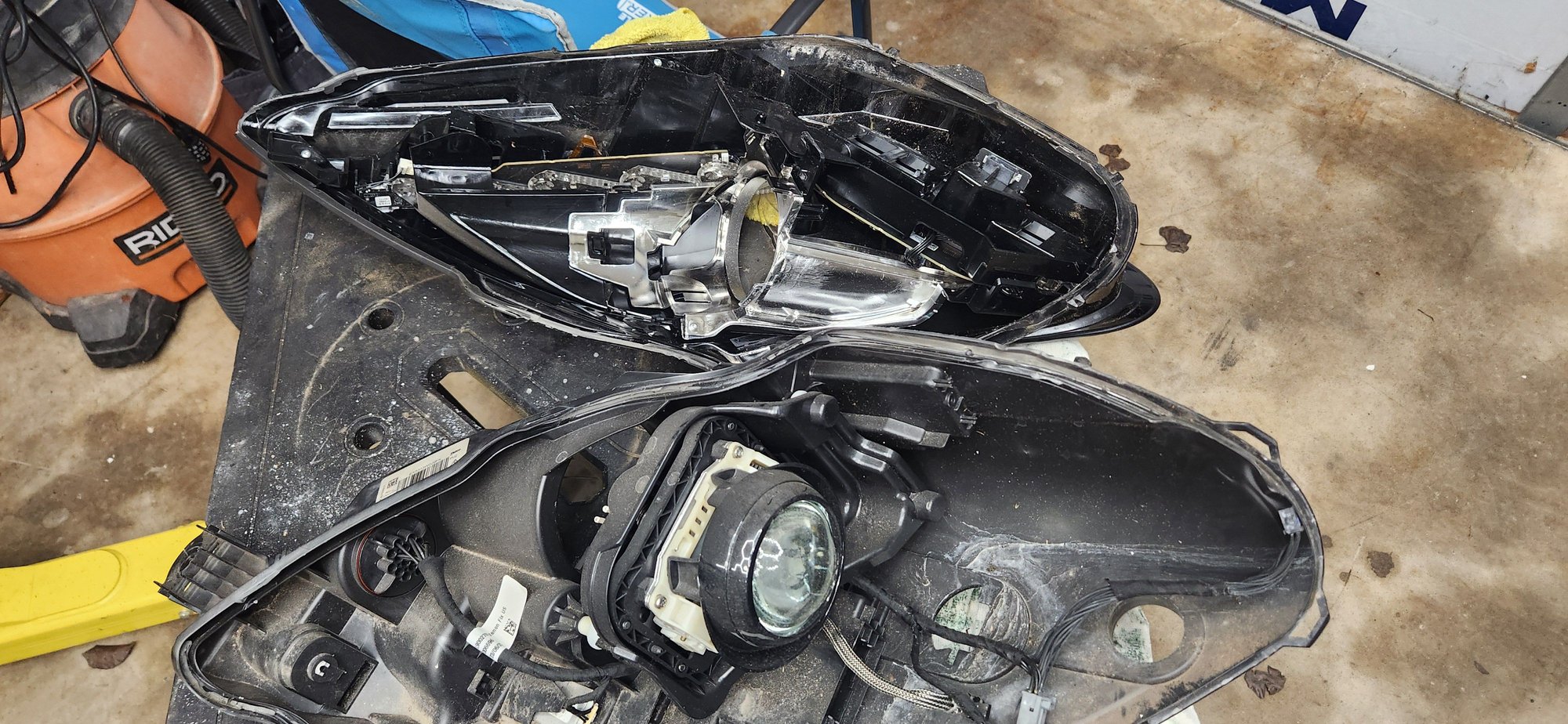

I had another project where I am going to need to take apart and reseal a headlight so I decided to try it on the uber hard to do F type assembly first of course.
Oven at 220 for 20 minutes and then a lot of force. The adhesive wasn't really flimsy like most videos I have seen, but it was able to be removed. You have to be careful with prying as the headlight shell plastic gets softer than the lens and adhesive. Once apart it looks like the reinstall wouldn't be too bad. I have one of my replacement lights that is starting to microfracture so this might be back on the table.

Thanks for the instructions as we have not seen anyone get this done successfully.
I would interested in hearing how the re-assembly goes too?
