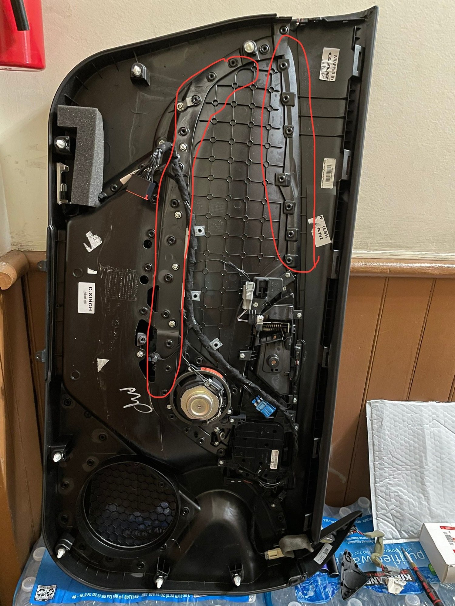

Would like to remove the window switch control trim on both the driver + passenger side so i can wrap it in carbon fiber on my 2014 F type (V8). Ive tried removing the entire door panel and looking at the back of it to see if theres a way to remove it but looks like its tucked in there pretty good. Does anyone know an easy way to remove the entire trim piece? This is the trim that sits on top of the window switch control and the side mirror control. Thanks!

heres a picture of the piece i need to remove:

First get yourself a copy of the F-Type V6 Workshop Manual here: https://www.dropbox.com/s/d52ciochjn...anual.pdf?dl=0
Then go to page 20512 for the door panel removal procedure.
Then go to page 20517 for the window switch panel removal details.
The whole door panel needs to come off before you can remove the window switch panel.

thank you very much! looks like i was about 95% there, just needed to remove all 14 of those screws to get that arm piece off. thanks again!!

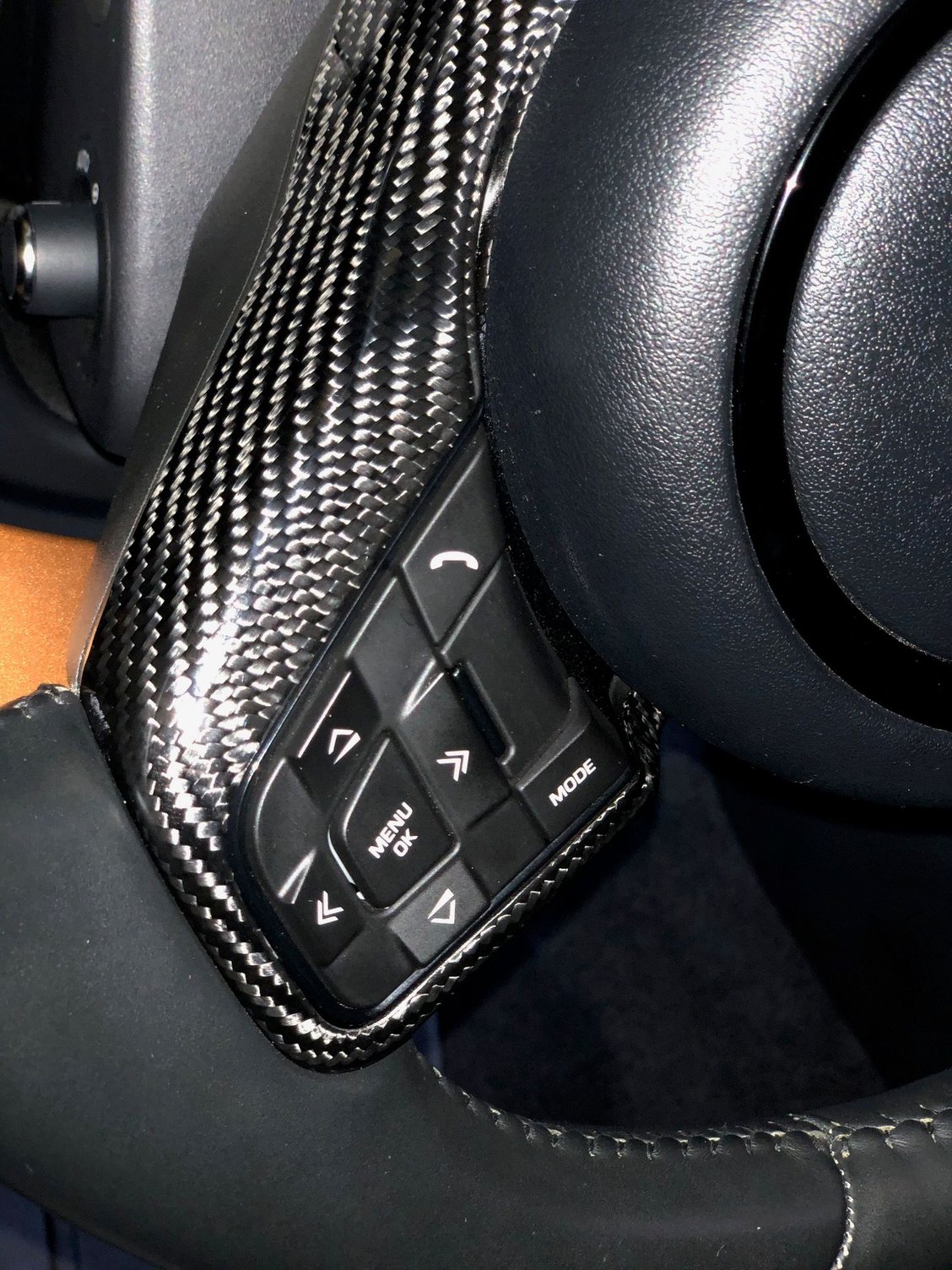

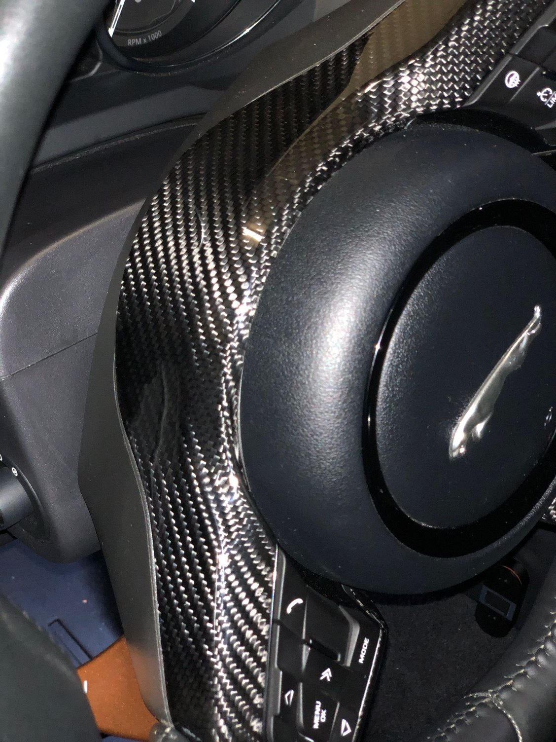

I have just purchased two items. Currently I am trying to work out a package discount. These parts are all made by Koshi Group. I have currently installed the Center Side Trim and the Steering Wheel Trim. I have included a couple of pictures but the lighting is not that good. Hope this helps. I think the quality and fit are exceptional.

Looks good Ben. I got several Koshi pieces from a guy that never installed them before he sold his car. Turned out to be a great package discount for me!. Haven't been home to fit them yet though. Do they have adhesive on them already, or did you have to add your own?

I have only installed two of the items as seen above and no adhesive needed. I am planning to do more and trying to work out a package deal from a couple of retailers. Buying them directly from Koshi is more expensive. Real easy to install.

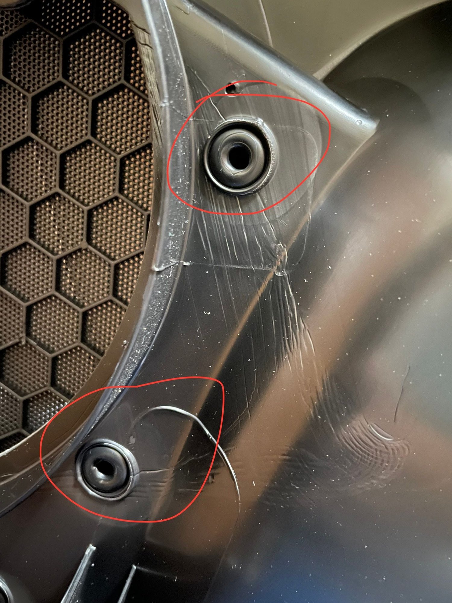

Does anyone know what are these fittings and how are they removed and if they are reinstallable?
I’m trying to remove the speaker grilles(painting) and the leather piece by the door grab (glue behind has failed on both side and the leather is lifting).

Looks like plastic heat stakes to me. You could break them and glue back together if that is the case, but will never get as strong as the OEM connection again.
