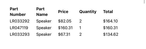

Credit to the main audio upgrade planning thread, apologize i do not remember exactly who posted this.
You need 2 each, price listed are new and is pretty close to what i paid brand new from jlr dealership(us).
Used parts are about half the price but can be hard to find.
I got mid and mid bass from the list new from jlr, and bought used tweeter AW93-18808-AC from eBay, did not find this list before i ordered them!
Not sure if they are exact counter part but tweeter was never the
problem, in fact they are too bright i have the treble set almost all the way to the left.
Lemme know if you need more info, I’m no expert but i have read all the threads😂
Oh if you know someone in a body shop they can order it without tax, which is what i did.

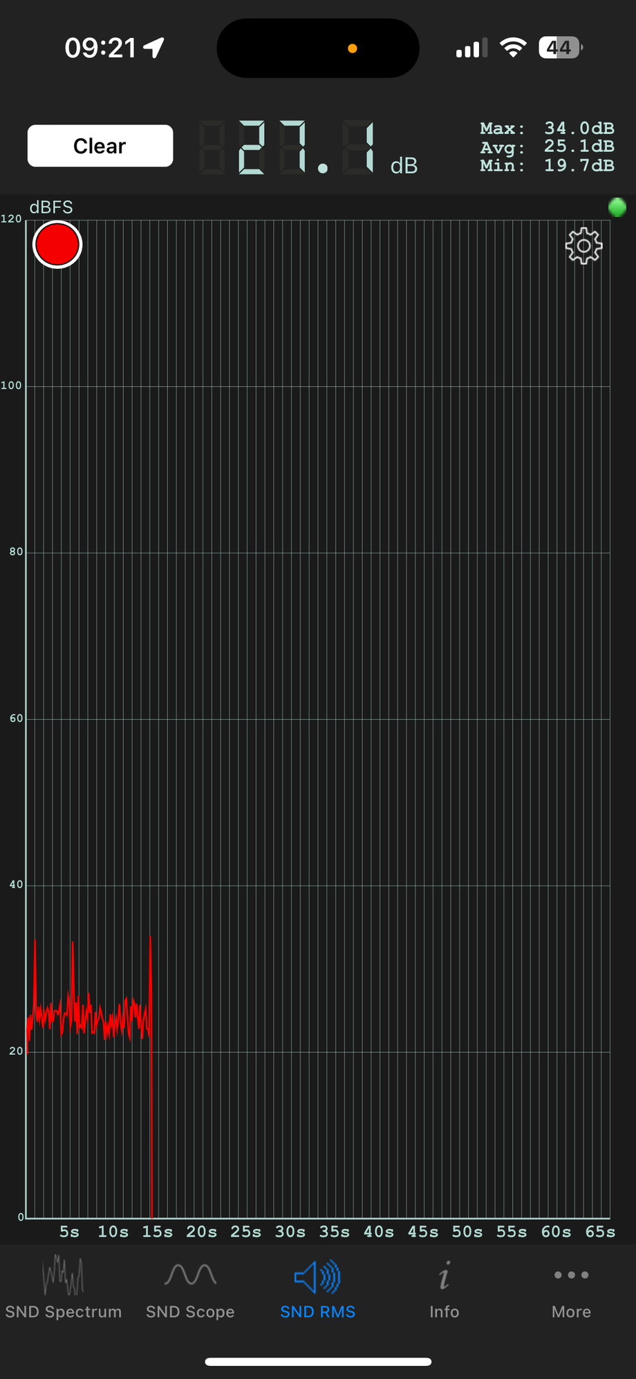

I might have figured out what’s wrong, the tweeters.
Everything linked together after watching a random YouTube video showing the difference between a good and a blown tweeter on a otherwise good bookshelf system.
Thinking of it, the tweeters are the only pieces i got used on the doors.
center channel was also a used part, and at least 1 out of the 3 i bought was bad.
There was (or still is) a issue with the f type coupe sending bass to tweeters and blowing them in the process, my car might not have this addressed.
Lastly in stereo mode, i put my ear right next to the tweeter, they are working but sounds tiny, in contrast to the surround mode, the sound immediately brightens up and sounds “normal”, i haven’t tried putting my ear on the center channel, it’s probably not gonna fit ;p
it also conveniently explains why i feel the sounds are coming from waist level in stereo mode, the tweeters aren’t doing much!
so.. is there any way to check if the problem is software or hardware, or both, before i order new parts?
i just finished insulating and felt tapping the whole car, and the new founded quietness makes the flaw in the system ever more prominent.
tl;dr
how do you check if the tweeters are blown?
How do you check if the bass to tweeter tsb has been applied?

Some folks have used an audio frequency generator app on their phones, connect via Bluetooth, then sweep the frequency.
Old May 27, 2024 | 08:21 AM
Ray Ray's Avatar
Joined: Dec 2019
Posts: 666
Likes: 184
From: NYC
something like this? What an i looking for though, missing frequency on the high end?
wait no, that’s a scanner, lemme google it. Thanks!
Is the generator any different than playing a sine sweep on YouTube?
