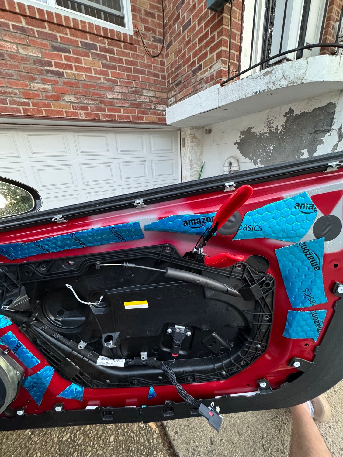

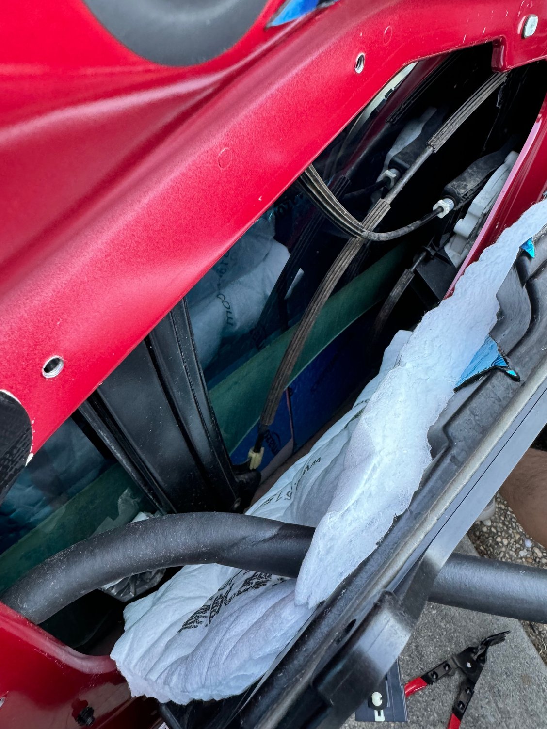

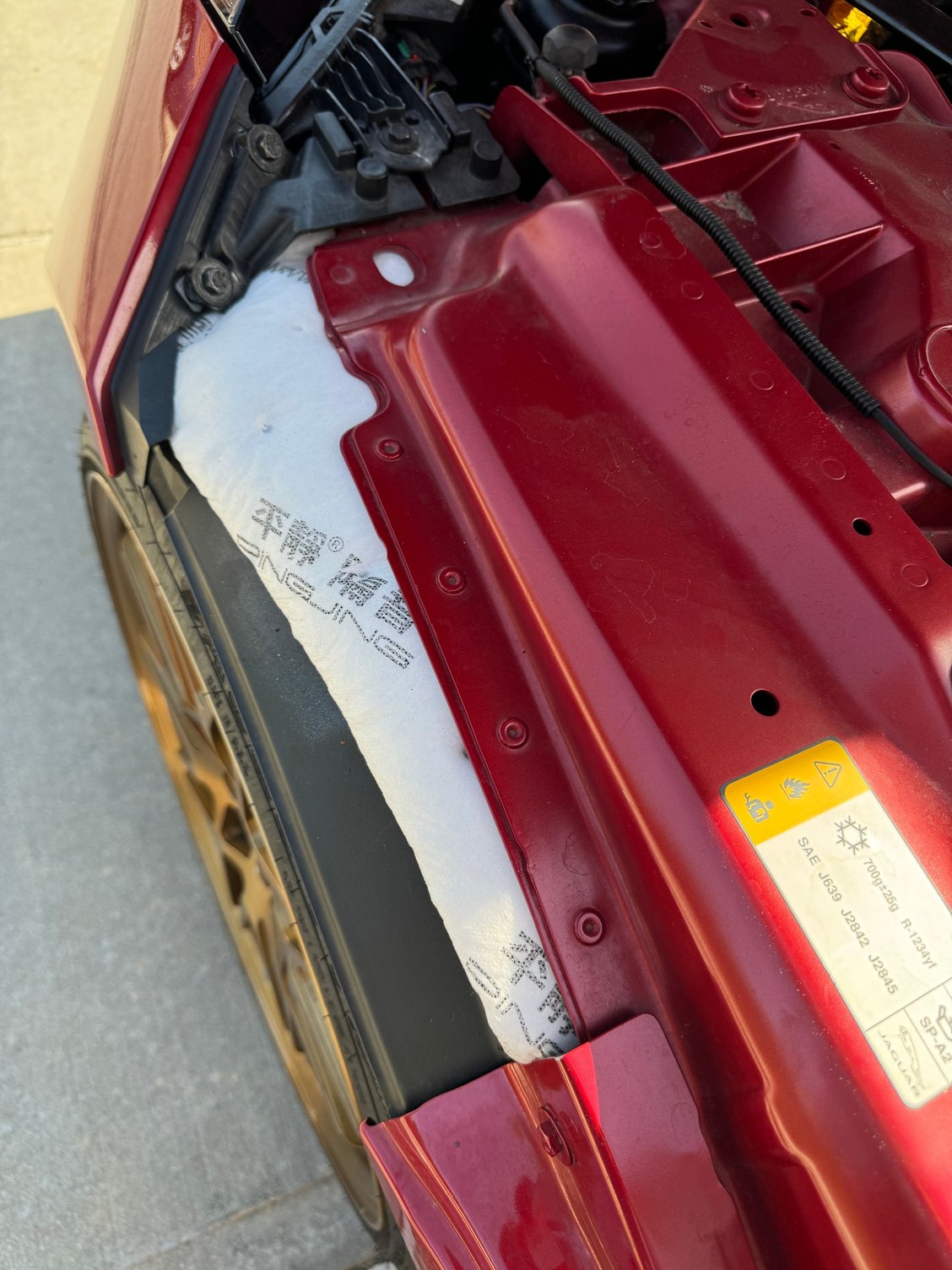

edit: wait no, there was another one for amp having the wrong file causing tweeter problem (coupe only), the car no longer rattles and buzzes after all the felt tapping, sound deadening and proofing.
