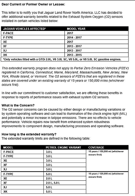

Oxygen sensors for the AJ133/AJ126 are covered by the JLR Emissions Warranty for 10 years/150,000 miles in the US.
Wow, great to know! I am thankful I came across this forum thread/posts while researching O2 sensor replacement info. I was gearing up to replace it myself. I've got a 2016 F-Type S (V6) I bought back in July 2024 and my CEL/DTC/MIL came on in January. It's a low mileage car at over 34k miles now. I was shocked when I little baffled when I pulled a H02S Heater Control Circuit Bank 1 Sensor 3 code.

Yeah, about that... you can buy the sensor (which isn't magic, it's a Bosch part) for roughly $100. See this, https://youtu.be/uRQBTNAacNw
I watched this Skrrt Garage video earlier! You know what's ironic about this video? This (awesome) dude probably had no idea, like me until tonight perusing this forum thread, that JLR issued an extended exhaust oxygen sensor repair/replacement warranty for 10 years for the S/C 5.0L V8 and 15 years for the 3.0L V6. 🙃🤓

Call and ask your JLR dealer about the extended warranty on O2 Sensor replacements.
