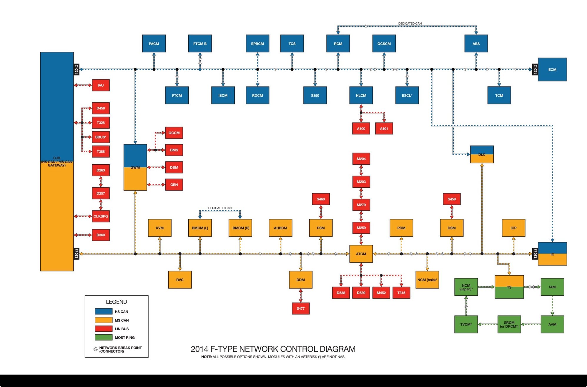

And here’s a diagram of the vehicle networks. If you look carefully, it shows breakpoints (connectors) in the buses. I’m guessing that chassis control module == body control module, which is part of the CJB (Central Junction Box.) The document spells out all the acronyms below.
https://www.dropbox.com/scl/fi/r5j5t...=2ueb1pp3&dl=0

I'm not terribly worried about the individual codes at this time. I want to figure out they are always intermittent. To me it means there is most likely a can-bus problem that needs to be addressed.
