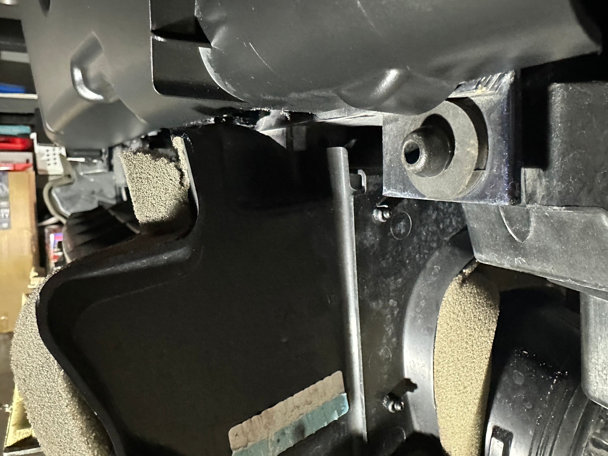

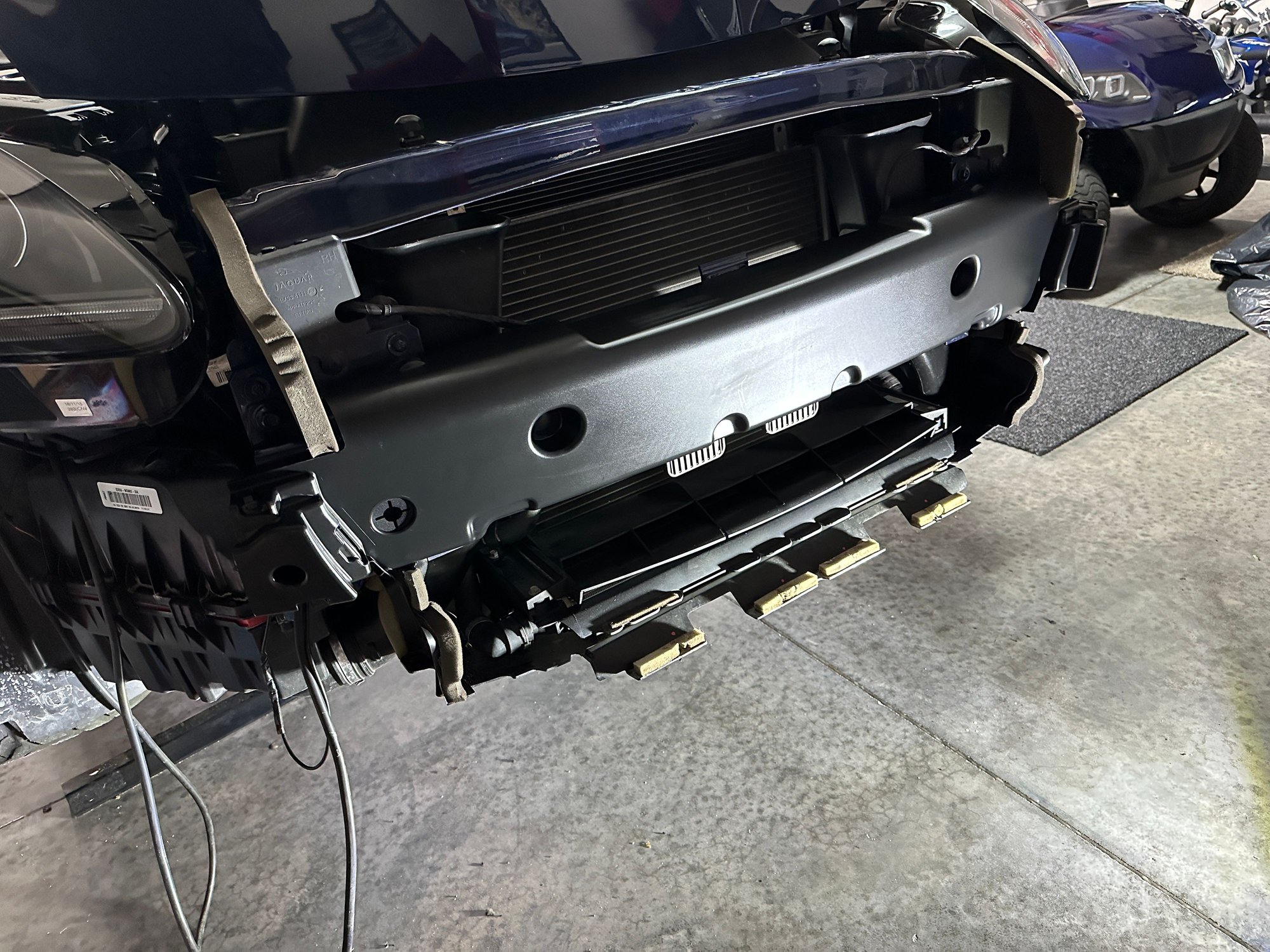

So as it turns out, the 2021-2023 Jaguar F-type uses the same front impact bar that the previous generation uses. The part number is T2R58458. For the Project 7, they actually used a different front impact bar, as the tow hook was in a slightly different location. Those are nearly impossible to find, but that part number is T2R18829 in case anyone ever wanted to go on the hunt. What I just learned however is because the 2021 and later F-Types now have an open grill design, JLR created a plastic cover that attached to the impact bar. In theory, this should also work for the 14-20 models using the same clip in design. Understandably, the cost to buy and add this might make some just rather paint or wrap the impact bar, but if you wanted a more OEM look, here is the part number that should snap in (and align to the existing tow hook hole, even though it would not be accessible through the Project 7 grill.
T2R42272
I do not know if there would be any fitment issues, but based on what I see as far as space goes, I think it would fit back there just fine and probably make the finished look pretty close to OEM.

Here is what it looks like installed on the 21+ MY. Not my car, but a friend of mine sent these to me. Seems like it sits nicely behind the grill and I have to assume seeing the impact bar and frame rails are the same part numbers, this would work for those of us with a Project 7 grill. Guess I will find out soon enough.

It brings the bar a couple inches forward visually behind the grill and does clean up the unfinished metal parts look without it. My question would be that since there is a propensity of black plastic to turn kinda grey, should there be a painted or wrapped surface applied to it that so you don't have to pull the nose off later to bring it back to black?

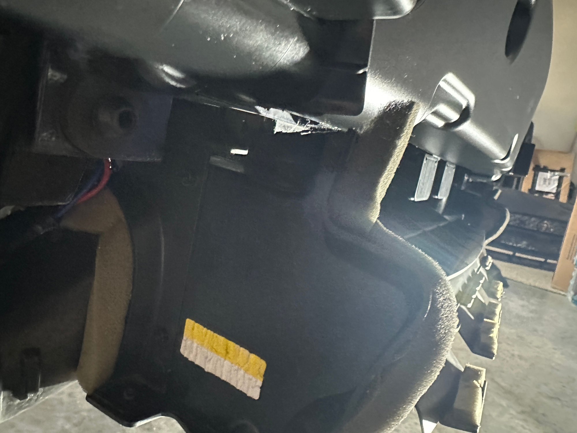

Cool Idea! Good info. I did not like all the mess showing back there either, so I used a piece of vinyl I had and wrapped it and did a pretty good job as well. You could use thin PVC wood trim piece and wrap or paint too? Here is how mine was done...Just another option.

Here is another random pic I found online, further back, that does a good job of showing how the plastic cover looks installed on the current generation F-Type. My order is in process. No idea when it will come or when I will have time to install, BUT I will post up when I can. Rock88 solution is probably a more economic one for sure.

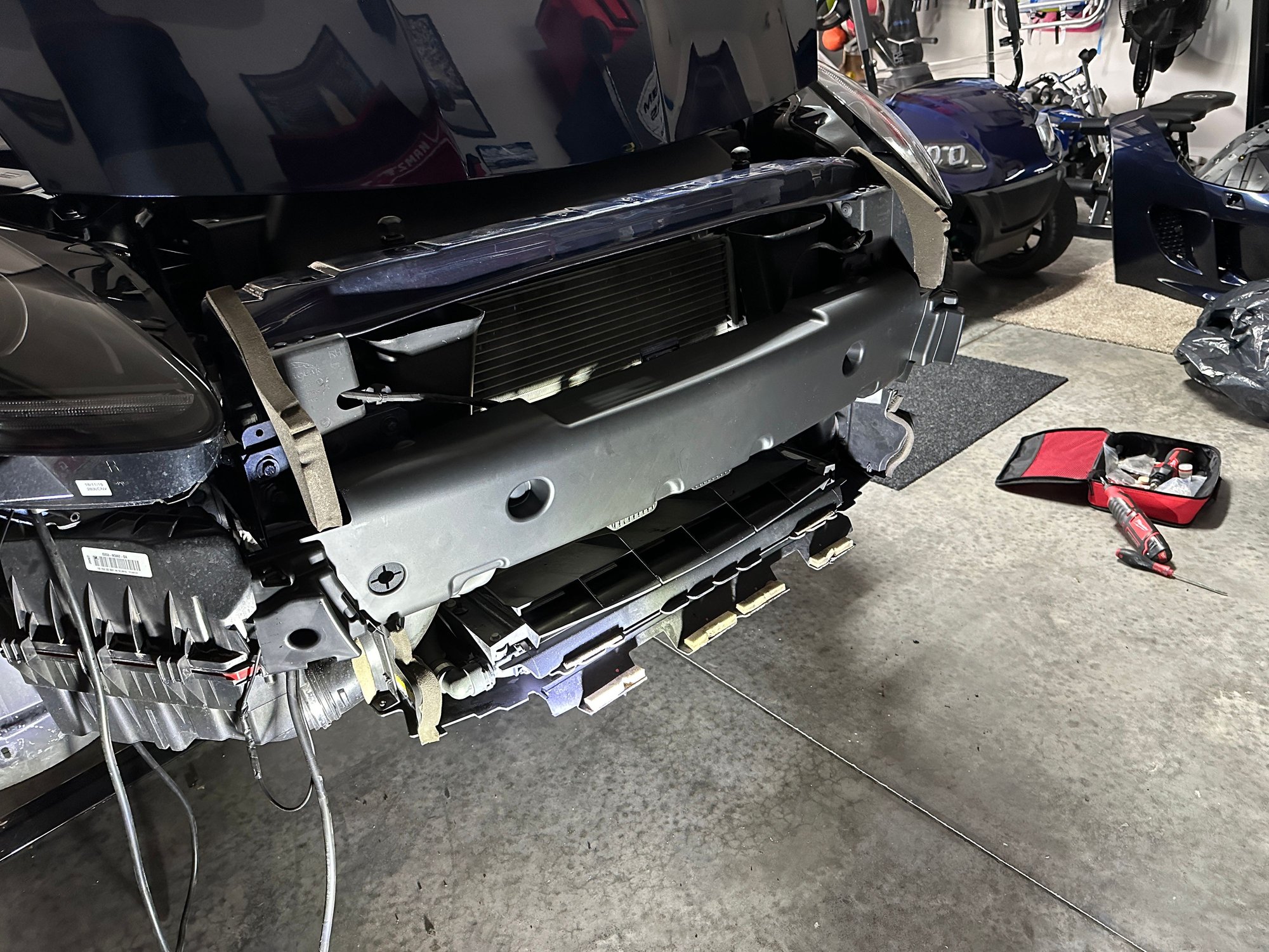

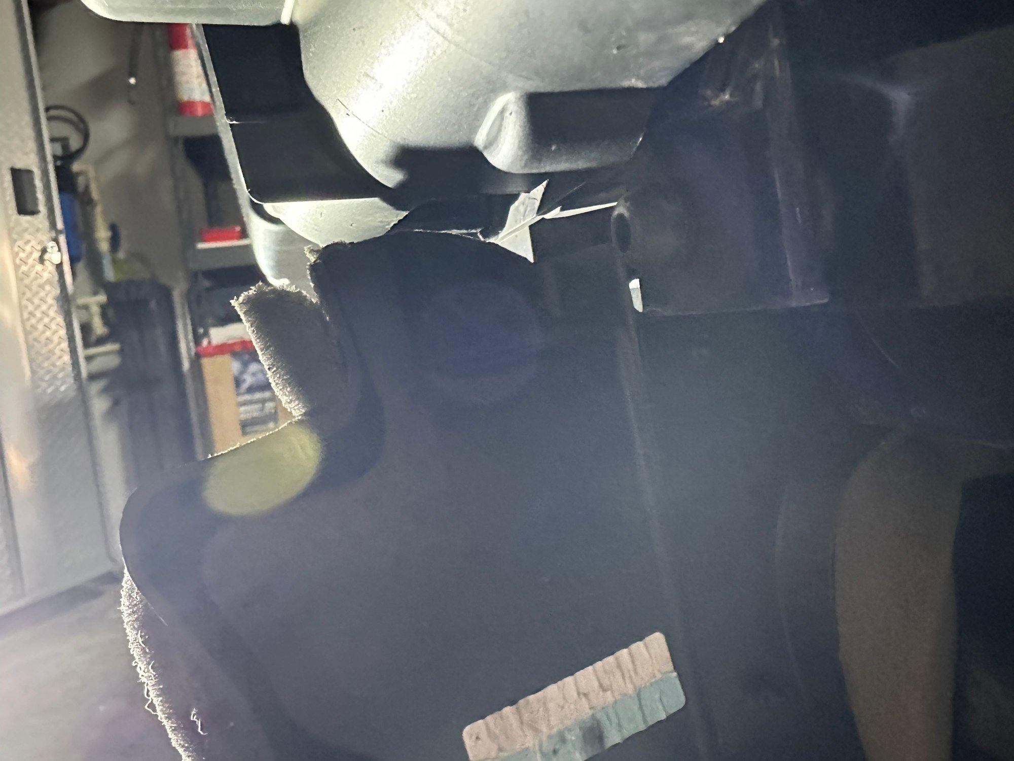

Cover came in. Waiting on grill surround to get painted so I can install. Here is a rough idea on how it will look.
Obviously will look way different once installed and all black behind the grill.

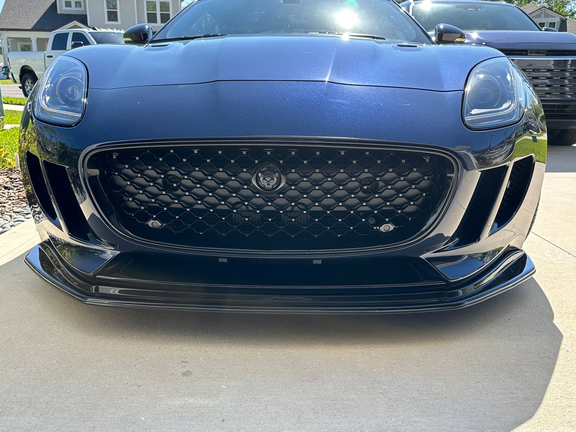

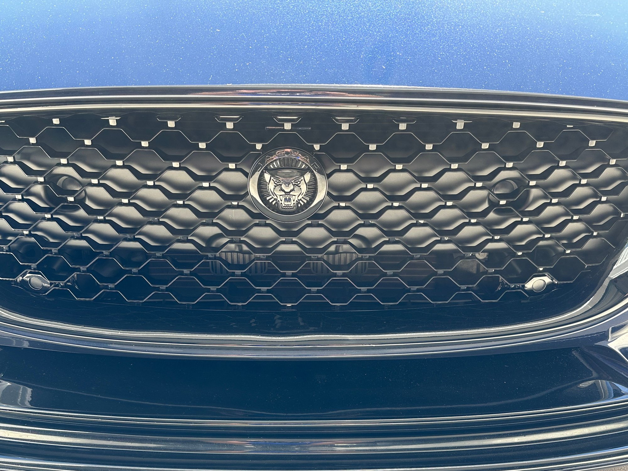

I have Vehicle Revolution P7 grill and I am not sure if this will fit... Anybody tried? It seems that the plastic is almost touching the grill, and I am not sure if the replica have the same pane as original... And parking sensors...

@J444G Sorry I never finished this thread. The 2021-2023 cover does in fact work with some modifications. I later learned they made a similar cover for the P7 that was a direct fit, but good luck trying to find one. I had to cut out the bumper reinforcements on both sides as the shape of the front bumper from the 21-23 is obviously different than the earlier MY. With that said, once those pieces were cut out, you cannot tell once the bumper cover was put back on. Here are some behind the scene and final pictures from last year I never uploaded.
