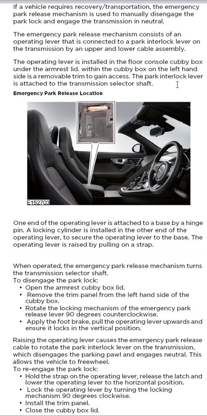

One more question - if totally dead is it possible to shift into neutral (automatic) to roll it out of the truck?
Yes you can release the parking lock of the gearbox from inside the car .
See document enclosed . A different problem might be the electrical
parking brake which only can be released if you have some battery power.
Regards
Ulrich
