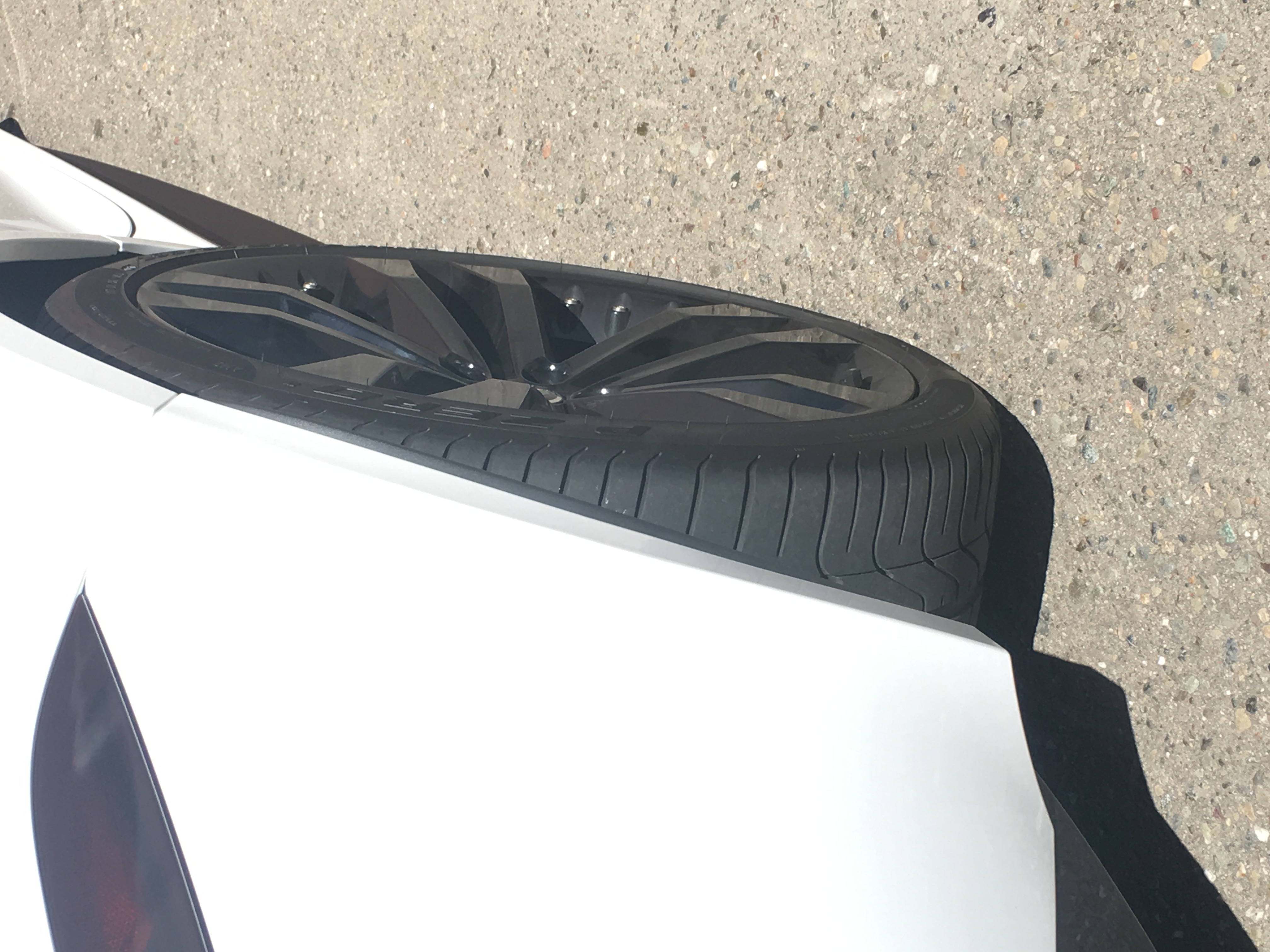

For a cheap mod that will make your car look 100% better get four of these 10mm spacers for your car...
10mm Fit Jaguar F Type s Type XF XFR XJ XK 5x108mm 63 4 Billet Wheel Spacers | eBay
Along with these lug nuts in black or silver to suit...
https://www.amazon.com/gp/product/B0...?ie=UTF8&psc=1
And the car will sit like a Ferrari with the wheels where they are supposed to be.
See for yourself. She squats far beefier now, looking like she can benchpress a ton. I know a lot of people are just terrified of wheel spacers. Know these are hub centric with the correct bore for Jag. With the ET style lugs with the thread extensions, with oem Jag wheels, I can safely assure you that theres no wobble, no rubbing, no safety issues. I am not familiar enough with our car to know the difference yet but physics tell us that we will have better handling and balance with the wider stance.
Downside now is I have to be 10mm more careful when parallel parking.
GO DUBS!!!!!

Can you take a picture of car from back looking down side profile?
Old Jun 13, 2016 | 07:37 PM
Looks good Polaris, but, here's the but.....
I see you've added flat plain spacers, that would be a major cause for concern for me, especially on such a high powered vehicle. Looks like you've basically removed te hub which means that the wheel sit on the bolts and ar not hubcentric leading to wobbly wheels and serious danger, I'd look into that if I were you.
Unhingd has shown the correct safe way to do this with his adapters / spacers, which are the exact same as the ones I used on my vehicle.

The rule of thumb known to all wheel people worth a damn is safe = 5 or more turns. 10MM spacers with the nuts I describe gave me 5.5 turns with the oem Toronado wheel. This is a fact. Thats why I posted this to let people know this particular set up works just fine. I'm not a novice when it comes to this and I know that doing this wrong can be very dangerous. Not only would I not drive the car in an unsafe fashion but I certainly wouldn't pass on the risk to others. I can only speak for what worked for me and what will work for others using the same variables that I used. Now there are many different wheels out there to consider with many different dimensions - so I'll say it again...
MAKE SURE THE LUGS TURN OVER 5 TIMES ON THE STUD WITH THE WHEELS YOU ARE USING.
USE ET OR EXTENDED THREAD LUG NUTS TO GET YOU THE EXTRA THREADING YOU LOSE WITH THE ADAPTER.
MAKE SURE THE LUG THREAD PASS THROUGH THE WHEEL HOLE OPENING SO YOU CAN GET THE 5+ TURNS.
DON'T ATTEMPT THIS WITH SPACERS OVER 10MM. ANYTHING OVER USE AN ADAPTER INSTEAD.
In my eye, 10mm is the perfect width. The fender flare edge lines up with the tire like Ferrari. Without seeing in person, I'm not convinced the wider the better but then again 5-10 more mm is only 3/16-3/8". All would look great but the method I used is by far the less complicated way to do this safely.
Not sure what you mean "I look like I removed my hub and are sitting on bolts and not hub centric".
On a different note...
Did you guys have to shave the oem studs down to not extend past the spacer? If not what happened to the length of the original stud?
