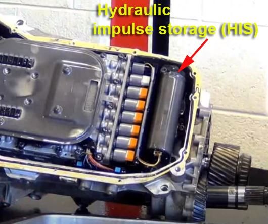

100% Ko-Rect! Since I was doing a ton of research, and looking to purchase and install a new one... thinking I had 'sploded my ZF or TC, I did verify that they have several versions of the ZF for different applications. Just for general info...
Our cars have the ZF8HP70 HIS (Hydraulic Impulse Storage - for the start/stop feature...It is a canister device for stored hydraulic pressure to quickly engage clutches on start-up) These are rated at 700N-m - 516 Lb-Ft Tq.

Picture of the HIS below - Stores the pressure to re-engage when foot is lifted from brake:
