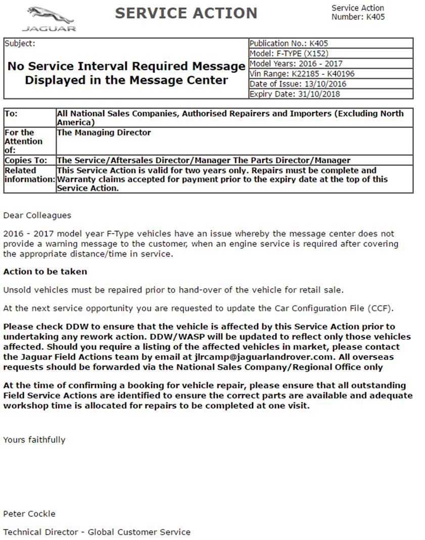

No big deal - fixes a problem where 16/17 MY cars don't report (on the dash) when they're due for a service.

K405 refers to a software update. Certain cars had a concern where the Service Interval Required message was not displaying correctly in the message center of the gauge cluster. K405 addresses that concern. Nothing to worry about.

Topix: https://topix.jaguar.jlrext.com/topix/vehicle/index
I was on there recently whilst investigating another issue, and noticed that my own car is due to have K405 applied next time it sees a dealer.
