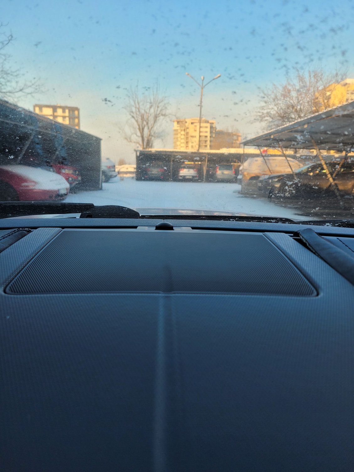

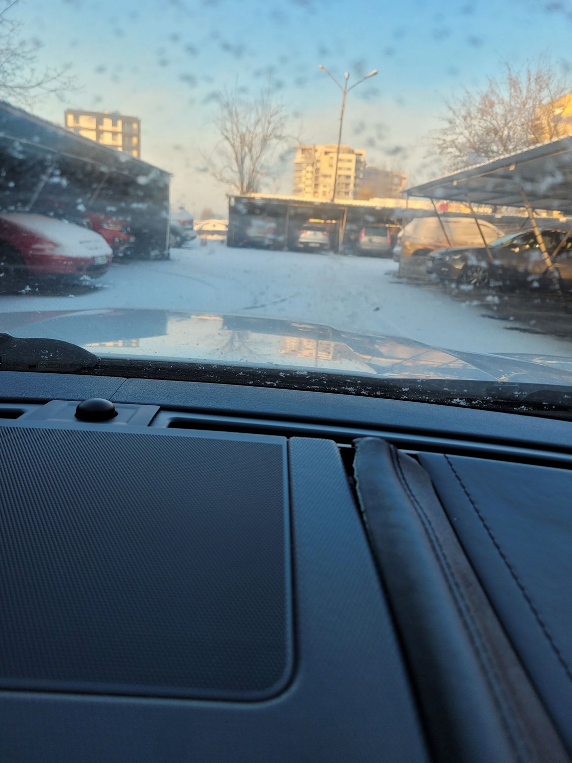

Hi, has anyone had a similar problem with the skin sticking out on the dashboard next to the ventilation panel? How to fix it? Please help <img src=" class="post_inline_image" loading="lazy" />

I've heard of 'wrinkling' on the leather instrument binnacle covering. <-Glad I have a Base model because of that
I would ask at a dealer first (who would undoubtedly want to replace that piece).
Get a second opinion from an automotive/marine upholstery shop.

My home remedy would be to mask off the leather and the edge of the center vent. Then use a small bladed screwdriver to apply weatherstrip glue to the bottom side of the leather and the surface it sits on. Wait for the glue to air out and become tack-free; then press the leather onto the mounting surface with a plastic scraper, squeegee or pry tool. Remove the masking tape and you're good to go. Hopefully, no glue has gotten onto any of the leather. Wax and grease remover will clean up the glue but it could discolor the leather. Good luck!

A popsicle stick or tongue depresser with a shaped tip ( to copy the screwdriver blade) might be safer than metal. +1 on masking the area. You may also want to test denatured alcohol to wipe the area clean. Any residue from past leather treatments may not allow the weatherstrip sealant to stick and cure.

Mine pulled up on the left side. The cause was that during the first COVID summer the car sat for three weeks during a heat wave, and I'd neglected to put up the sun shade. It baked the leading edge. The leather is hard and has shrunk.
In my case, I couldn't glue it without first rejuvenating and stretching it, and that's not going to happen in the car. I got a replacement from salvage yard but have not been motivated to pull apart the entire dash. I did discover that the factory got my order partially wrong. I have contrasting (white) stitching, but they missed that on the dash upper.

I think it's a mistake to assume there is only one failure cause. In my case, the leather was actually ruined by the sunlight and the heat that came with it. The forward six inches of the leather is hard and shrunken. It doesn't even fit the substrate anymore. My belief system has no say in that. I've measured temperatures of over 175F on the inside of the panoramic roof shade, and that was just during "regular" summer heat, not the exceptional heat we get at times.
If you have the extended leather package and suspect the leather is being damaged by the sun, try feeling the leather right under the windshield and comparing that with the feel at the back of the same piece. An oily leather conditioner may help the leather but accelerate failure of the glue, although that's speculation on my part. The sunny side of my steering wheel (normal parking position) is starting to feel a little dry, so I'll be treating that with the same stuff I've been using on my riding leathers and nice shoes.

She is protesting for getting her paws cold in the snow. But seriously, I think the adhesive they are using must be garbage, just had them replace my center AC vent and instrument cluster leather cover because the leather pulled away.

W zeszły weekend postanowiłem zabrać się za naprawę tego wystającego elementu. Zdemontowałem centralny nawiew, żeby mieć lepszy dostęp. Naciągnąłem skórę na tyle, na ile się dało i skleiłem ją klejem Patex. Na razie wygląda o wiele lepiej. Zobaczymy, jak długo to potrwa ;-)
Spoiler

Good job! please let us know if the problem returns. How is the leather at the base of the windshield holding up along the rest of the dash?
