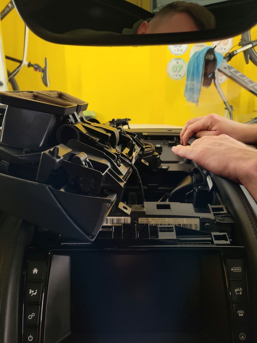

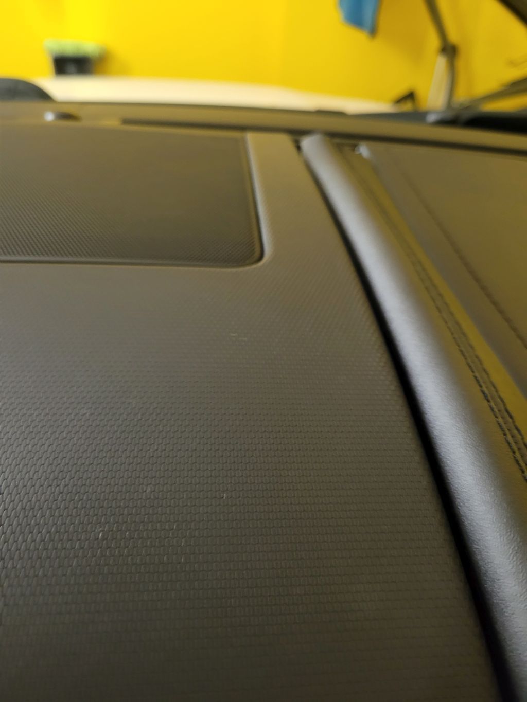

Originally Posted by dario_ldz
Last weekend, I decided to start repairing this protruding element. I removed the central air vent to have better access. I stretched the leather as much as possible and glued it with Patex glue. It looks much better at the moment. We'll see for how long ;-)

I used Pattex Universal Classic in a tube, spread it on the cockpit directly from the tube and then stretched and pressed the skin for about 10-15 minutes.
