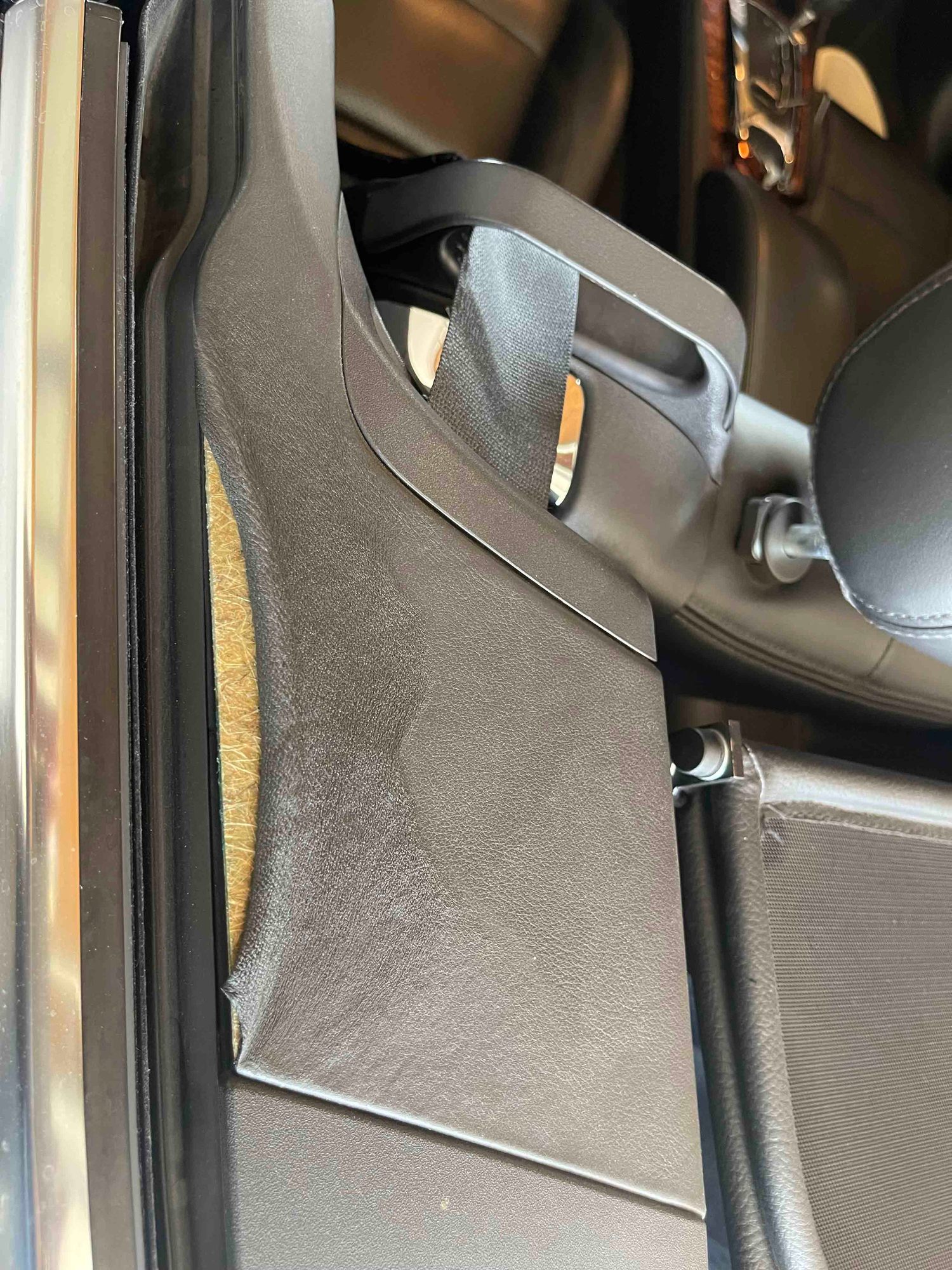

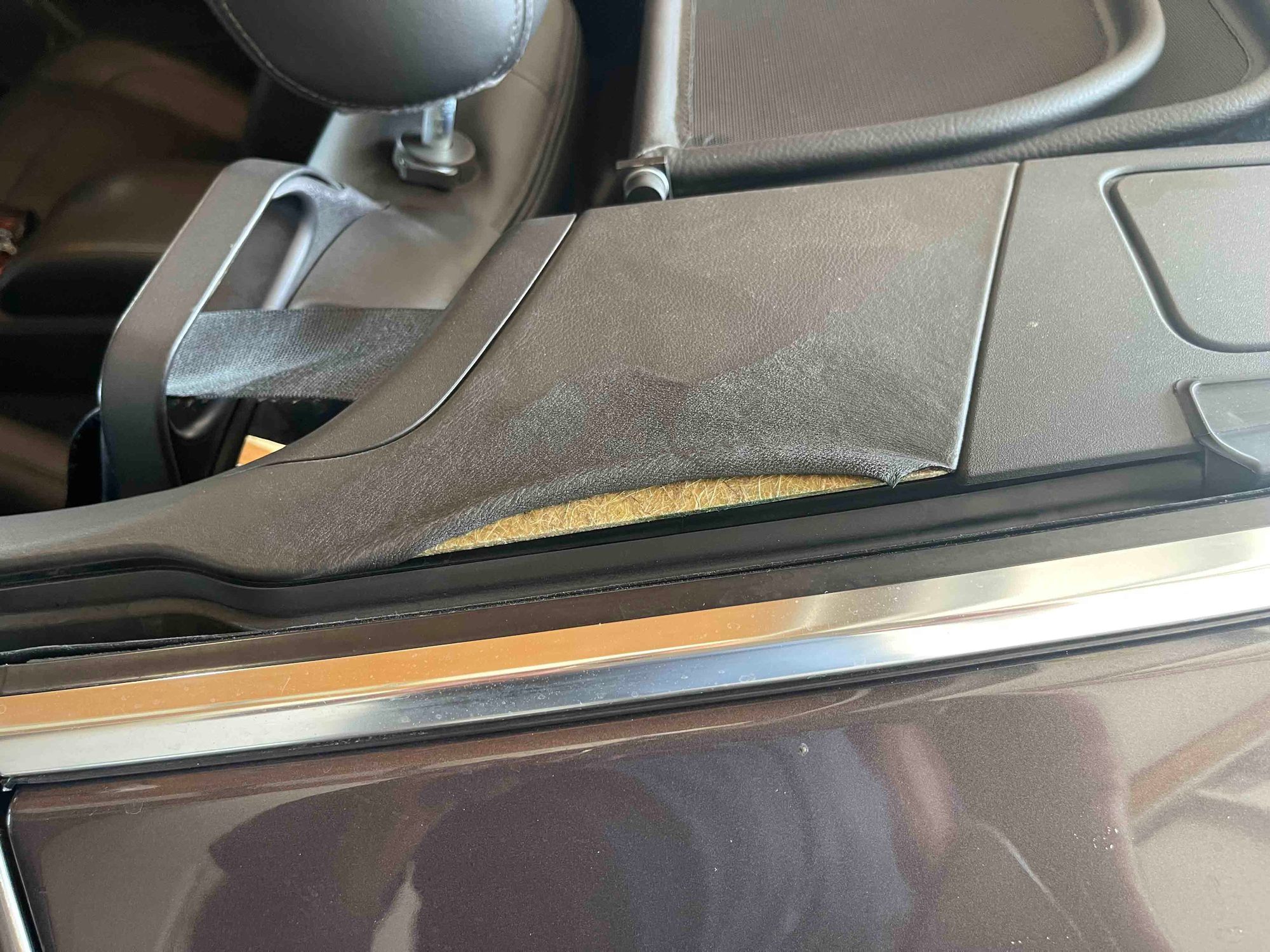

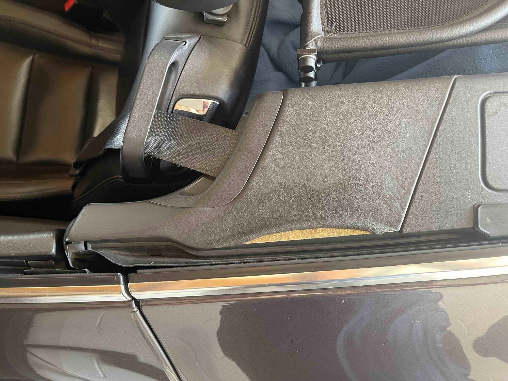

The first time I ever let the vert sit out overnight, we had a rain deluge... almost 2.5" in about an hour.
Had some water seepage at the base of the roof, and it ended up shrinking the leather panel.
Would it be stupid to soak the panel and try to stretch the leather back out?

The first thing to do is to liberally apply a GOOD non-silicone leather conditioner, and to do so liberally and repeatedly to soften the leather before any attempt is made to stretch it.

I have a lot of leather restoring and care experience… from antique cars to army boots to…
That job is beyond the simple “clean and restore” approach.
It will need to be heavily conditioned, stretched, while warmed… not hot! secured, dried, conditioned again, then polished.
take a look at product to get you started: Lexol Conditioner.
I don’t think you’ll need to use Melatonin leather stretch… I’d try with the conditioner first.
Then I use wood working clamps to hold in place once stretched.
Allow to dry, secure with leather glue. I got mine from a saddle shop. Clamp again until dry.
Then final conditioner coat.
Good luck.

Me, I'd probably get an upholsterer to cut off and add just the top flat part, have a seam where the corners are. If it's too obvious, do the other side to match. 99.9% of anyone would never notice.
