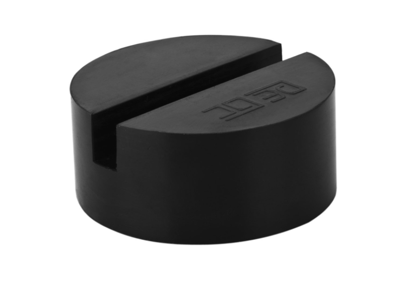

Do you guys think this jack pad would be helpful, or do I risk bending the pinch welds?

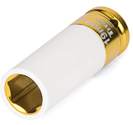

Also, would this 19mm non-marring lug nut socket do the trick for both my front/rear 20" Rotor wheels. Rears sit very deep. I just noticed I don't have 19mm, BMWs are 17mm.

The F-Type jacking points don't have pinch welds, they are all "flat" spots, so you don't need a puck.
And yes, the pictured socket will work perfectly, I have been using one of them for years.
