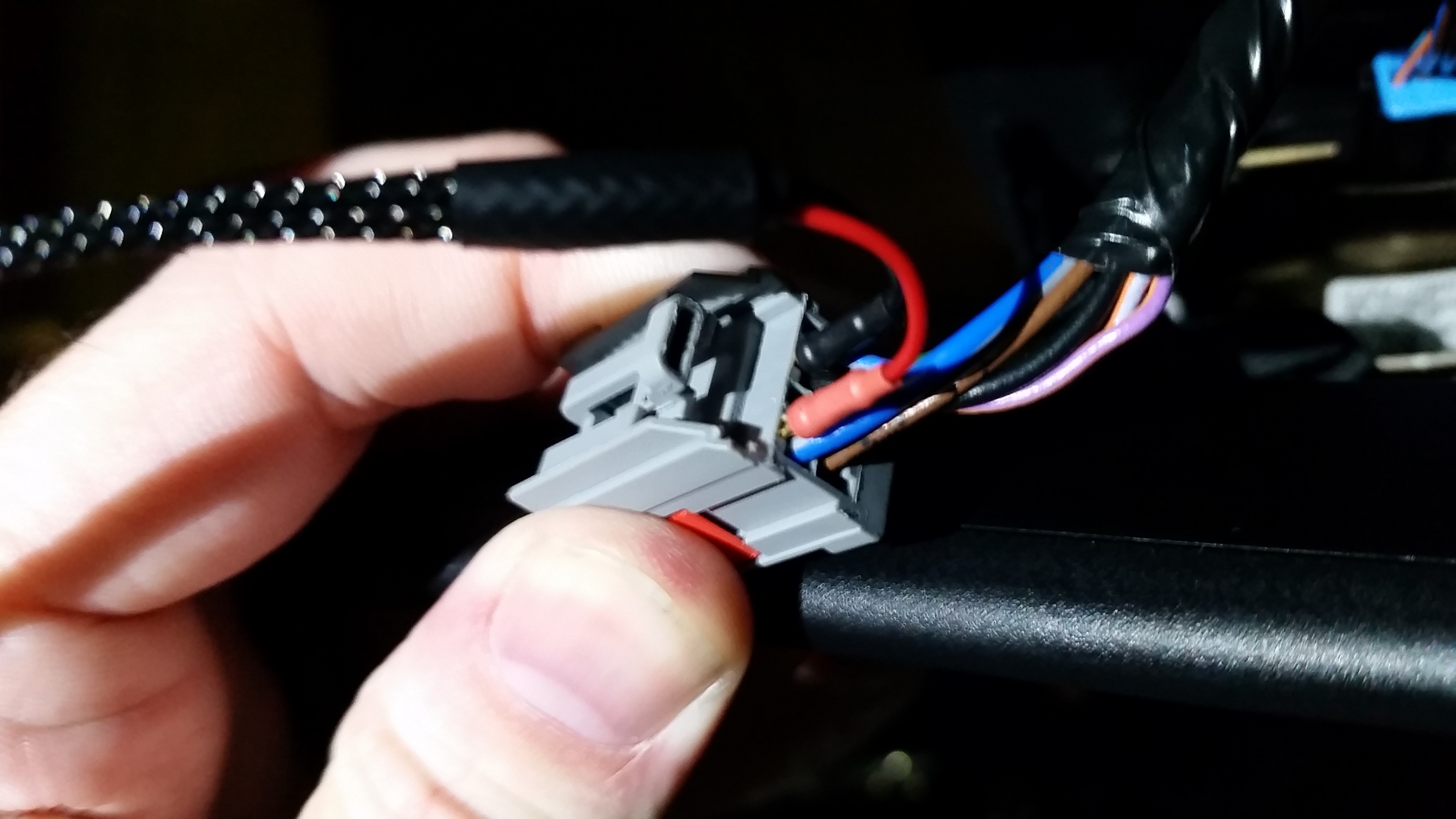

I was trying to figure out the best way to install my Escort 9500ix. In previous cars I was running the directwire smartcord which I would wire into the fusebox. Then I could run the cable up through the A-pillar and along the roof to the detector. Popping off panels on the F-Type are a bit more intimidating though. I can't even figure out how to remove the A-pillar. It is extremely tight and flush. Couldn't even slip in the cable through a crack. So instead I decided to try out the MirrorTap.
Ordered the MT-2009 (9" and .050" Tap)
Figured out which wire was switchable and tapped into that. Works like a charm, and looks clean. Detector turns on when the car is on, off when it is off. Only caveat is that the mute button is a bit tighter than before.
For reference these are the wires I plugged into.
Black was ground.
Blue/gray was power.

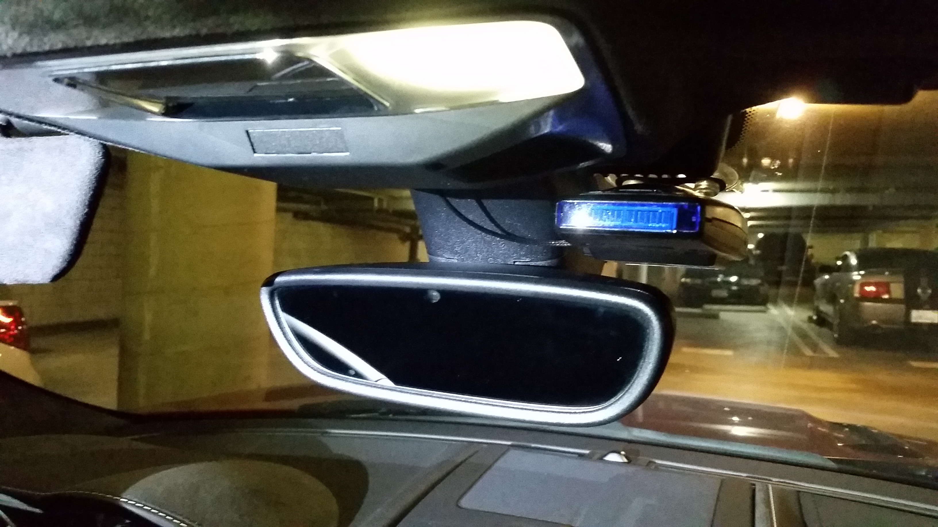

Finished look:

This looks like a clean installation and I have a couple of questions. I was wondering if the scratches on the windshield next to the dot matrix in the bottom picture is from you trying to open the mirror trim? If that is not how you access the wiring could you show how? I just received my Savvy and was wondering how to route the wiring up the A pillar arm and across the headliner. I have the ivory leather headliner and don't want to mark it up too badly. Thanks in advance.

Oh those aren't scratches, I just checked. Just odd dust patterns that wiped off with my thumb. The piece behind the mirror is extremely easy to come off. It is barely clipped on. Just pull out from the top and it comes right off. No fuss. It also has a nice cutout so you can run the cable right out.
As for coming up the A-pillar and across, that I don't know. Like I said in the other post, everything is so tight and secure. Plus the airbag in the A-pillar made me hesitant to start pulling without knowing what is actually back there and what is securing it. I'm sure it is possible, others here might know.

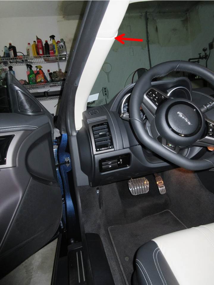

Schraderade- My intentions were to copy your installation and I ordered the savvy. I was concerned how to route the wiring where I have placed the red arrow. On my previous vehicle I removed the A pillar trim in order to cross over from the outside of the A pillar to the inside. I had a difficult time putting it back on. The airbag trim tab needs to be removed and was easily damaged. As you can see now I have an ivory A pillar and do not want to risk any marks on it. Thanks for your help.

I just pulled the cable across the seam to do the crossover, but used a griots tool to pry a gap ahead of the cable as I worked it across as
I also have white trim on the A pillar.
The set of tools I used are:
http://www.griotsgarage.com/product/eight+piece+trim+panel+removal+tools+with+hammer.d o
