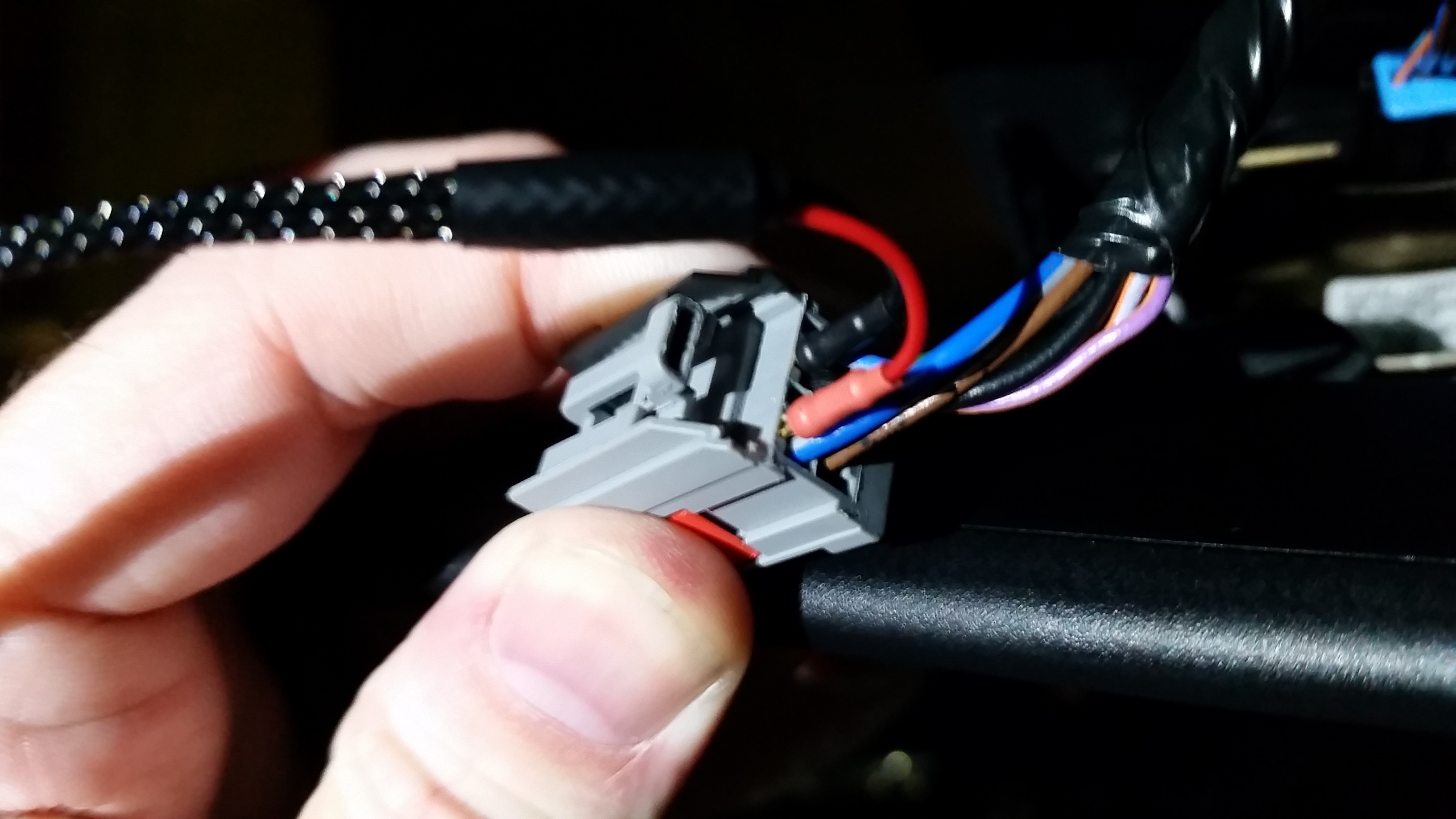

I finally got around to wiring mine up. I duplicated the conductors you used in the photos after testing. Same, same with my 2016.

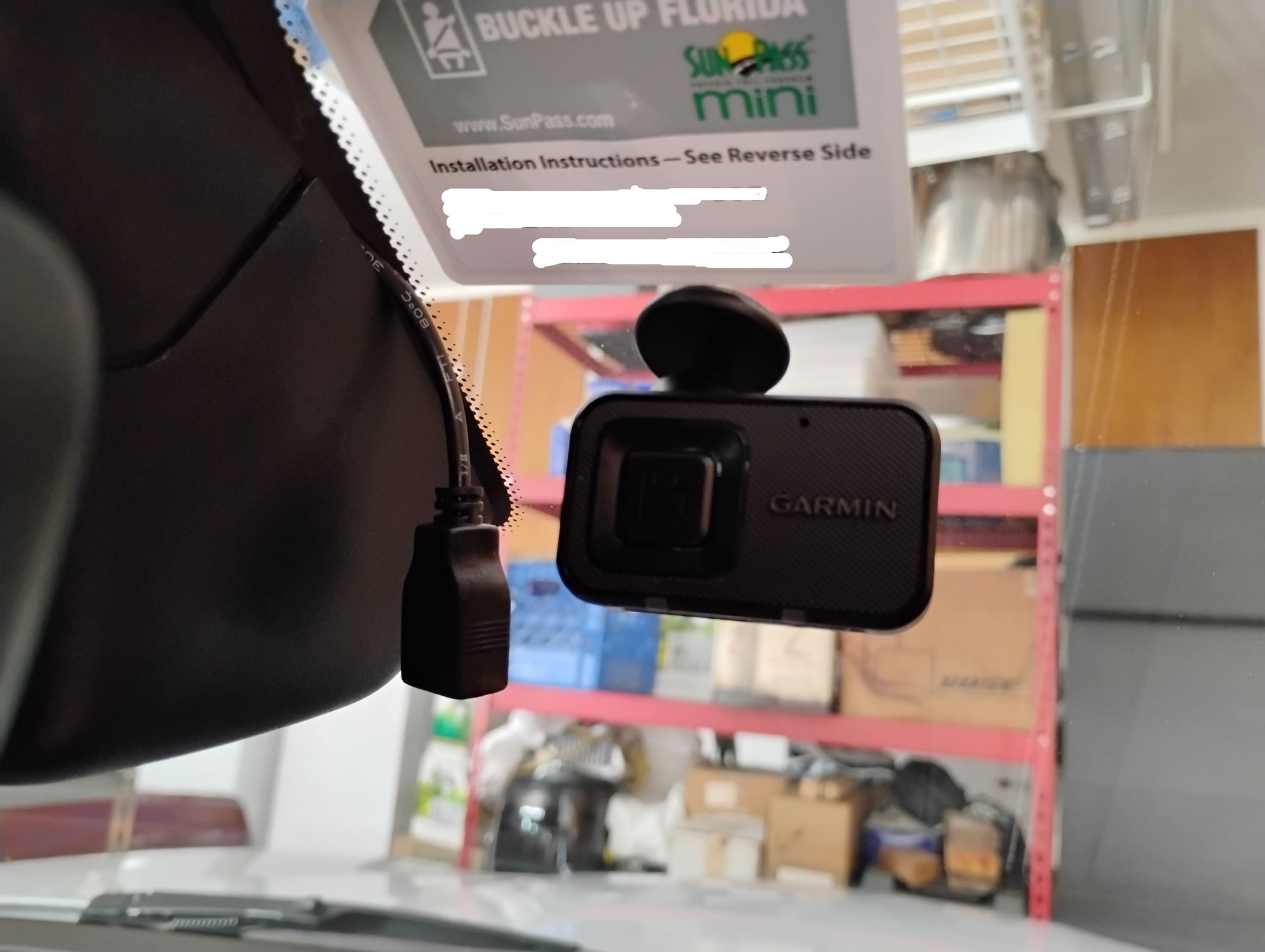

I use a Garmin mini cam as well as an Escort Max radar detector. I bought 3 things:
an inline small 5A fuse holder

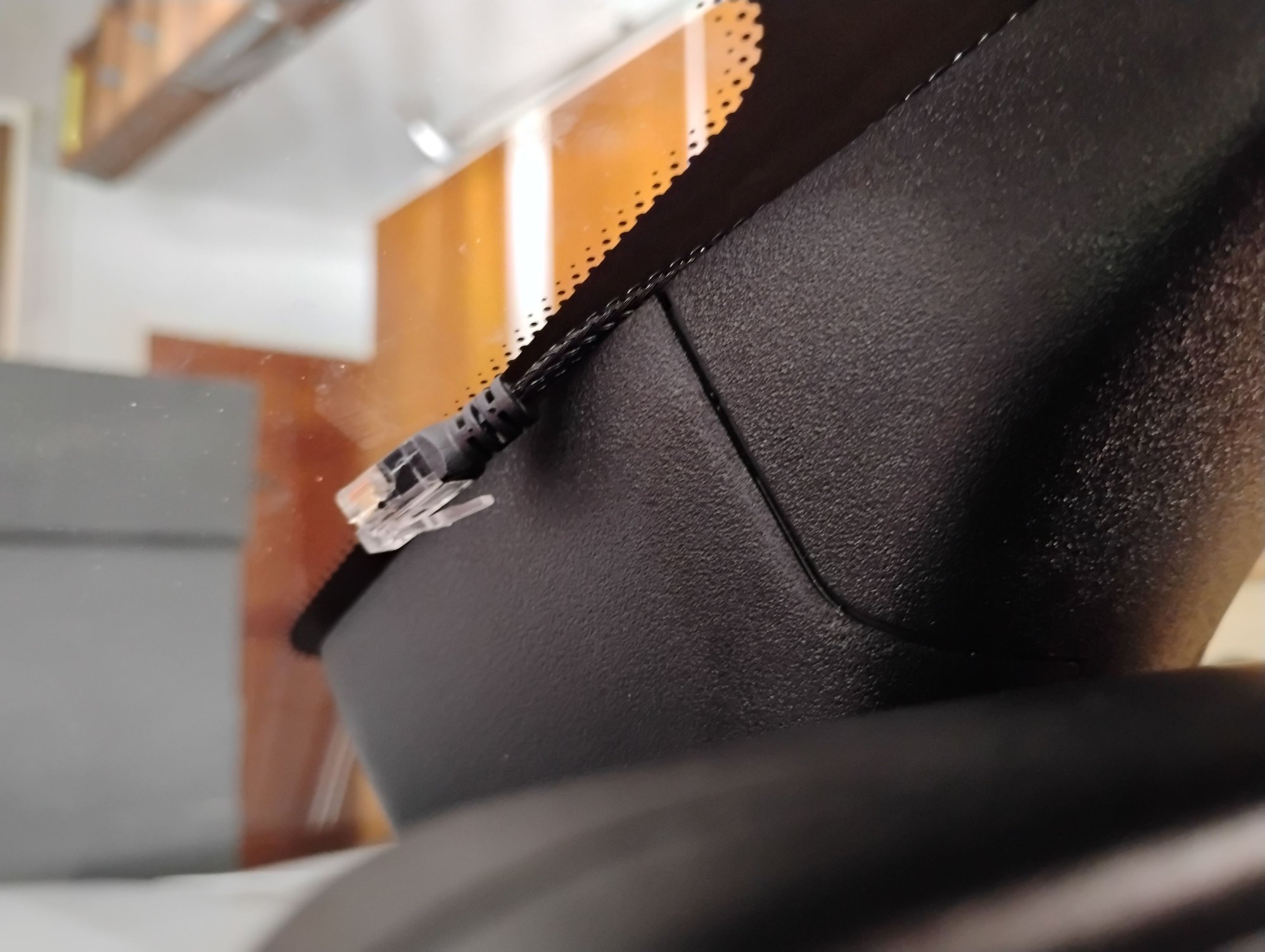

an RJ45 pigtail with the male RJ45 and two conductors (+/- 12V) (for the Escort).
a voltage step down regulator with a USB A female connector output
I first verified with Escort that they are 12V at the unit (they are), used small wiring pins to which I soldered some wiring and connected first the fuse then the other two loads to the same two conductors. I then tested to make sure my RJ45 pigtail is the same pins on the RJ45 connector as the output from the factory Escort 12V RJ45 plug (they were). All tested fine, both devices work great. I then soldered the common joints and used heat shrink tubing to protect. I inserted the pins into the factory wiring connector. The ground slot in the car connector was a bit sloppy, so I just bent that pin slightly; it's now well landed in the factory connector. I used double sided tape to stick my USB voltage drop down against the glass side above the other connector; coiled all wires, zip tied and put in place. There's plenty of room up there; the plastic cover snapped back on with no issues.
I'm waiting on the adapter to come in to take the USB A to USB C for the mini cam.
THANK YOU!
Finished photos:
Escort RJ45
Escort RJ45
USB for dash cam
USB for dash cam
