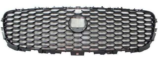

I looked up all the part numbers for the grill and not finding what I was expecting J9C7248.However I found lots of options for JA1200107 J9C7247. Will this work? No parking sensors or camera on my car so wondering if that is the difference in part numbers, or if there is something else?

@Zen Beer I bought mine (non-camera) on Amazon for like $90, and it's excellent quality. For the camera version there is a small cut out at the top center for the camera. I doubt you would even see it because it is mostly covered by the surround (and it's dark up there anyway).
After doing the project I would happily get the camera version and work with it. I also installed a LED down light for the growler badge at that spot so actually the camera version would have been better in my case. You can get these for ~$100 if you search around.

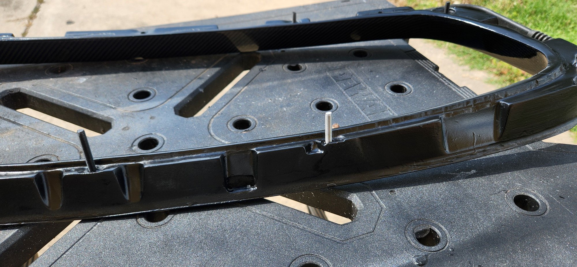

I ended up going with J9C7247 which has the cutout for the camera as I could not find the other version. These are getting rare too. FYI a 21 and up grill from an F pace will technically fit, but the diamond design is different and doesn't match with the side grills. Also top tip use studs in the grill surround instead of bolts as it makes it really easy to measure, cut and attach.
