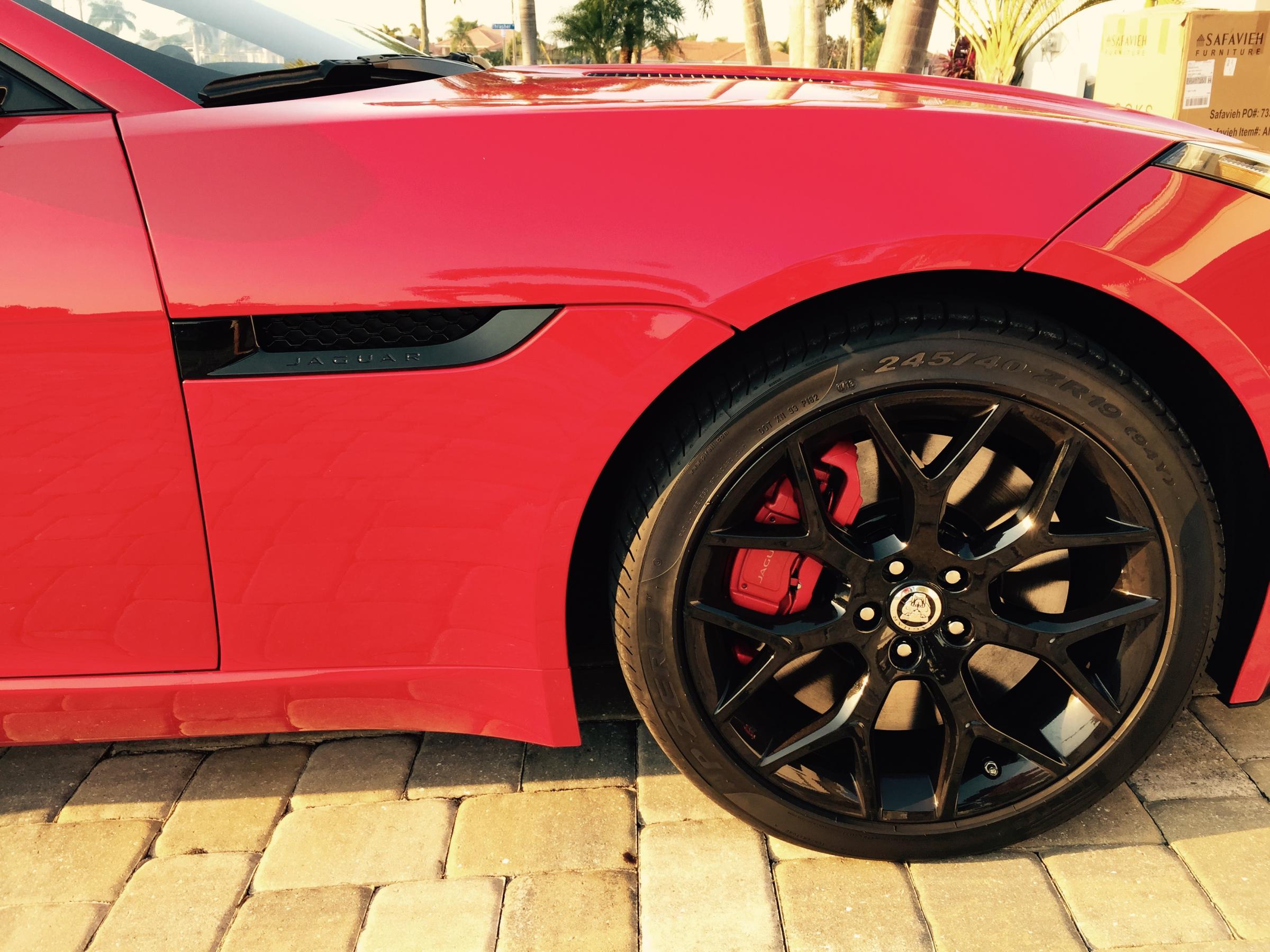

The installed vents look great with the black wheels on the red. The interior is red/black extended leather w/red seat belts. Actually contrasts well with the Salsa red paint.

Looks great! Much better than the chrome with those black wheels. I like the black growler center caps. I have been thinking about switching out my red ones. The hood vents are very easy to switch out too if you want the gloss black R style instead of the flush vent.

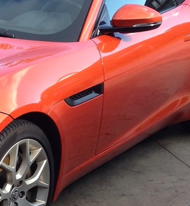

I use black vinyl wrap the chrome. No need to remove the vents and cheap. Materials cost me nothing sure you can buy it online for $5 maybe. You don't need a lot anyway. Spend 10 minutes use hair dryer and sharp utility knife to finish the job. I showed it to my wife she just couldn't believe it.
