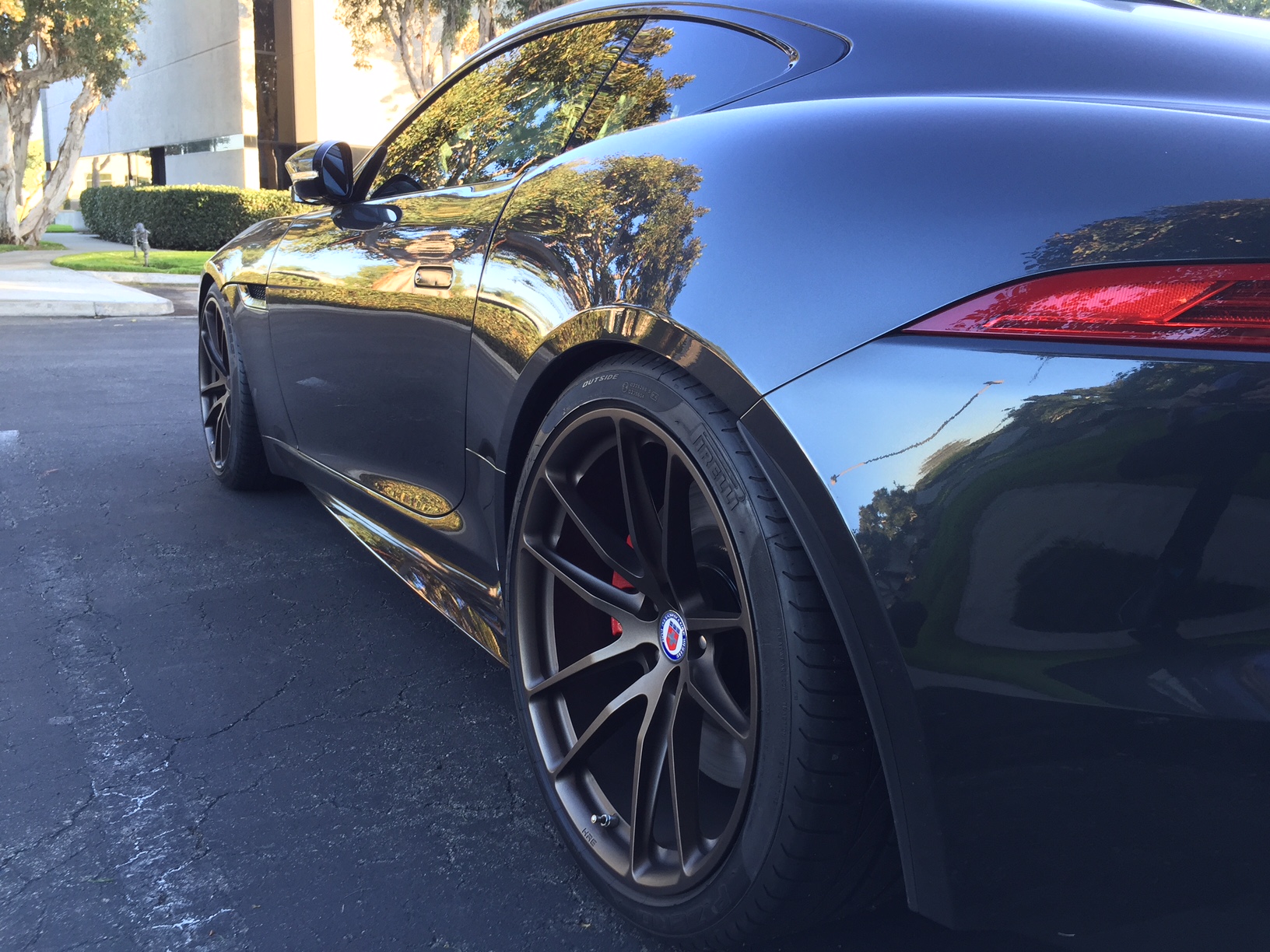

Originally Posted by Foosh
You did everything right.
An alignment is always necessary after any suspension height change from OEM, which changes the suspension geometry. Some don't do it, but that will likely cause uneven tire wear and possibly compromise handling to some extent.
Yes, the the OEM tire sizes are definitely within approved specs for the extra half inch on your HREs, but many have talked about going to 305s on the rear. I was just wondering if you went that direction. However, 10mm of extra tire width results in a pretty minimal increase in the contact patch.
We did try a 305 on the rear. There was not enough room to accommodate with these offsets. If we moved the rear in a bit, the 305 would have been fine.
Much of what you indicate above is clearly evident in this one photo.
The side wall of your tires are "stretched" ever so slightly in an outward direction to properly seat to the wider rim.
The same OEM tire on the OEM 10.5" rims bubbles out ever so slightly from the face of the rim, as the seal edge on the tire is forced inward a small measure to fit the narrower OEM rim.
If I were to place a straight edge across the entire face of the OEM wheel/tire assembly, that straight edge would contact the rubber, and the rim would be inset slightly. If one were to place a straight edge across Sandman's set-up, it appears it would contact the face of the rim first, as the tire tapers away.
Both work, and are well within spec. As I explained in another thread recently, installing the OEM PZeros on an 11" rim expands the contact patch with the road by approximately 2/10 of an inch. This setup does however potentially expose the HRE rims to more curb rash if one is not careful.
