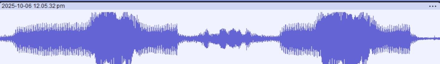

In the sound file the car (P450, 200 cell Cats) goes between idle and 2000 RPM 3 times (car stationary in neutral). First and last are with the exhaust button lit
MP3 Attached
Sound file attached
The microphone was placed next to the speaker behind passenger seat (the sound is mostly coming from the rear speakers and the larger door speakers).

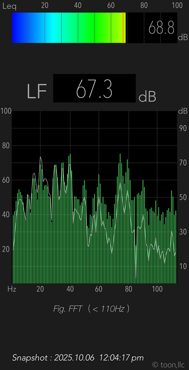

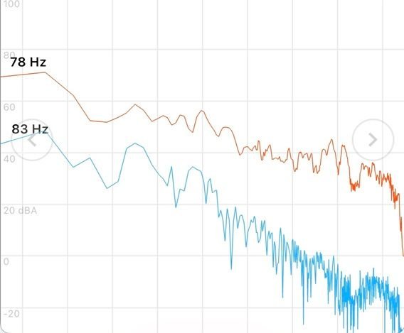

Just out of interest there is the audio spectrum.
The red line is peak hold with button lit. The blue real time with button unlit both with car in idle. While there is volume increase across the frequencies the most energy is lower down to the point where is getting inaudible. Just to see what's happening at lower frequencies that are more felt than heard here are a couple of low frequency FFTs.
Exhaust button unlit
Exhaust button lit
A big 17dB increase in pressing the button. However the similarity in spectrum makes me think the system is also adding sound all the time.
