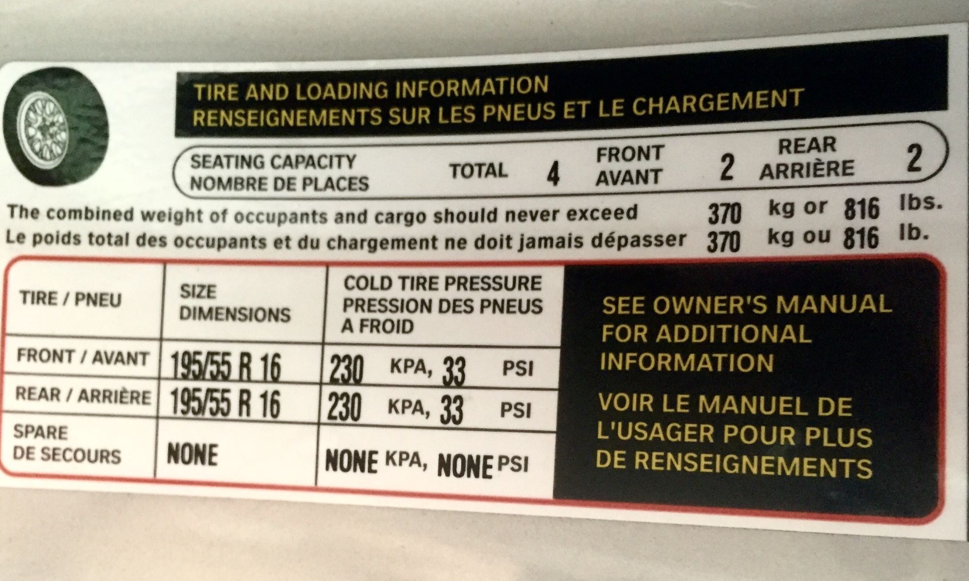

So I looked at my wife's Mini Cooper S and that tiny car has almost double at 816 lbs.

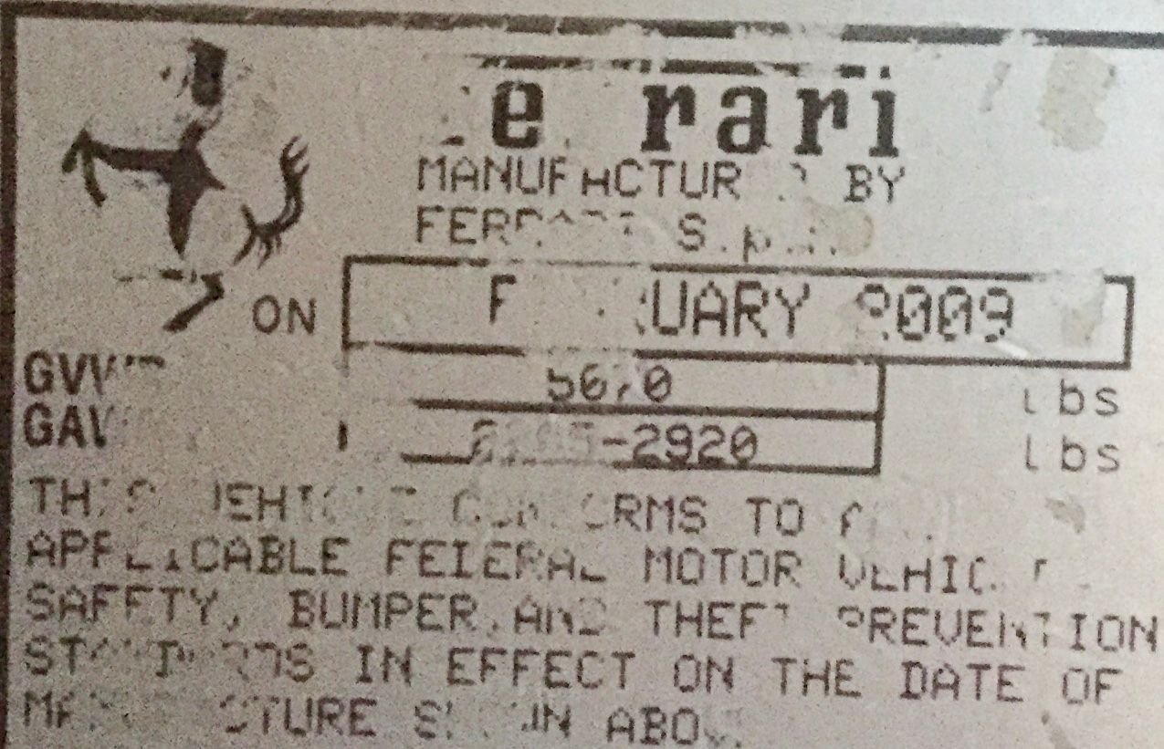

Then I call my brother who owns a Ferrari to see if this is some kind of "sports car" thing. It isn't. His Ferrari's rating is 2150 lbs (5070-2920). Granted, that's a 4-seater with a V-12 engine, but FIVE TIMES higher!

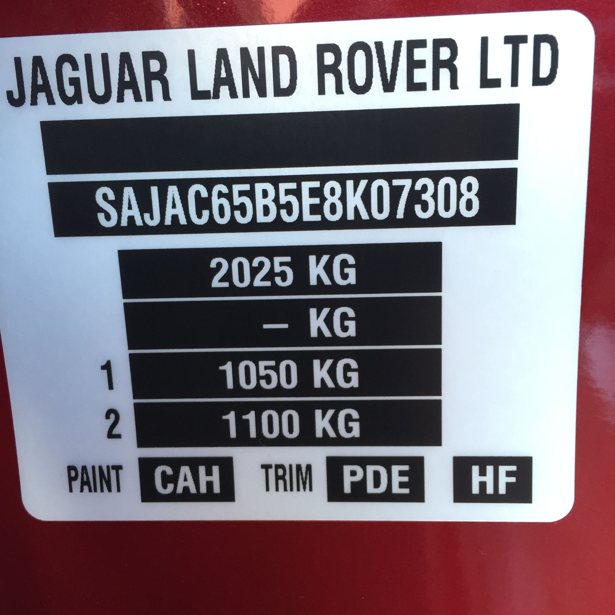

Wait - what? Same car, massively different weight limits??
Door label pic please...
Old Mar 11, 2016 | 10:18 PM
AnD3rew's Avatar
Joined: Jan 2013
Posts: 953
Likes: 173
From: Sydney Australia
I got those numbers from the website for the current V6S. Mine is a 2014 here is the door label but it is a little
less clear. But still seems generally in line with what I posted.

Yep, the document you posted pretty much agrees with the door placard I posted for my car. Mine is a little older. But roughly 1000lbs tare give or take a few lbs.
