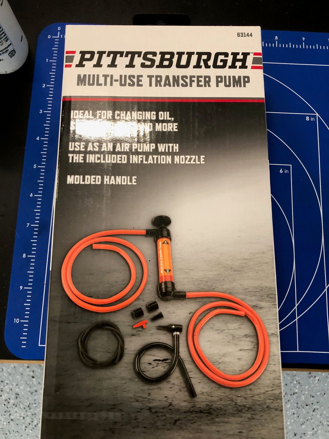

I know you're asking about an electric pump.
In the 4 oil changes I've done now on this platform I've used this hand pump from Harbor Freight. It has the oil completely out in 5 minutes (or less). The pump is so cheap ($7.99) I buy 3 at a time. When I'm done suctioning out the oil I throw the pump away. Not that it's bad, just so cheap not worth leaving it around and just use another new one. This pump works on a whole bunch of stuff not just oil.

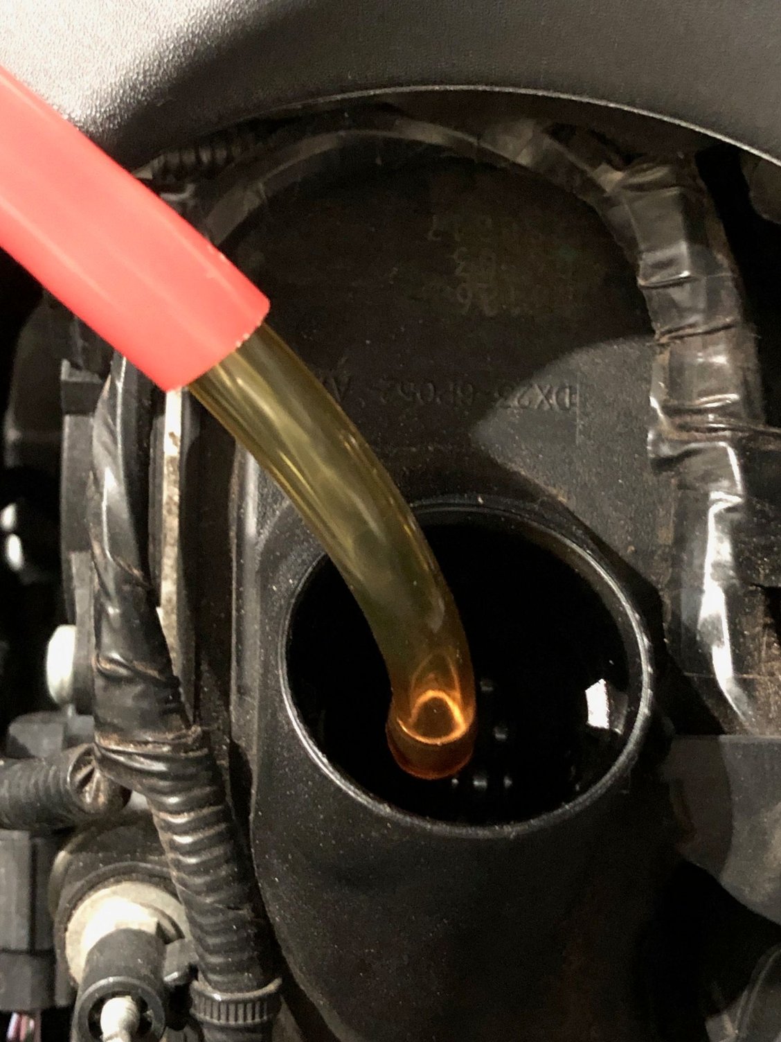

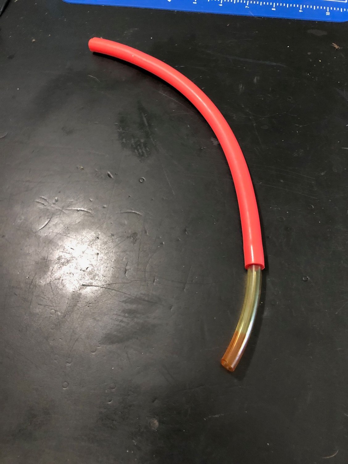

I should add to the above:
The orange hose in the HF kit is too large in dia, so I use a small piece of smaller dia tubing that fits tightly inside the orange tube and tightly onto the oil suction tube on the engine. This little chunk of tubing is the only thing I do not throw away with the pump and has been used 4 times now.

The small hose is 3/8" OD / 1/4" ID.
I believe I had a whole coil of it from HD for some other project...irrigation I think. For $7.99, try it before you go to some more serious expense. Report back here if it doesn't do the job as fast as I said.
I do not warm up the oil before I drain it. It doesn't have to be cold, but not good to run the engine shut it off then begin pumping out the oil. Oil will circulate and sit in places in the engine for a long time after shutdown. I'd rather have as much oil in the pan to suck out as possible and not sitting in places in the engine where it will not drain for a while. Just me...other opinions will vary.

Yes, I agree with you here. Tight fit is necessary to extract oil quickly/efficiently.
The extraction tube mics out at .310" or about 7.8MM. The plastic tube I use with 1/4" ID (.250) fits on very tightly. In fact I only need it on about 3/8 to 1/2 inch and it is tight enough that it will not come off. A little oil on the tube works and this setup is still tight.
