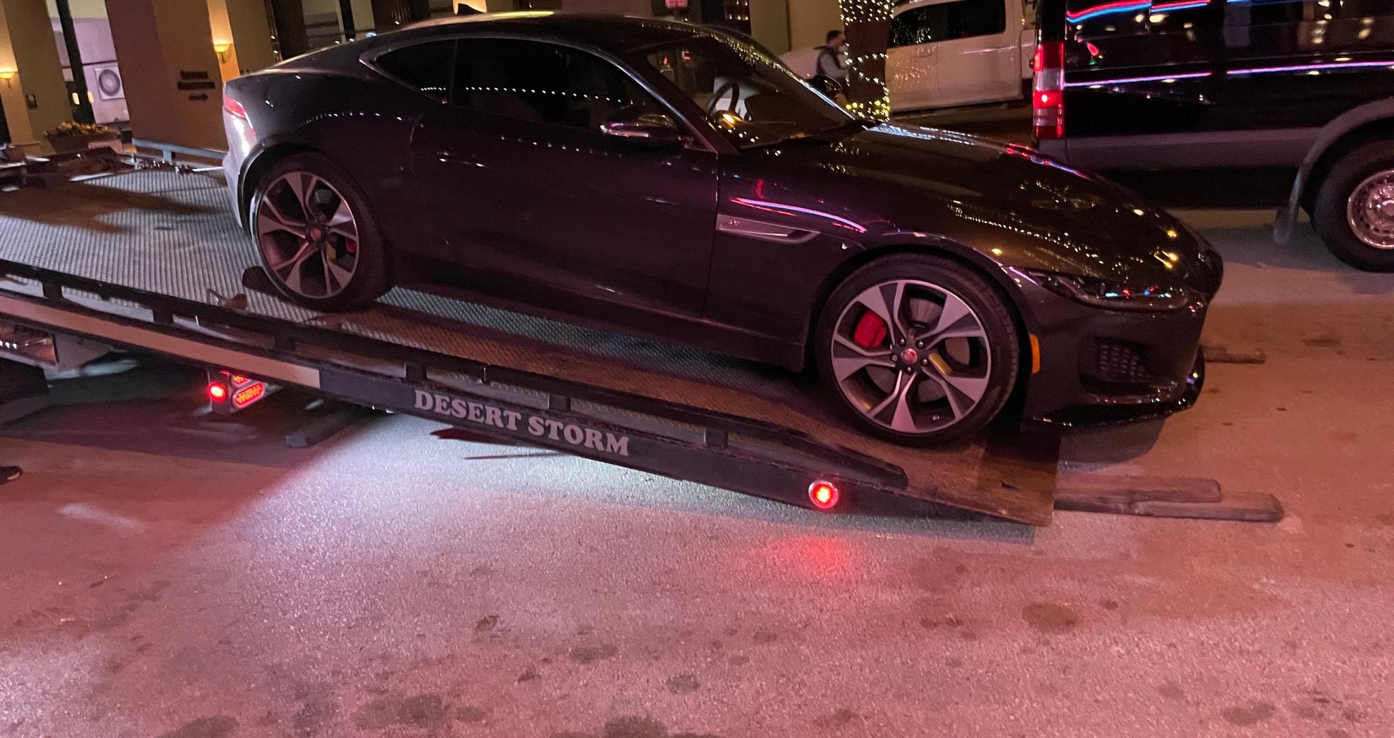

I met up with my wife in Fort Worth this week—she had a meeting in town and so we decided to make the most of things to look at some property. Afterwords went to dinner in her F-Type. We drove just a couple of blocks and stopped on a red at Main and 2nd—the engine stopped as usual, but then ALL power was completely lost. No lights no nothing. For the next hour, utter embarrassment ensued. While waiting for the tow truck, a waiter from the bar next to us (Ricky’s BBQ) even came out and offered free drinks while we waited. It was one of those times when you just want to crawl into a hole. Anyway, long story short, the car was taken back to Dallas dealership and fixed in about 10 minutes. It was a loose terminal connector on the battery. The car has only done about 1000 miles.
I’m not posting this to complain about Jaguar reliability. My wife and I have complete faith in JLR cars having driven close to 500,000 combined miles in their cars over the last 9 years we have travelled. I just thought (after the fact) that the whole thing was quite amusing.
A couple of thoughts about the whole episode:
1. My wife was relieved that I was with her at the time—not because she would have felt unsafe alone, rather I could not blame her for doing something stupid to cause the breakdown had I not been there. I would never do that!
2. Are the batteries installed by the dealer or at the factory?
3. it’s amazing the simplest of things can disable a car like that.
4. If it wasn’t for that stupid auto start/stop feature that Californian’s think is a good idea, we would not have suffered the indignity of breaking down in downtown Fort Worth in front of a million onlookers! Instead the car would have at least carried on until we parked the car.
5. Props to the waiter from Ricky’s that offered us drinks. (We asked for bottled water by the way).
6. Here is a photo of our beloved being loaded on to the trailer:
