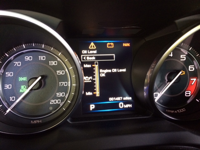

I had a first oil change on my V8S yesterday. The tech who did it spoke very little English but could manage a friendly "nice car" when he pulled it round for pickup. I should have checked the oil before I drove off.
Today, I had the car warmed up and parked long enough to do the dashboard check. It was filled to the maximum.
I stopped in at a different dealer today to see if they could drain a pint or so. I was assured that the car has an overfill warning.
My question is - does it? If not, how bad is it to leave it filled to the top line?

The "Max" line is appropriate for a oil change. The Owner's Handbook for F-Type (the one that came with my R Coupe) states an "Engine Oil Level Overfilled" message will display (as will an "Underfilled" condition too) if the oil level is too high (or too low).
I took great pains to change out my oil the first time myself for various reasons, e.g., calibrating the display in my mind with the actual oil level, learning how to extract rather than drain, etc. My point is that I was able to ensure I sufficiently drained out the oil and added the right amount of oil. After the change, my oil level hit the "Max" line as did yours once the appropriate amount of oil was added (7.6 Qts for the R). Doesn't appear you are overfilled.
Here's how my display appeared after the changeout. The first pic shows the display after adding 7.0 qts--I wanted to see how the display reacted to being down 1/2 qt. The second pic shows the oil level after adding an additional .6 Qt to reach the factory-specified fill of 7.6 Qts w/filter.
Overfill warning for oil on 5.0?-jaguar-oil-sensor-reading-after-oil-change-7.0-qts-07-21-2014-.jpeg
Overfill warning for oil on 5.0?-jaguar-oil-sensor-reading-after-oil-change-7.6-qts-07-21-2014-.jpeg

That was a very enlightening experiment, Delta. Thanks! It's good to know what the different line levels represent.

Thanks for the detailed info. My invoice says 8 quarts so at worst, if they sucked out all the oil, it is over by .4 quarts. I can live with it but probably will use the oil extractor to suck out a few ounces. Would have been much happier if it was showing one line from full. I wonder how overfilled it has to be to get the overfill warning.

So I went ahead and sucked out the extra oil. It was filthy black and I had to remove almost three quarts of it to get the oil level line to drop to one hash mark below maximum.
Either they left three quarts in the car before adding in eight quarts, or they just added some fresh oil to my existing old oil. Either way, I will need to change it again.
Still looking for a reliable dealer in the Seattle area. Bellevue Jaguar is off my list.
On my car at least the car can have about three quarts too much oil in it without triggering the overfill warning.
I would attach pics but I don't know how yet.

This is how much oil I had to suck out of the fill hole to get the dash readout to drop one hash mark from maximum. Fortunately I drove less than 150 miles with this left in there. I believe the oil changer holds at least 16 quarts as I use it on my boat twice without needing to drain it.

I still have questions about the sensor levels as well. When I added new oil, ran to operating temp and measured the level, I reached one mark below the "Max" level with .6 of a quart kept out. On my next change-out, I'm going to do a better job at calibrating those eight markings between the "Min" and "Max" levels. (FWIW, I marked up old 1-gallon oil containers in 1/2 Qt increments just for these sorts of calibration "challenges.")
In your situation, Nookieman, while your last pic shows the oil you drained to reach one mark below "Max," I can't really tell how much oil is in the container--it doesn't appear to have any graduations. Did you or can you still measure that level as shown in the pic? I'm guessing no more than two quarts based on the size of the container. Though it would have represented more work on your part, it would have been interesting to extract a quart at a time. But, I realize that that would be tricky since extraction is hard to stop on a dime.
